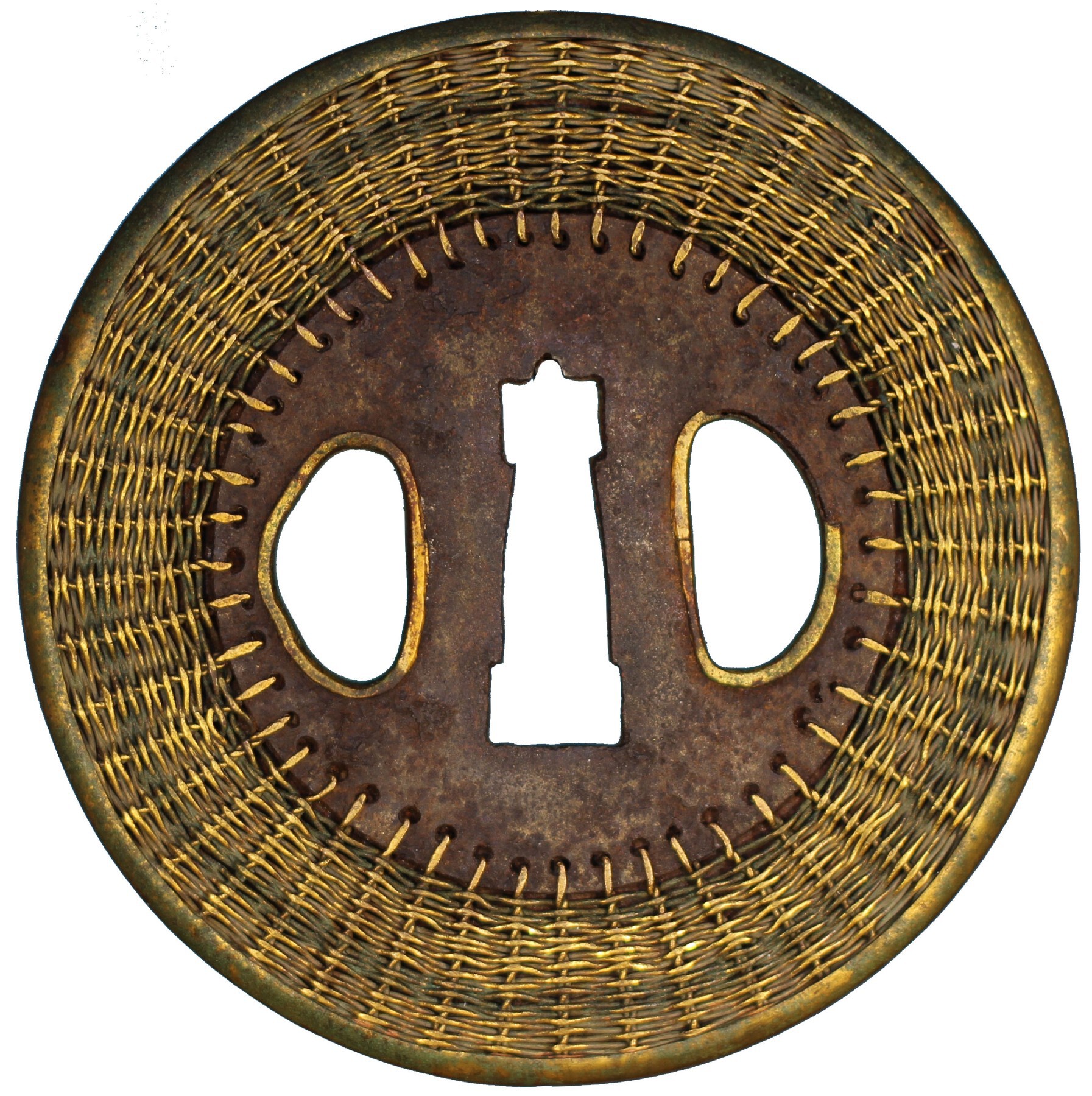

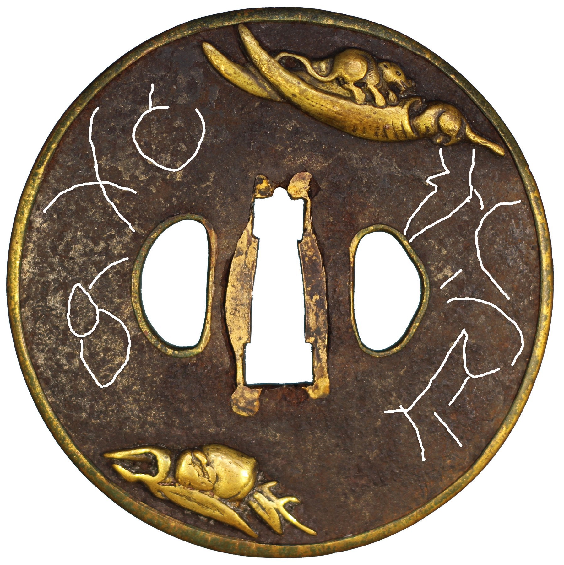

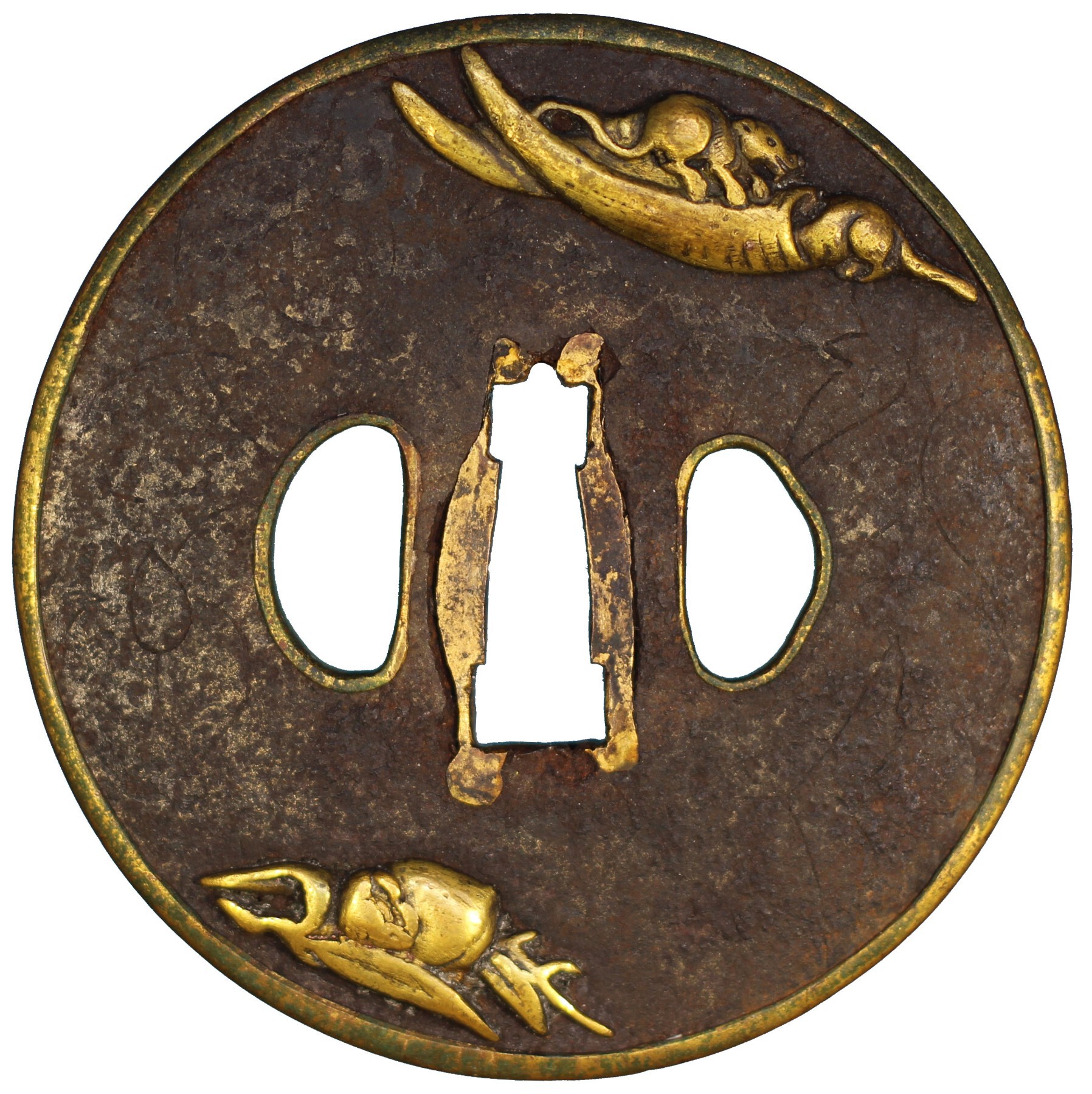

Grev @kissakai your piece is really interesting and unusual say the least, the internal iron core is visible but not the brass wires on the engrqved side. Also there is no brass plate covering the central region on the brass weaving side. Can I ask you if you can post a picture without the highlighted engravings. I would like to add your tsuba to a future revision of the paper. As for a similar paper for on Namban tsuba is not planned at the moment. I like to look into pieces of my collection at the moment do not include Namban tsuba. However I have recently acquired a nice Hizen Yagami tsuba, and stared collecting information about the school, let's see how it goes.

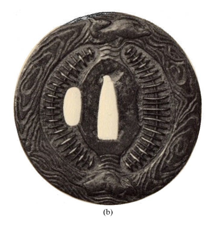

Also a slightly clearer image of page 52 Figure 1.58: (b)
