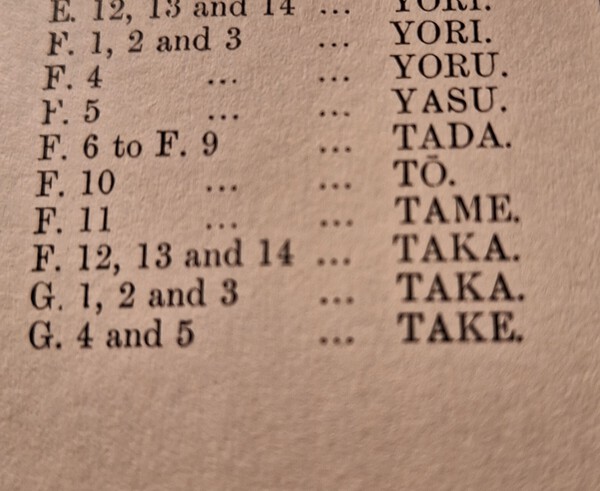

Bruce Pennington Posted August 19, 2023 Author Report Posted August 19, 2023 An update: Asked Mal Cox if he could clarify the yuki vs taka question. He checked with his exert advisor (wife!) who says this kanji would be read as "taka". So, taketaka it shall be! Thanks to all for the help. 1 Quote
