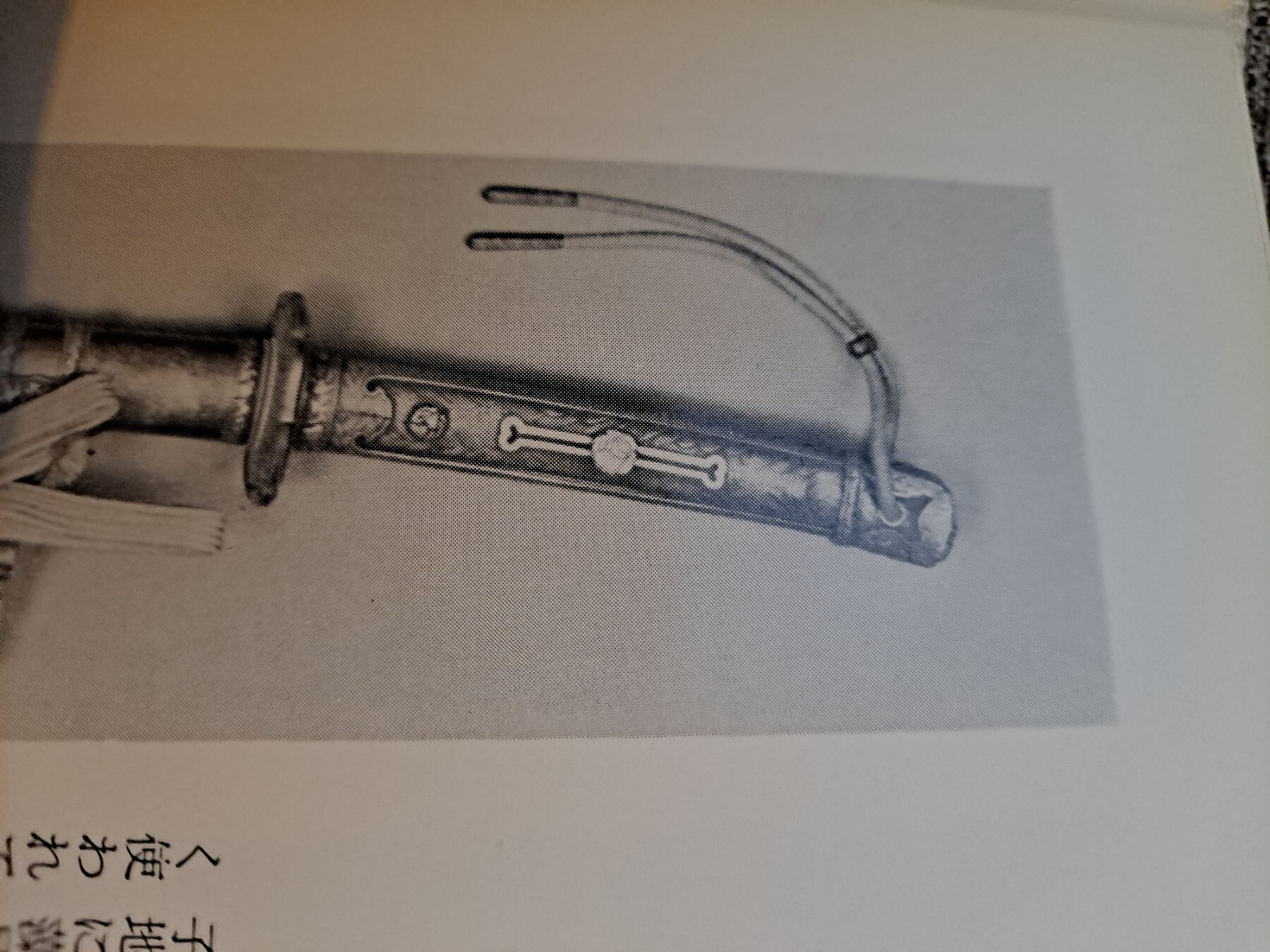

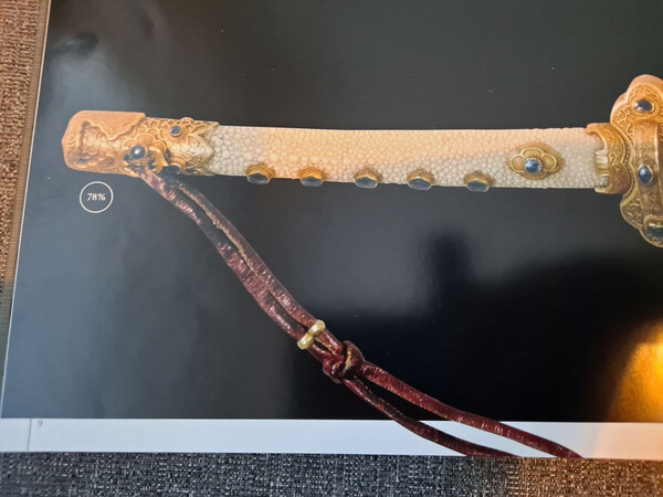

dakary Posted August 6, 2023 Report Posted August 6, 2023 Hi everybody, I am wondering about how tachi tassles were attached. Some questions were raised in my head when I looked at these reproductions: https://www.ebay.ca/...0:g:cVQAAOSweE1jeNwc They have closeup pictures that show screws being used to attach the caps to the rope or leather. I thought that looked funny, and also can't be right considering how difficult screws must have been to make back in the olden days (especially that small) but they have what they call "network pictures" that show similar tassles that seem to have something...maybe like a pin?...but those swords don't look to be antiques. Any insights? I always thought they might have been glued in but I have no idea. I haven't seen any in real life or even pictures. I have only seen them represented in period art. Thanks! Dan Quote

Jussi Ekholm Posted August 14, 2023 Report Posted August 14, 2023 Here are some pictures that I was able to find fast, I should have a good bunch of various pictures spread throughout my books. 1 Quote
dakary Posted August 14, 2023 Author Report Posted August 14, 2023 Thanks Jussi! Those ebay ones look right to me (am I wrong?) but I still think there is something suspect about attaching them with a screw. I'm guessing it was really pin/nail or rivet of some kind that secured these things. All of those that you show don't have a sarute. I posted in another threat about the purpose of the sarute and I think it is probably just another way to have a tassle? Quote
