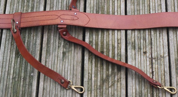

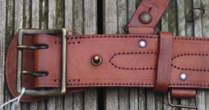

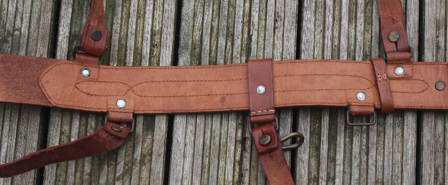

kissakai Posted August 1, 2023 Report Posted August 1, 2023 Hi I wonder if anyone can help with this sword belt? It was purchased from a well known dealer in all nihonto but passed away quite some time ago The label states: WW2 Japanese officers leather belt with sword hangers The only book I have with sword belts is Military Swords of Japan 1868 - 1945 by Fuller and Gregory This belt is not shown in this book Quote
Guest Simon R Posted August 1, 2023 Report Posted August 1, 2023 I've never seen a Japanese sword belt like that one, and to be honest, the leather looks far too new to be 70 years old. One other thing which makes me suspicious is that the combined brass hook/stud is of a cast type which I've seen on various reproduction belts and suspension straps. Quote
Larason2 Posted August 1, 2023 Report Posted August 1, 2023 Yes, it looks pretty new. What the original seller probably meant is that it is a modern reproduction belt that can be used to hang a traditional Nihonto. In this case, it looks like it can be used to hang a Tachi. The Japanese usually used different belts to hang gunto, and this doesn't look like it would be very effective for hanging any kind of a Katana or Wakizashi. Should work on a Tachi, though this is hardly a traditional belt. Maybe was made in Japan post war to wear a Tachi ceremonially, say at a shinto temple. The leather work is actually pretty good quality. Quote
John C Posted August 1, 2023 Report Posted August 1, 2023 As a leather holster and sheath maker, it looks new to me. The leather color and brushed brass colored buckle are new. The clasps look inexpensive. In addition, the edges of the leather are not finished, which generally means made somewhere other than Japan. Just my opinion, of course. John C. Quote
kissakai Posted August 1, 2023 Author Report Posted August 1, 2023 Thanks for the honest feed back I am disappointed as I bought it on trust but sometimes you pay to learn especially if it something out of ones expertise Quote
Conway S Posted August 1, 2023 Report Posted August 1, 2023 It looks like a British style Sam Browne belt. They had a long service life so not necessarily a repro. Other countries adopted this style of belt too. Conway 1 Quote
kissakai Posted August 1, 2023 Author Report Posted August 1, 2023 Conway I do a search on San Brown belts and see if can find a match Quote

Stegel Posted August 2, 2023 Report Posted August 2, 2023 I agree, it is a Sam Browne style of Belt. I can't comment on originality, however this style was used by officers in both IJA and IJN (land garisson troops). Here's a few pics of the one i have. It has two buckle prongs- not three, or the middle stud. It came with a sword captured in New Guinea. 1 1 Quote
kissakai Posted August 2, 2023 Author Report Posted August 2, 2023 I will restate it came from a collector who knew his stuff, for example he did have a couple of complete uniforms It does seem Europeanish All the hangers have a slit on one side so they could be removed. The swivel clasp looks very European What I can't fathom out is the unusual tong under the buckle Quote
John C Posted August 2, 2023 Report Posted August 2, 2023 On 8/2/2023 at 8:25 PM, kissakai said: What I can't fathom out is the unusual tong under the buckle Expand Reminds me of a police duty belt; especially the 3 hole design. The flap prevents the two prongs from scraping on the inside belt. John C. Quote

Bruce Pennington Posted August 8, 2023 Report Posted August 8, 2023 It matches the one in the last photo pretty well. While it looks fairly new, it does have wear marks and creases on the leather where the buckle would sit during use. We have gunto that are darn near pristine, why not a belt? Worn by an office working guy at the end of the war? But I don't study the belts, so my opinion isn't worth much on this. Quote
Dave R Posted August 9, 2023 Report Posted August 9, 2023 "Speak of the devil, and he shall appear", and here is another two prong belt. 1 Quote
kissakai Posted August 9, 2023 Author Report Posted August 9, 2023 Thanks Dave That is the closest yet and I think I can see the buckle flap Just need one with a view of the swivel and we have nailed it Quote
