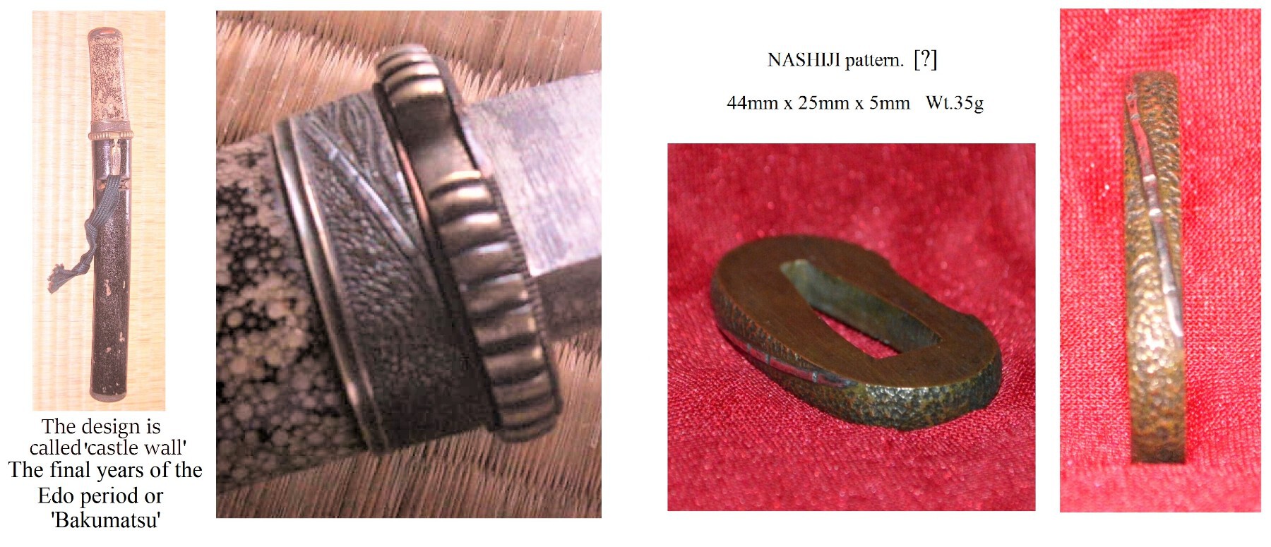

Antonis Posted July 23, 2023 Report Posted July 23, 2023 Hello everyone, I was wondering if anyone could tell me more about this Kozuka, like an approximate date and what is actually depicted on it. The only thing I can make out is a bamboo rod in the centre. I'm not sure if the rest is meant to show something specific or if it's just 2 different patterns divided by the bamboo. I am still a novice in this field but I can tell the craftsmanship isn't the best compared to other pieces but it still looks authentic to me. From what I can tell, both the blade and the handle seem to have been unfortunately polished and the blade's tang is wrapped in old paper (nothing under the paper). The blade is magnetic and the handle is a bit magnetic but I'm not sure if it's because of the tang inside. The handle looks like bronze and the bamboo rod is silver in colour with black parts (the black looks like oxidised silver but I can't tell if it's that or just oxidised bronze). I would appreciate any help and more experienced opinions. Quote

Spartancrest Posted July 24, 2023 Report Posted July 24, 2023 Hi Antonis, I have a hamidashi tsuba with the same pattern [it was described as Nashiji when I bought it but I don't think that is correct] As Grev has said I think it is "Castle Wall" The design was used on all types of fittings like the fuchi/kashira and tsuba - [at least the smaller variety] I believe there was an old thread dealing with these fittings somewhere probably pre 2021? 1 Quote

FlorianB Posted July 24, 2023 Report Posted July 24, 2023 Nashiji (pear skin pattern) just refers to the small structure (not the wavy one). The generic term for those surface patterns is ishime (stone surface). Castle wall seems plausible, imagine You look over the wall into the moat. Best Florian 1 Quote
