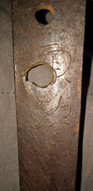

Xander Chia Posted July 20, 2023 Report Posted July 20, 2023 I’m not the most knowledgeable in this but from what I can tell, it’s a type 98 shin gunto with a field officer’s tassel and leather combat cover for the saya. In my opinion, blade is signed Kanetsugu, “兼次”. Edit: Just noticed the tsuba is not the regular gunto kind. Can’t really see what it is. The sword also looks quite short. A wakizashi maybe? 1 1 Quote
Stephen Posted July 20, 2023 Report Posted July 20, 2023 Ethan I'm sure I speak for other military collector I'd like to see pictures of the fittings I can't tell from your photos but it looks like there used to be a button release, that tsuba looks like it's from the Navy so i can't tell if its put together or what, blade is older from before ww2 2 Quote
Bruce Pennington Posted July 20, 2023 Report Posted July 20, 2023 Ethan, I'd like to see clear shots of the fittings, too, especially the tsuba (handguard) and habaki (brass collar on the blade, under the tsuba). Might be an older, family, blade re-mounted for the war with a civil tsuba. Small correction to the tassel - the brown/blue is company-grade (Lts/Capts). Feild grade are red/brown. Quote
vajo Posted July 20, 2023 Report Posted July 20, 2023 Looks like the Fuchi is missing. I'm with Stephen, thats an older blade. 包次 Kanetsugu 1 Quote
Tensho Posted July 20, 2023 Report Posted July 20, 2023 Someone mounted the fuchi under the habaki instead of on the tsuka. And yes, it looks like it has a hole for the Chuso. I'm with everyone else, more pictures of the mounts would be nice. 1 Quote
mecox Posted July 20, 2023 Report Posted July 20, 2023 Looks like Kanetsugu 兼次 Mino maybe late Koto (Muromachi?) but need to see full blade. And it does look like fuchi is on under side of tsuba. 1 Quote
Xander Chia Posted July 21, 2023 Report Posted July 21, 2023 On 7/20/2023 at 10:32 PM, Tensho said: Someone mounted the fuchi under the habaki instead of on the tsuka. And yes, it looks like it has a hole for the Chuso. I'm with everyone else, more pictures of the mounts would be nice. Expand Wow I can’t believe I missed that. Felt something looked off but couldn’t point out what it was exactly. Quote
MajorAny2769 Posted July 22, 2023 Author Report Posted July 22, 2023 The plate that protects the hand is made of copper and It looks like it was painted black. 1 1 Quote
Geraint Posted July 22, 2023 Report Posted July 22, 2023 Dear Eathen. The sword clearly has a blade older than WWII. The tsuba looks as though it is made of shakudo, an alloy of copper and small amounts of gold, don't attempt to clean that, the black is the correct patina. The copper coloured collar, the fuchi, has a hole for the spring catch that would have held the sword in the scabbard but the tsuba does not have the corresponding slot and so is a replacement. (Or maybe the hilt is the replacement?) The black oval collar around the blade next to the habaki is nothing to do with the sword and probably is there to take up the slack in the fittings caused by the lack of seppa. There would have been a Gunto tsuba and anything between two and four pairs of seppa. Have a look in the mouth of the scabbard and see if there is a slot that would have accepted the spring catch, if it's not there then perhaps it is the tsuka, the hilt, that has been replaced. I'll attach a picture of the fittings as they might have looked. If you can get that black collar off the sword and the habaki next to it then a photograph of the whole blade, point upward and the dimensions would be interesting. Take it slow, don't attempt to clean more than a light oiling of the blade, leave the tang, the nakago, alone. Others will add their thoughts as we go along. All the best. 3 Quote
Stephen Posted July 22, 2023 Report Posted July 22, 2023 My initial thought was an older blade cobbled together with parts. Aka Frank n Stine 1 Quote
Geraint Posted July 22, 2023 Report Posted July 22, 2023 Dear Stephen. You might well be right especially as the fuchi is fitted for the spring clip but the combat cover has the stud for the leather strap. Hard to tell quality of fit from pictures unless it's obviously way off. Habaki looks good and for the sword, apart from that we don't know. Eathen, does the blade fit really well into the saya? The blade should slide in smoothly resting the back edge on the saya and the habaki should fit nicely at the mouth. And does the tsuka fit equally well to the nakago? All the best. Quote
