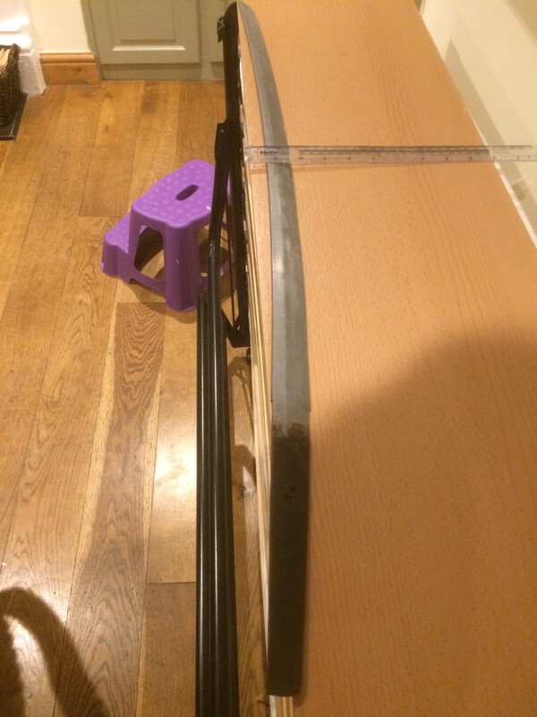

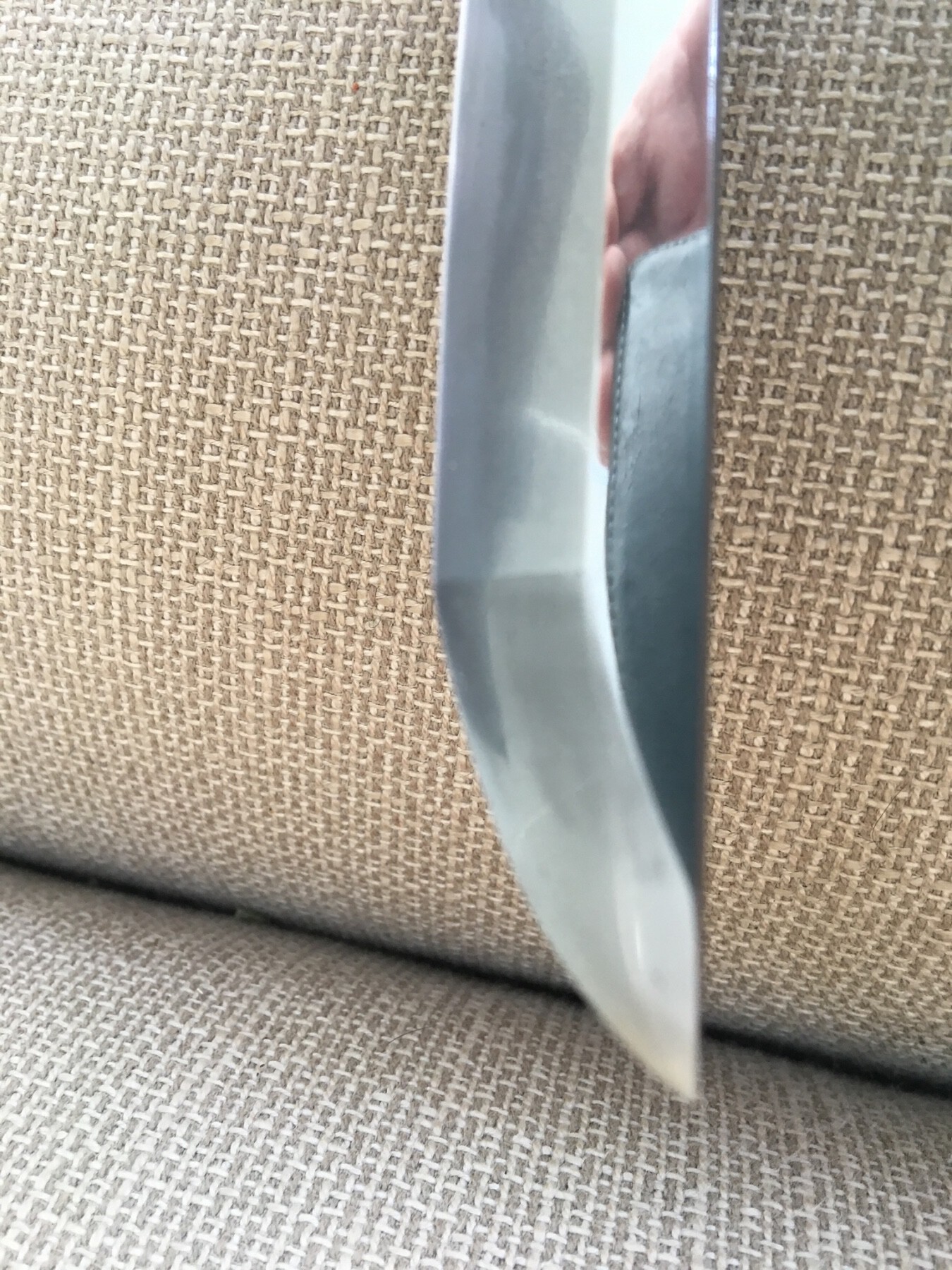

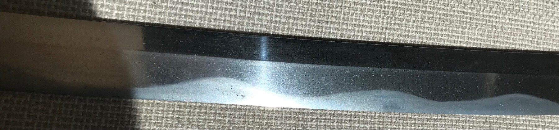

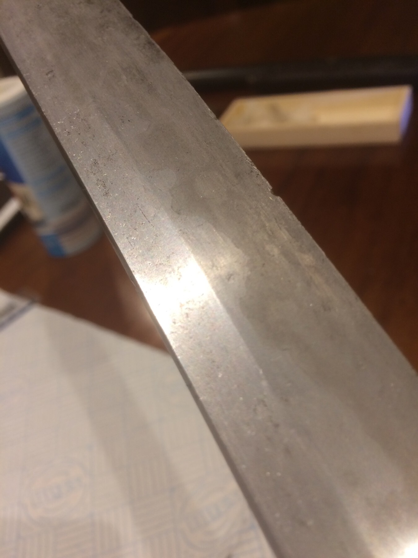

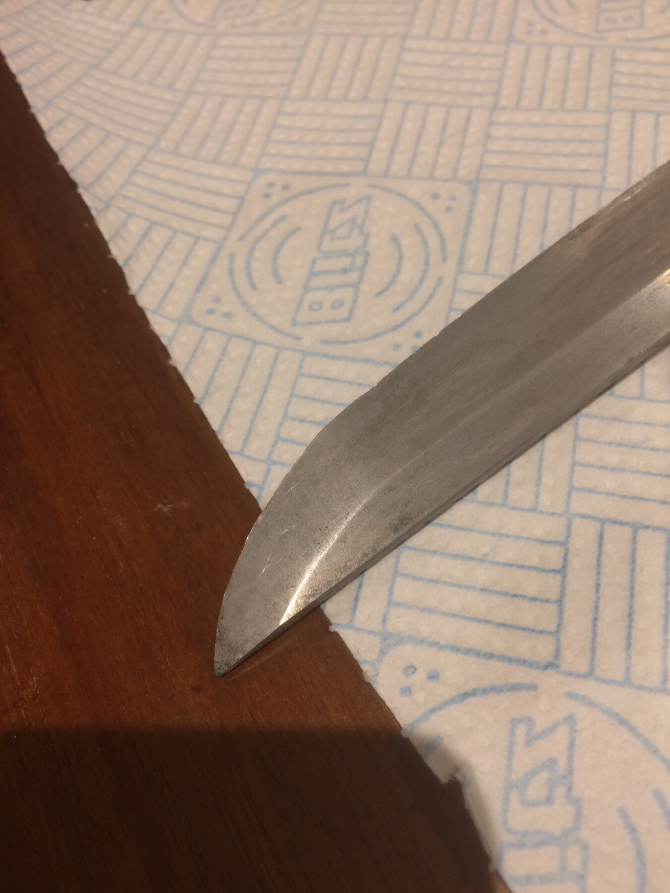

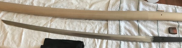

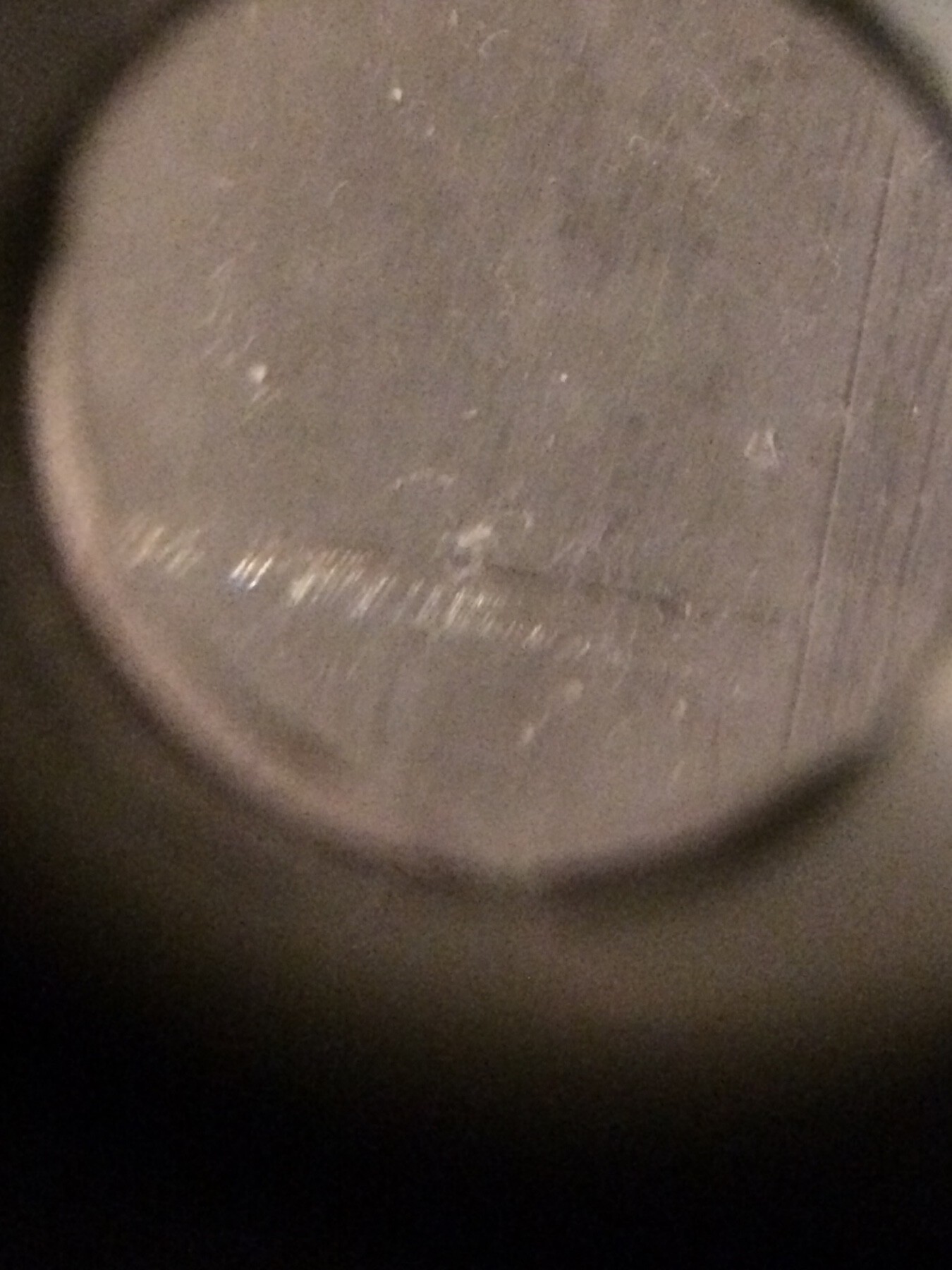

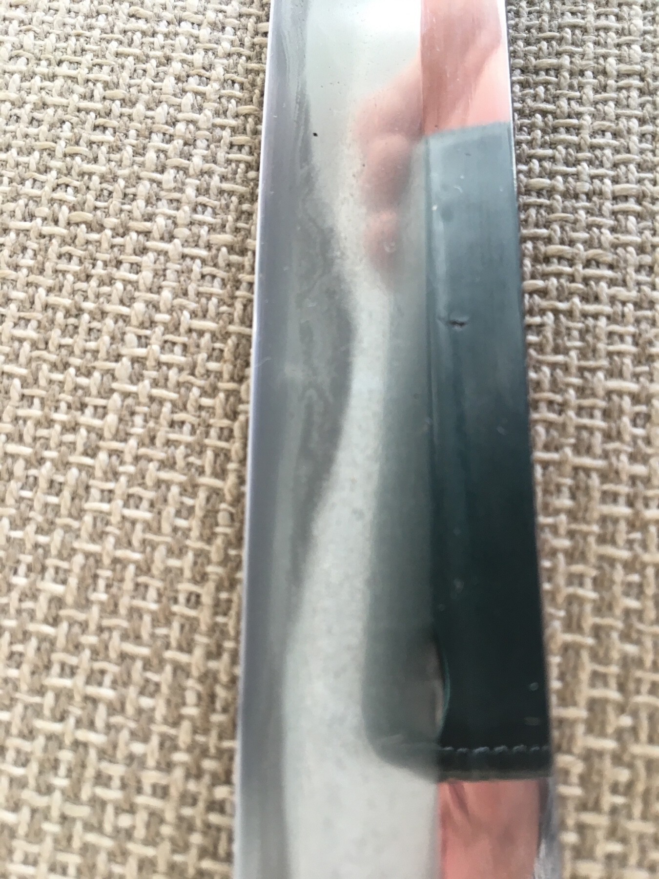

Jon Posted July 19, 2023 Report Posted July 19, 2023 A couple of years ago I posted a blade I had inherited, this kicked off my journey and interest in Nihonto. After a long wait I’ve now had the blade polished and fitted with a new shirasaya. So I thought I would post the before and after shoots. it’s worth noting that the polisher felt some of the chips were to deep to fully Polish out without impacting on the blade…but this never a commercial decision, was all about restoring a family heirloom as well as giving me a koto study piece for the price of the polish. Also any thoughts or views on the blade would be appreciated as well. 1 Quote

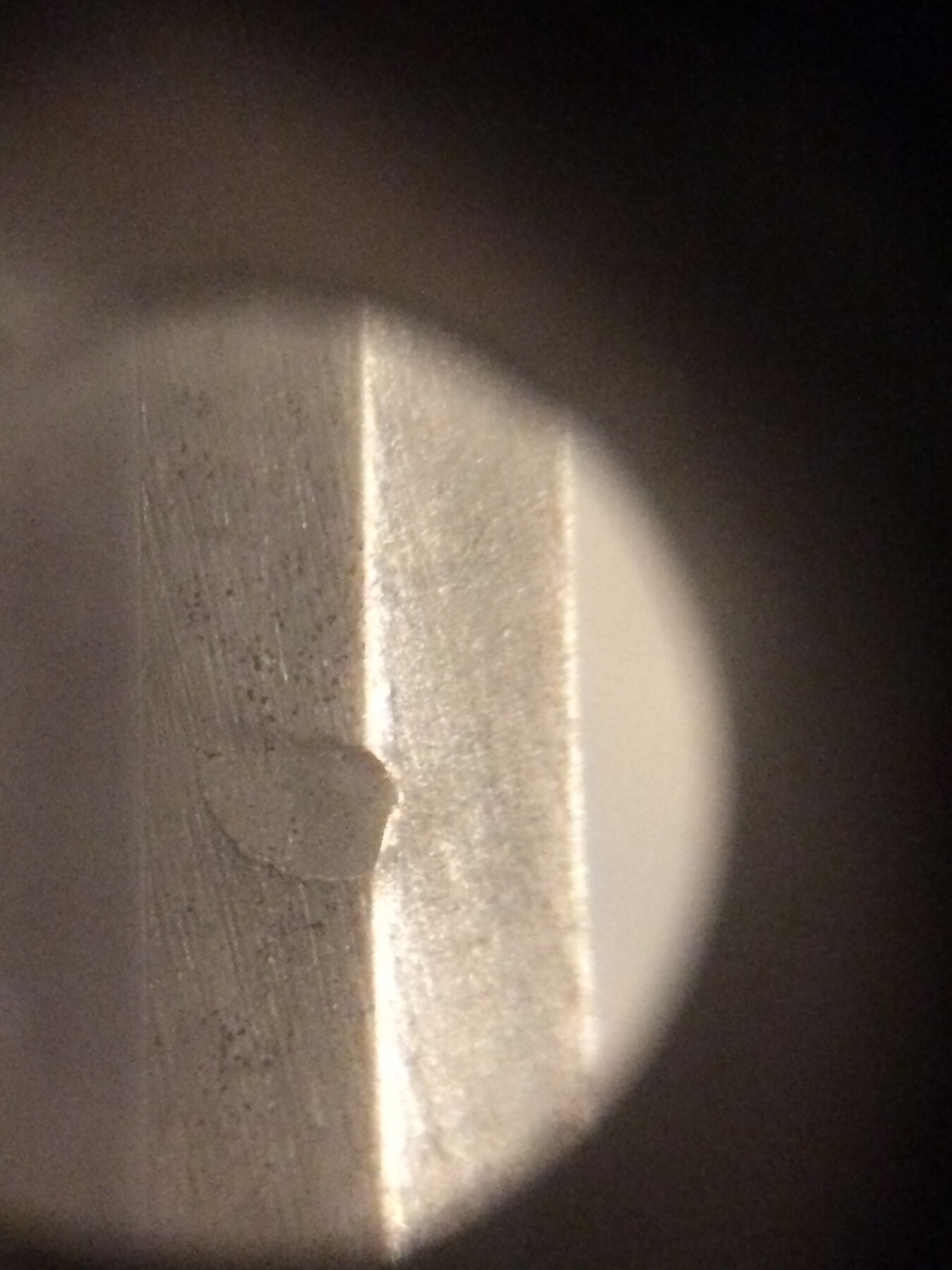

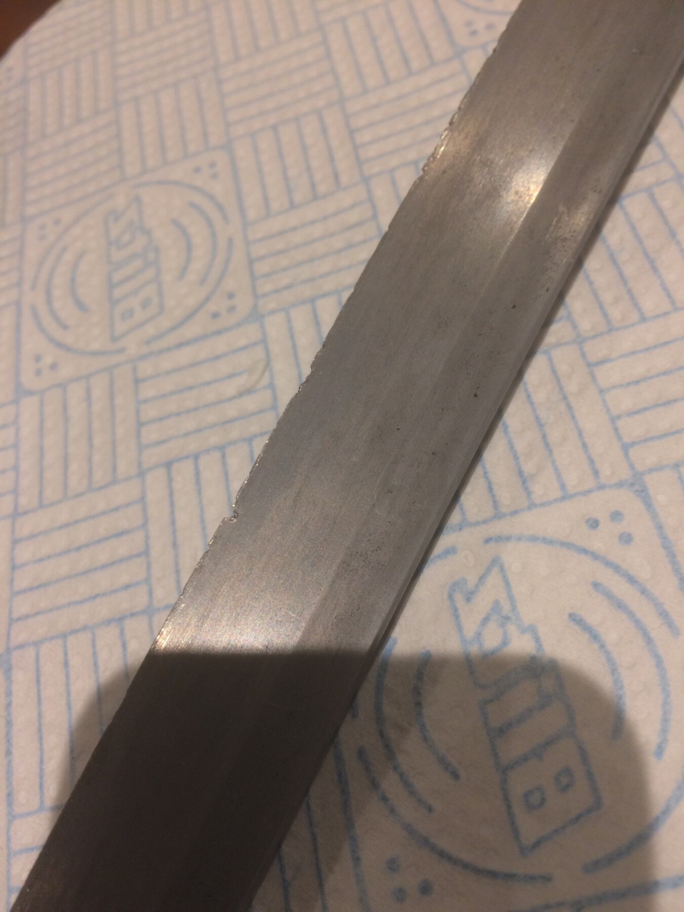

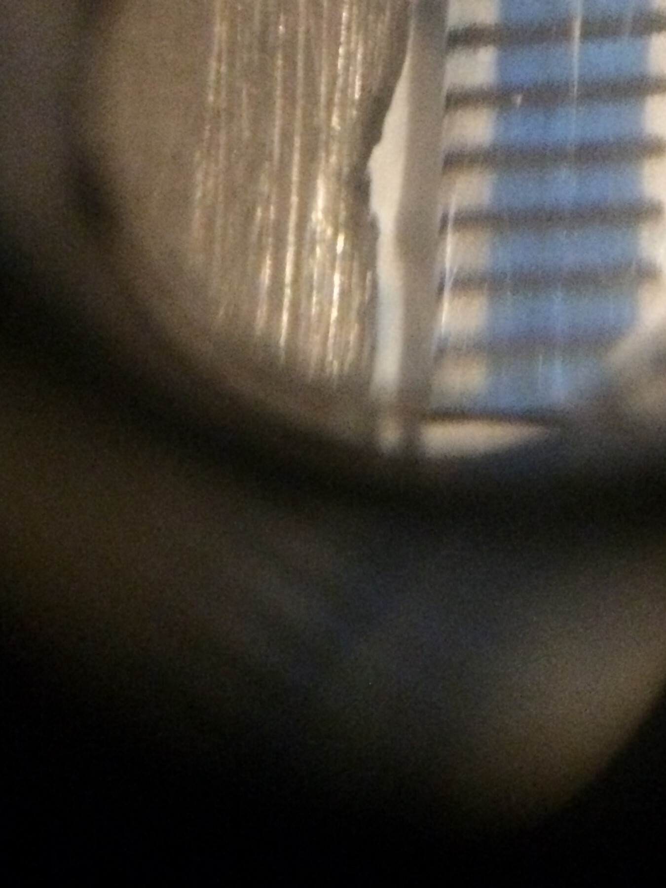

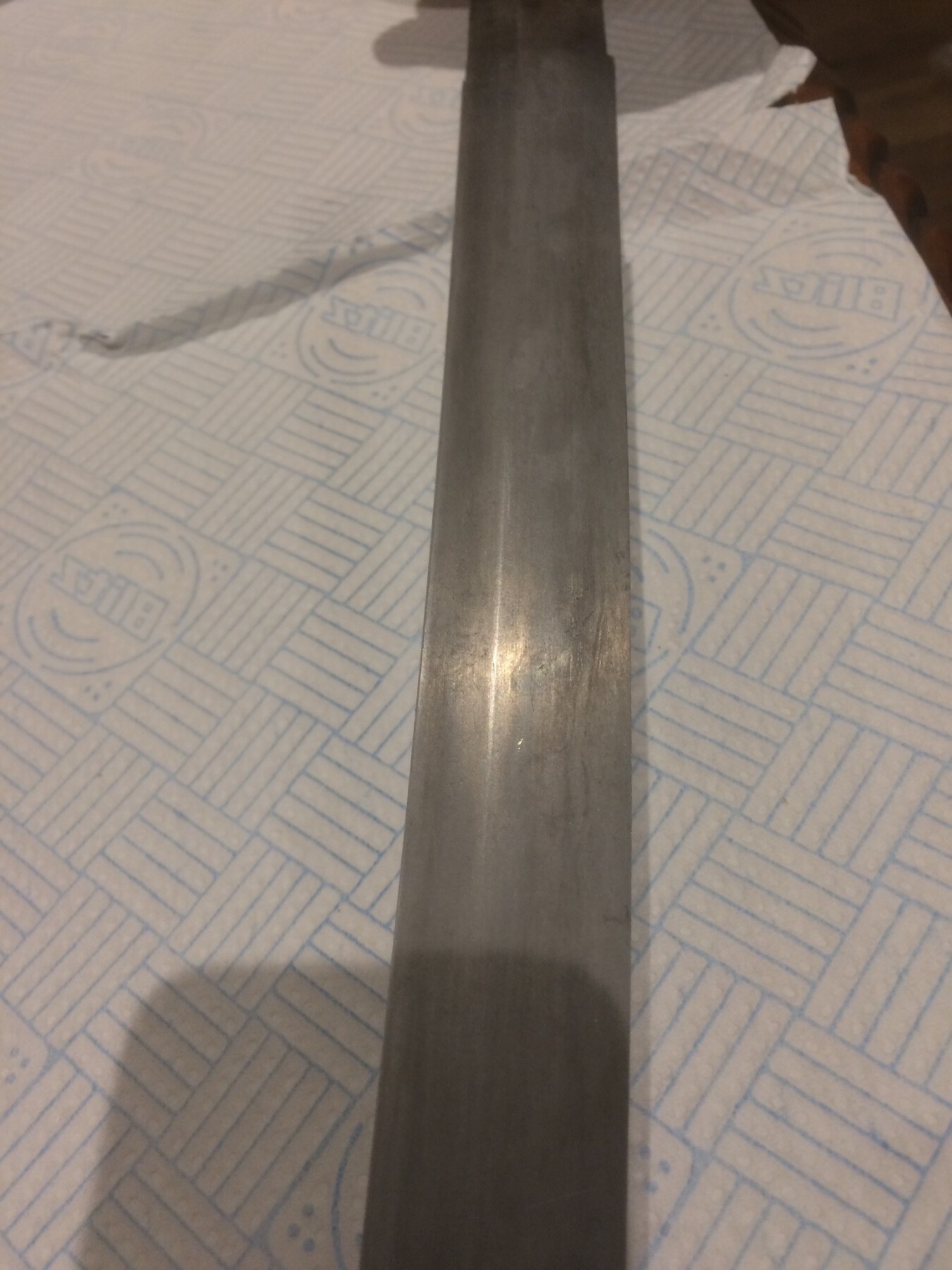

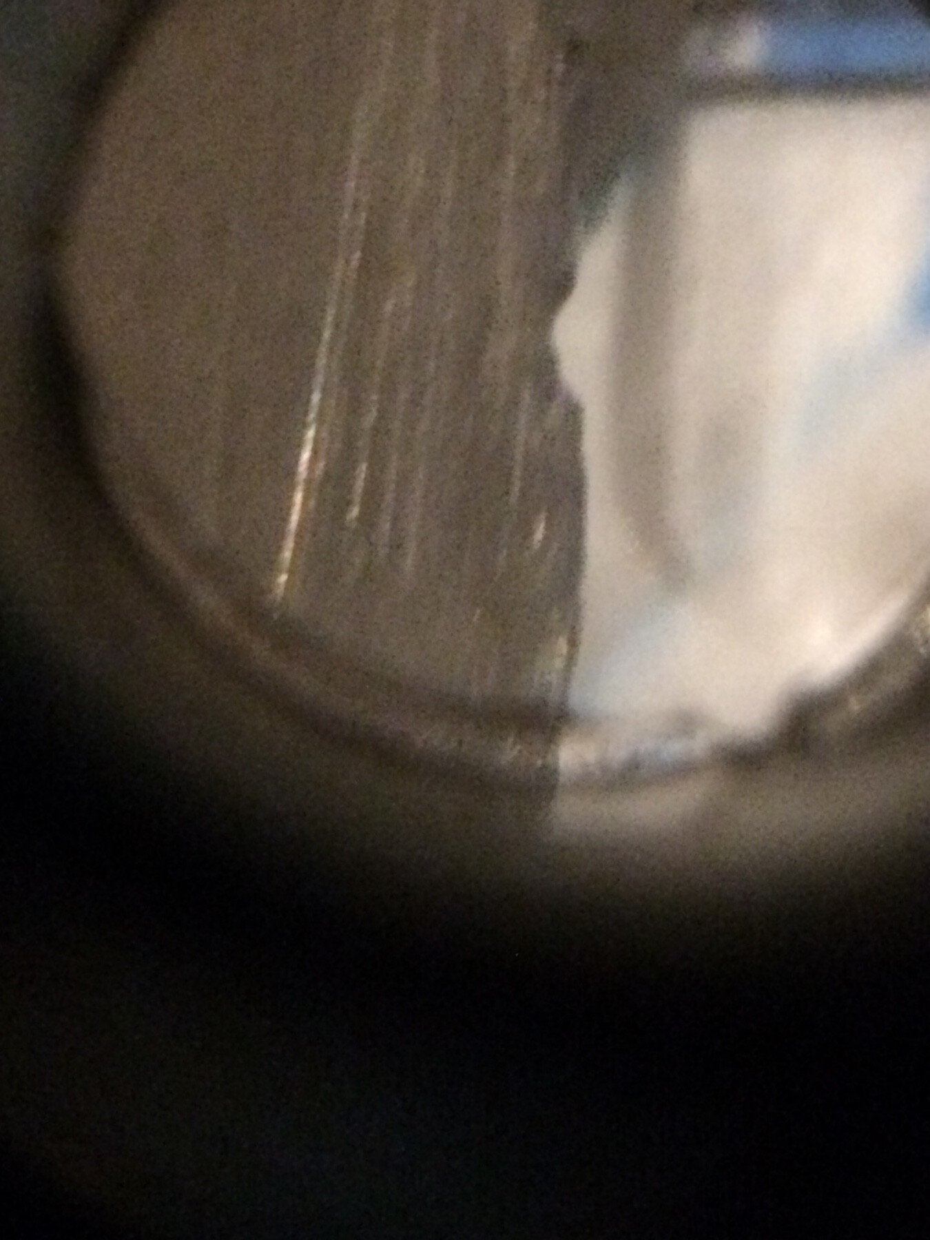

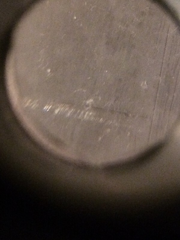

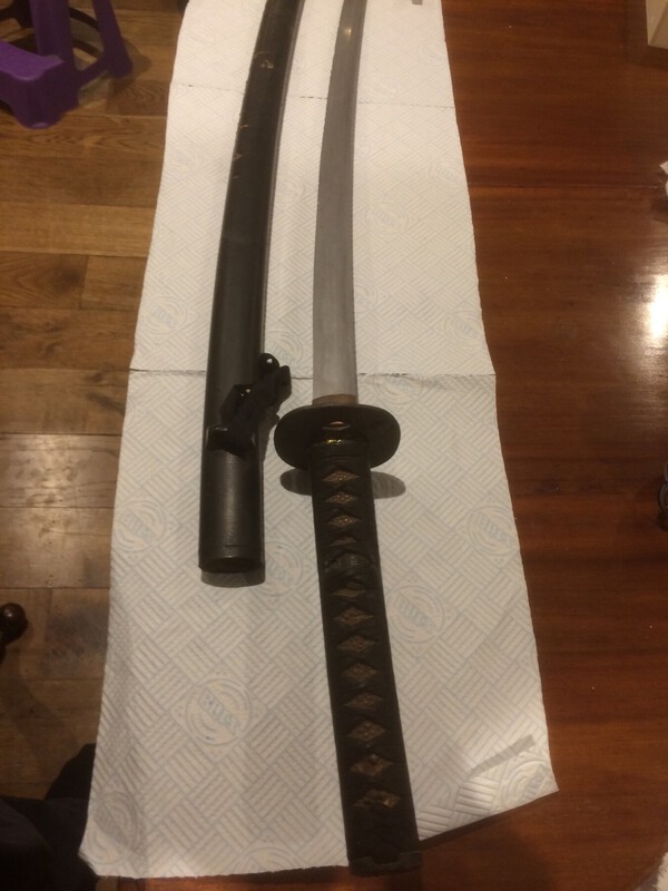

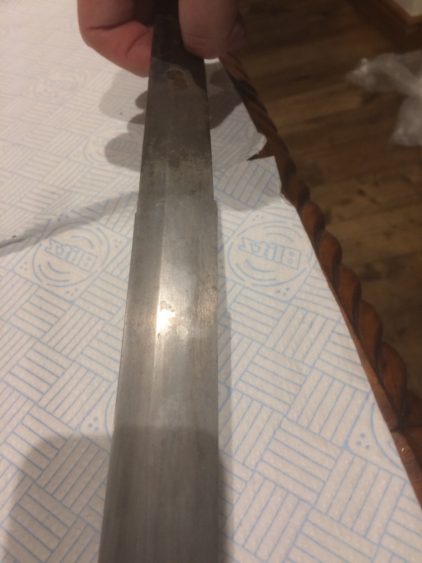

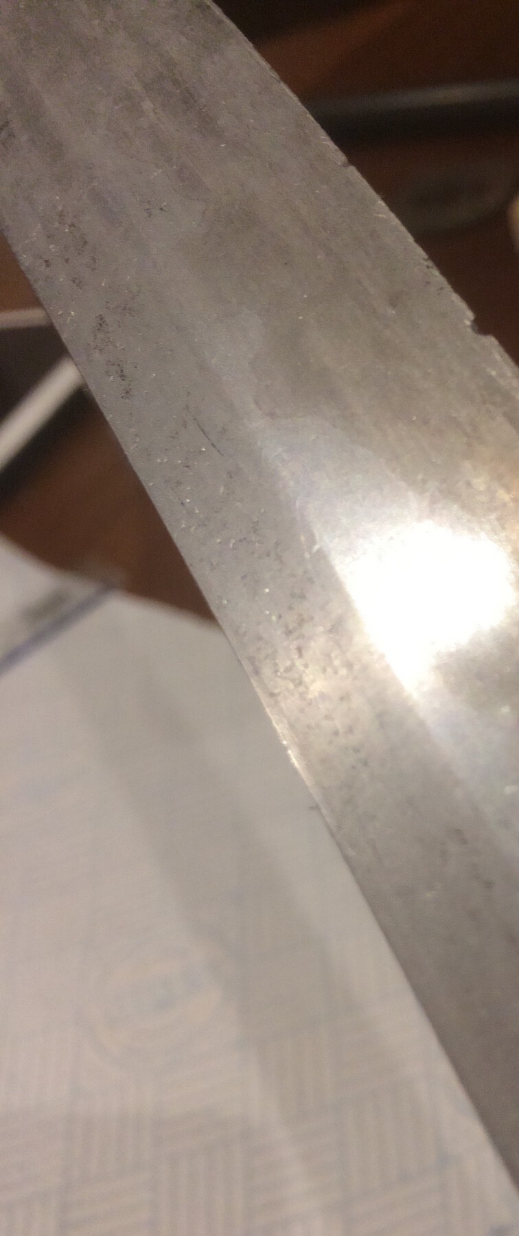

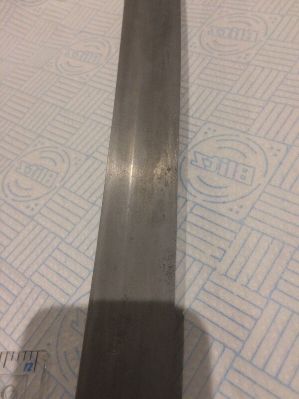

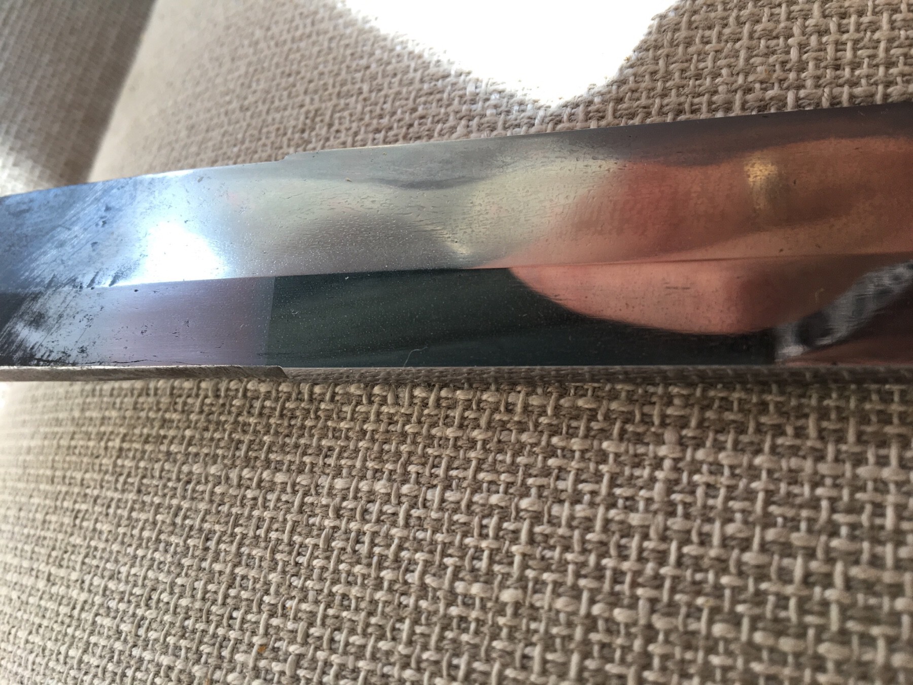

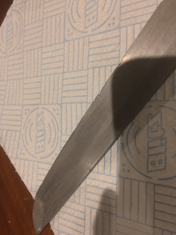

Jon Posted July 19, 2023 Author Report Posted July 19, 2023 More pictures of the out of polish damage 1 Quote

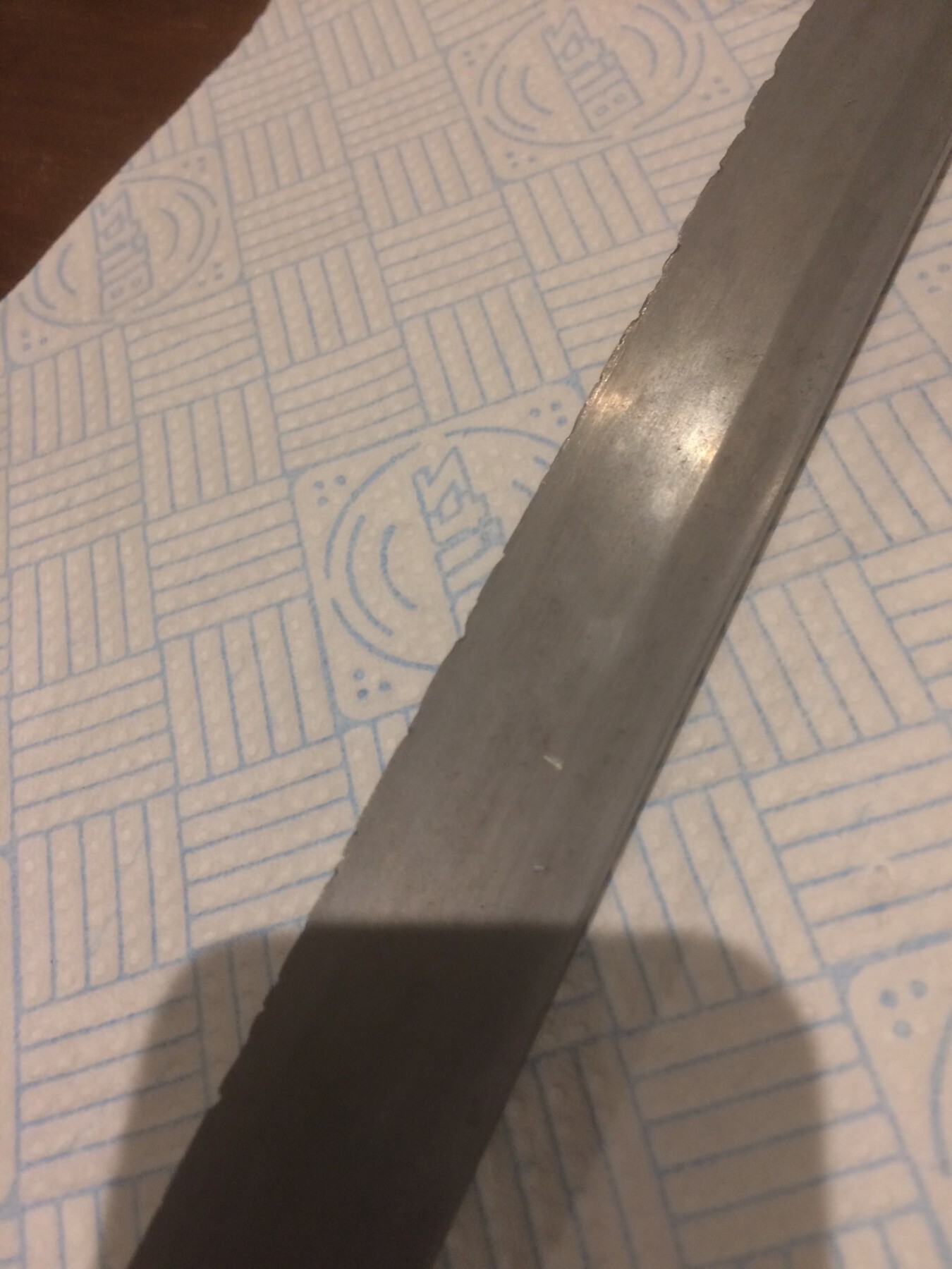

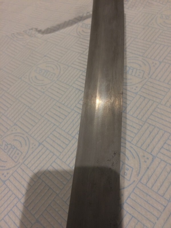

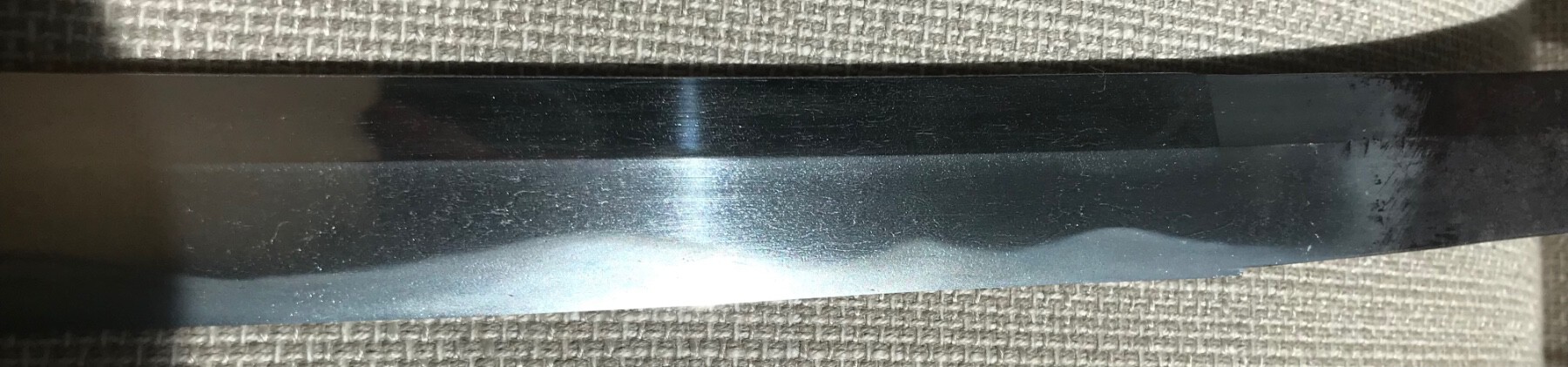

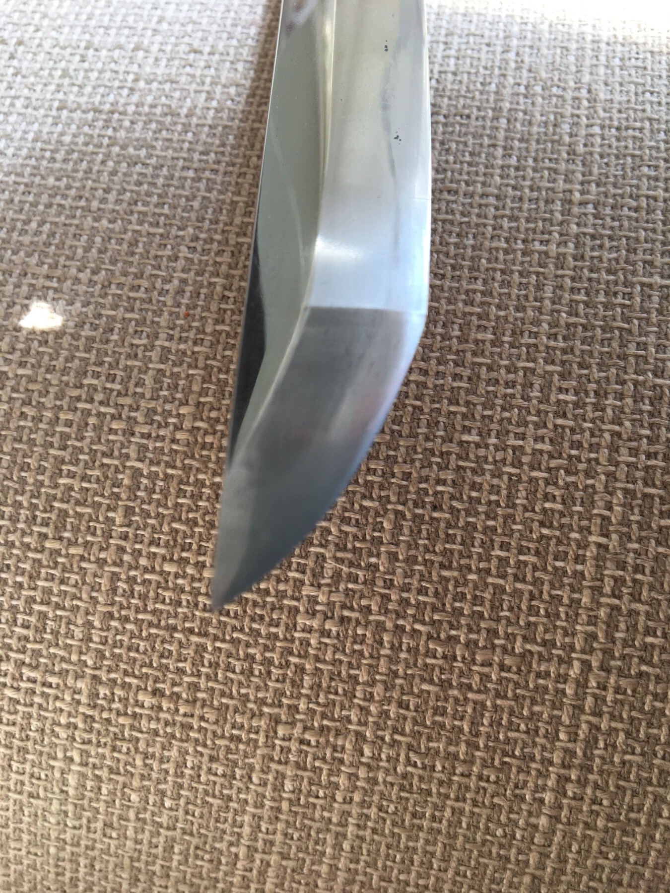

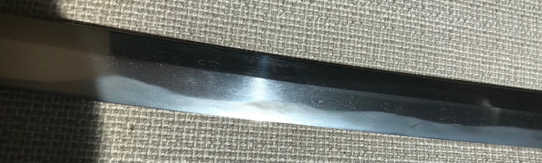

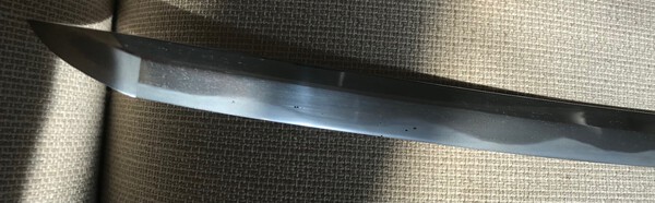

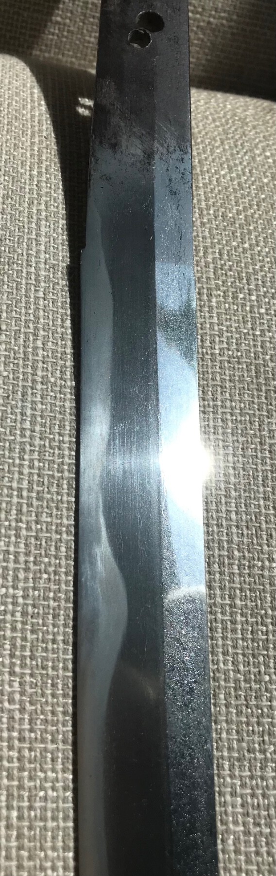

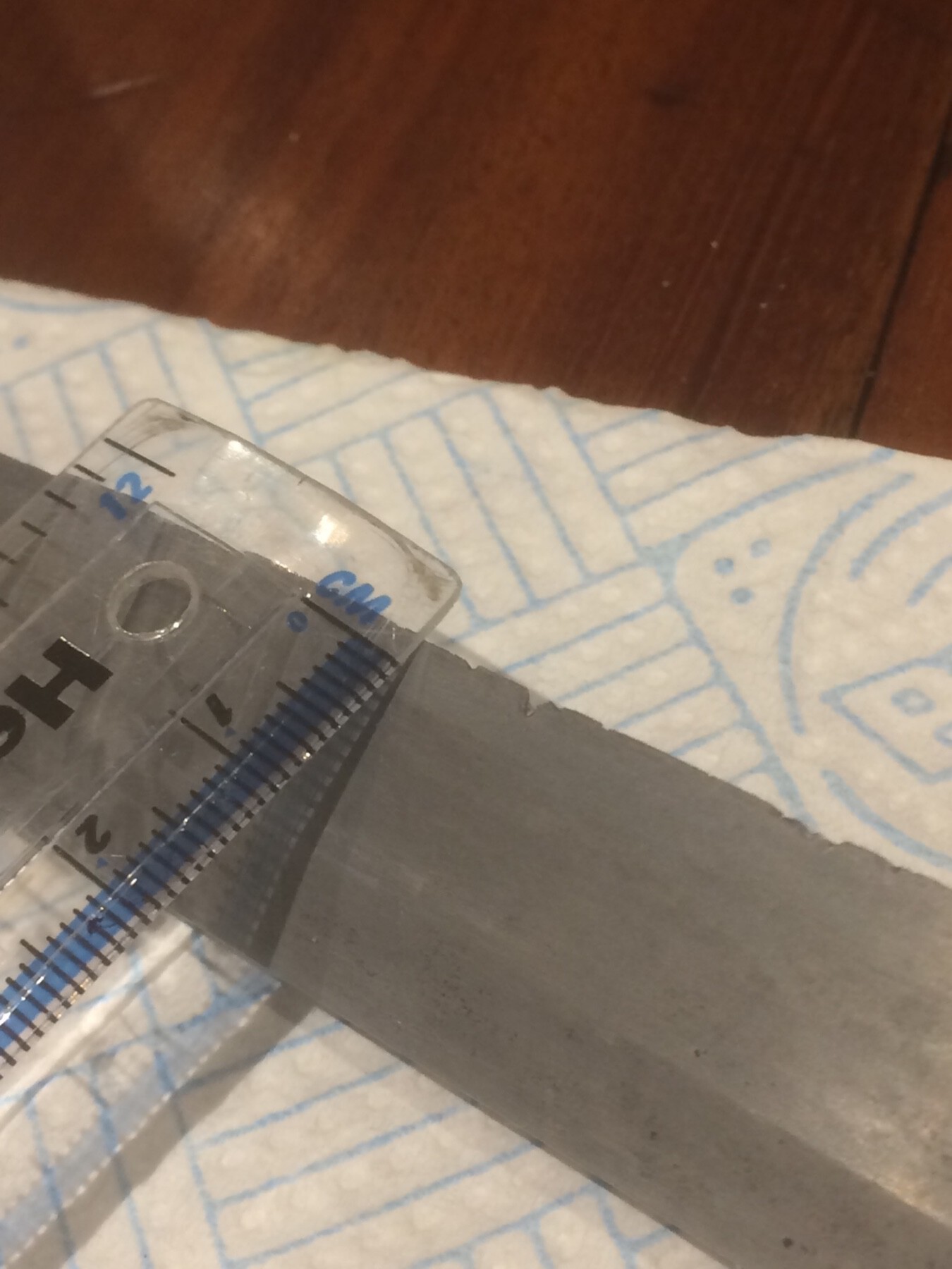

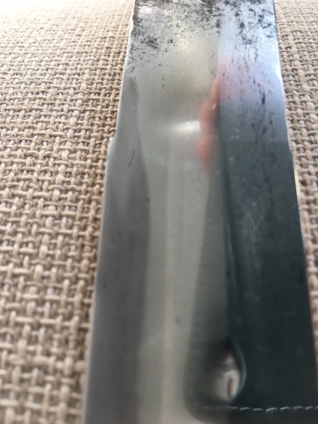

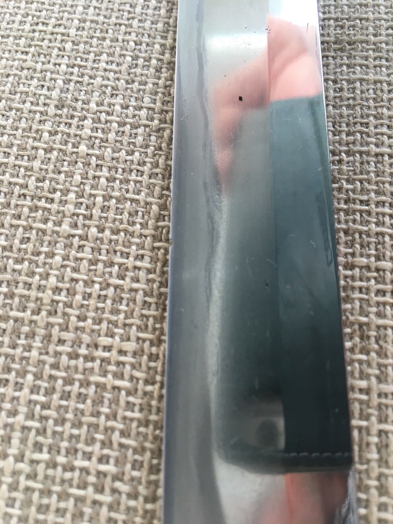

Jon Posted July 19, 2023 Author Report Posted July 19, 2023 Now for the fully polished blade with Shirasaya. As I mentioned earlier any thoughts on the blade, it’s character etc would be very much appreciated. 1 Quote
2devnul Posted July 19, 2023 Report Posted July 19, 2023 Hello, Great job on bringing that blade back to life. I'm a complete newbie so please treat my comments lightly. Color of the steel suggests Koto period, but IMHO (probably wrong) shape is more Shinto alike. Nice notare/gunome hamon, hada quite tight too. I understand it is mumei as you haven't posted any mei pictures. Two wholes in nakago suggest it was 'moved around' to different koshirae. Any mei on Tsuba? But the best part are the chips on cutting edge. If only swords could talk, I wonder what happen there. Congratulations for owning a great sword! Quote
Baba Yaga Posted July 19, 2023 Report Posted July 19, 2023 Good to see the blade didn't receive the overabundance of hadori polish. The hamon outline is well done IMOP. Also good judgement about not going deep. Well done! Quote

JAMJ Posted July 20, 2023 Report Posted July 20, 2023 In following on the last note, a common reference states that a sword in proper polish should have a hamon of a milky white appearance. Is that referring to only the habuchi or the surface all the way down to the ha? Would that be true for any sword or should that be adjusted for the period in which it was created? And to that, would any fully trained togishi be able to polish to the style of the period? Quote

DoTanuki yokai Posted July 20, 2023 Report Posted July 20, 2023 Looks like something Yamato related but I can’t say more without seeing the Nioiguchi and Jinie. I think The guide from Darcy is a little complicated and will in the end not give what I (we) are looking for. I like this one more http://www.ksky.ne.jp/~sumie99/hamon.html also look at this http://www.ksky.ne.j...ie99/appreciate.html Edit: also a picture that shows the bare blade from directly above it so we can see how it curves is useful. 5 Quote
John C Posted July 22, 2023 Report Posted July 22, 2023 It's difficult to tell zoomed in, but could that possibly be a bullet strike? Did the polisher say anything about it? John C. Quote

Ken-Hawaii Posted August 10, 2023 Report Posted August 10, 2023 Darcy was already a Grand Master to many of us, Dave. Unlikely to be from a bullet, John. Knowing how a sword is actually used will give you a more-likely answer. Good job on the restoration. Lots to study. Quote
