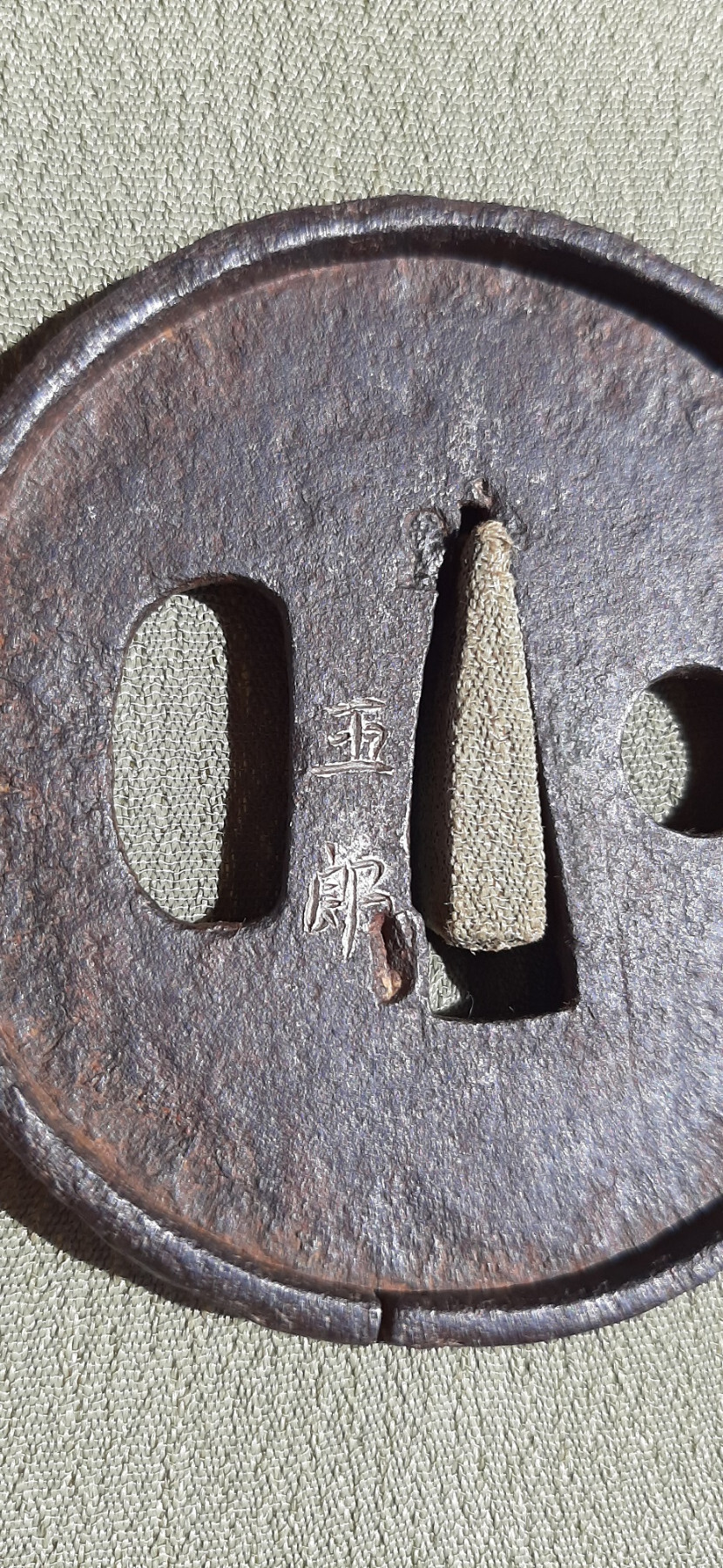

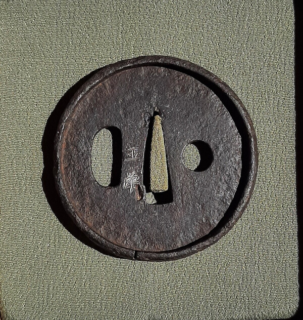

Itomagoi Posted July 6, 2023 Report Posted July 6, 2023 Can anyone help me with this little unusual tsuba? I think the mei was cut afterwards. 60.1 x 59.7 x 2.5 mm 1 1 Quote

Itomagoi Posted July 7, 2023 Author Report Posted July 7, 2023 With the translation of the signature 1 Quote
SteveM Posted July 7, 2023 Report Posted July 7, 2023 It just says 五郎 (Gorō). Its not the real name of a smith. It's a very generic, common name. 1 Quote

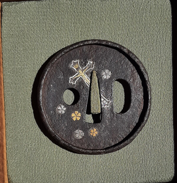

dkirkpatrick Posted July 7, 2023 Report Posted July 7, 2023 Has to be one of the more unarguably “Christian tsubas” I’ve seen! Quote
Brian Posted July 8, 2023 Report Posted July 8, 2023 Yes, but I suspect almost certainly done later. 2 Quote
