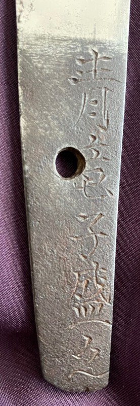

Brian Posted July 4, 2023 Report Posted July 4, 2023 I feel like I really should know this one, but I'm just not finding the answer. Aside from the last one which I think is 'shi' ? It's on a tanto, likely Shinshinto. Thanks in advance. 1 Quote
Bugyotsuji Posted July 4, 2023 Report Posted July 4, 2023 青龍子 Seiryushi? (Don't have my books here to double-check). 1 Quote
Brian Posted July 4, 2023 Author Report Posted July 4, 2023 Hmmm. Interesting. I wonder if this could be Seiryuken Moritoshi? He firstly named himself Seiryushi (a child of Blue Dragon) and then changed it to Seiryuken. Or does anyone have any other ideas? Maybe Seiryūshi Kanetsugu? It's hitatsura, Hirazukuri and an o-tanto. Will post pics soon. 1 Quote
Mark S. Posted July 4, 2023 Report Posted July 4, 2023 Most definitely Seiryushi, but strange no name afterward. Here is a Seiryushi Moriyuki I own. Passed NTHK-NPO. He used the simplified ‘ryu’ in mei. 1 Quote
george trotter Posted July 4, 2023 Report Posted July 4, 2023 Brian, My book 'Nihonto Meikan' by Homma and Ishii 1975 shows in the index of titles (shogo) on p.16 (1539) has 9 smiths who used the this shogo. 2 from Showa, 2 from Meiji and 5 from earlier. This list gives the page number where you can read about the smith, his work etc. (has no images). I would send you the references but my computer is causing problems with images right now so I can't copy the pages for you. Maybe someone who has this book can help you? Regards... Quote
vajo Posted July 4, 2023 Report Posted July 4, 2023 Seirushi means founder/ mother. So it means nothing without a smith name following. Quote

Brian Posted July 5, 2023 Author Report Posted July 5, 2023 Thanks Mark and George. Can someone explain the exact use of the word "go"? I know it is a personal name or art name, but does that mean the smith signed using that, or does it just mean that is what he called himself? If a book says he used the go "Seiryushi" would that mean he sometimes signed that way or something else? Pics of the sword are posted here: https://www.militaria.co.za/nmb/topic/45504-tanto-signed-seiryushi/ Quote

C0D Posted July 5, 2023 Report Posted July 5, 2023 What if it's this guy? NORIKATSU (徳勝), Shōwa (昭和, 1926-1989), Hiroshima – “Seiryūshi Minamoto Norikatsu kore o kinsaku” (青龍子源徳勝謹作之), “Minamoto Norikatsu” (源徳勝), real name Nakahara Tokuji (中原徳二), born October 12th 1906, gō Seiryūshi (青龍子), he was basically a self-taught smith, taking the writings of Suishinshi Masahide as a guidline, he also worked as guntō smith (it is said about 180 guntō blades until the end of World War II), ryōkō no jōi (Akihide), Fifth Seat at the 6th Shinsaku Nihontō Denrankai (新作日本刀展覧会, 1941) (see picture right) Quote
Brian Posted July 5, 2023 Author Report Posted July 5, 2023 Thanks Manuel, I did come across his too. I'm not sure how to work out which guy it is unless I come up with another hitatsura sword. I think I have about 5 smiths that mention the go of Seiryushi. But haven't seen any just signed with that. It's a real puzzle. I wonder what Shinsa would say. Quote
