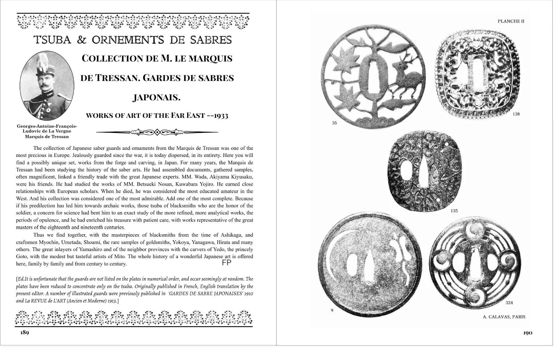

Spartancrest Posted June 15, 2023 Report Posted June 15, 2023 When the Marquis de Tressan died his collection was auctioned and dispersed - I have some images from his collection that I translated into English [not very well] You might notice a few shown in the links suplied by Arnaud. 5 Quote

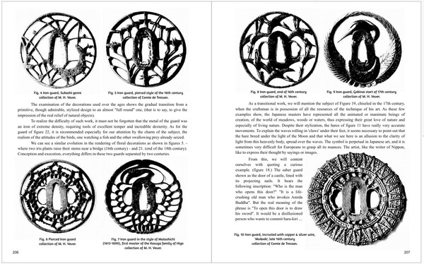

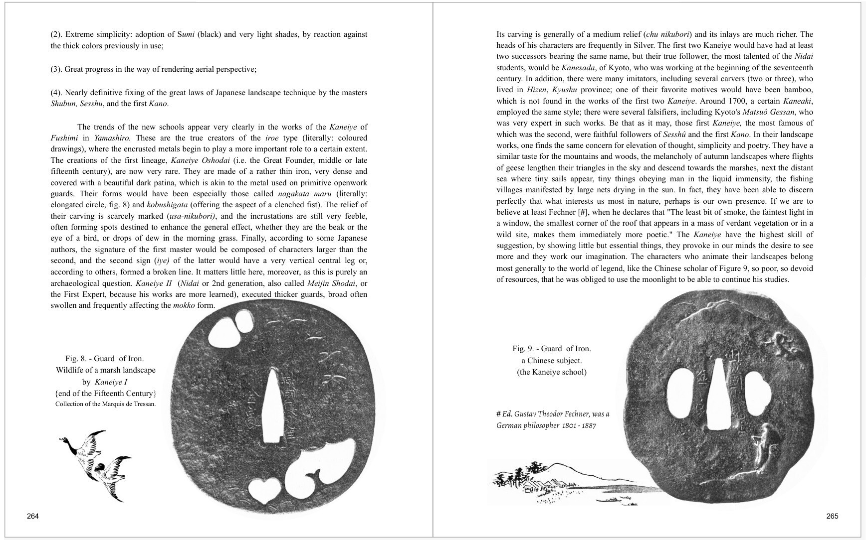

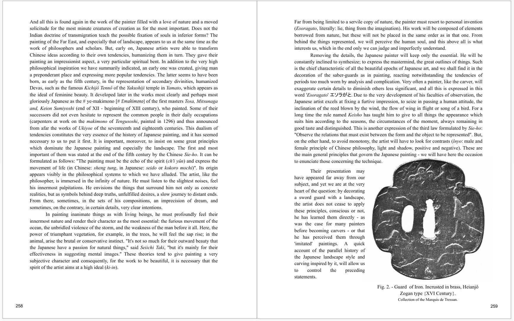

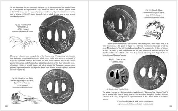

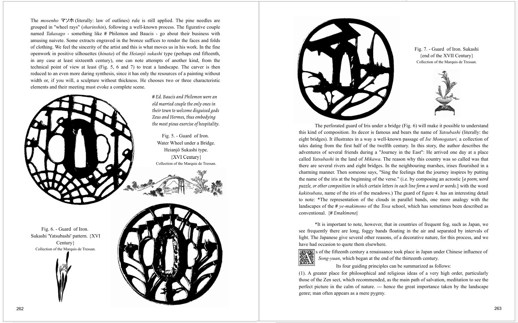

Spartancrest Posted June 16, 2023 Report Posted June 16, 2023 Another article I translated by the Marquis De Tressan 1913. 1 Quote
Spartancrest Posted June 16, 2023 Report Posted June 16, 2023 There was another article from 1910 very similar to the link posted by Arnaud - I have translated it to English and condensed the layout. The Marquis/Comte seems to have been rather prolific with his articles, though many of the examples he presented were used over and over again. 1 2 1 Quote
