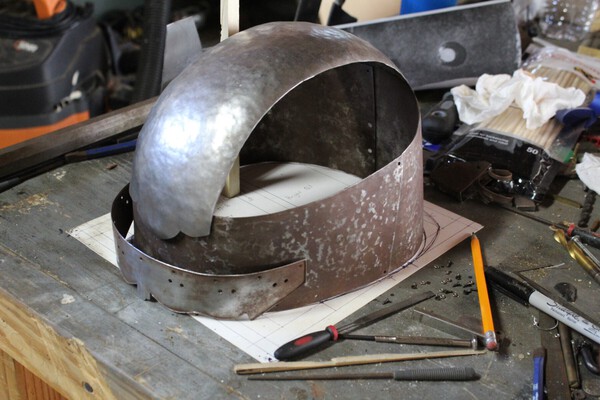

Arthur G Posted June 20, 2023 Author Report Posted June 20, 2023 Making some more headway on this guy 3 1 Quote
chris covington Posted June 20, 2023 Report Posted June 20, 2023 On 6/20/2023 at 12:24 AM, Arthur G said: Making some more headway on this guy Expand That top plate, how do you get that dishing in both directions so evenly?!? That is such a pain on my zunari. 1 Quote
Arthur G Posted June 20, 2023 Author Report Posted June 20, 2023 On 6/20/2023 at 12:33 AM, chris covington said: That top plate, how do you get that dishing in both directions so evenly?!? That is such a pain on my zunari. Expand To quote sensei, hit it until it fits! 3 Quote
ROKUJURO Posted June 21, 2023 Report Posted June 21, 2023 On 6/20/2023 at 12:33 AM, chris covington said: That top plate, how do you get that dishing in both directions so evenly?!? That is such a pain on my zunari. Expand Hi Chris, I think this is not too difficult if you have the right sheet metal (preferably deep-drawing steel from car bodies), good wooden molds to beat it down into, and wooden hammers in the necessary dimensions. I am not a KACHU maker, but I have watched European craftsmen shaping armour parts even with a (hard) rubber hammer! Cold! As with most crafts, experience and patience are main factors. 1 Quote
chris covington Posted June 21, 2023 Report Posted June 21, 2023 On 6/21/2023 at 7:34 PM, ROKUJURO said: Hi Chris, I think this is not too difficult if you have the right sheet metal (preferably deep-drawing steel from car bodies), good wooden molds to beat it down into, and wooden hammers in the necessary dimensions. I am not a KACHU maker, but I have watched European craftsmen shaping armour parts even with a (hard) rubber hammer! Cold! As with most crafts, experience and patience are main factors. Expand It always looks easy on the videos. With hammer in hand it is much more challenging. My metal snakes every which way. Arthur does masterful work. I’m just a hobbyist. I haven’t mastered the trapezium of katchu. I’ll get there eventually! 😁 1 1 Quote
Arthur G Posted June 21, 2023 Author Report Posted June 21, 2023 On 6/21/2023 at 8:20 PM, chris covington said: It always looks easy on the videos. With hammer in hand it is much more challenging. My metal snakes every which way. Arthur does masterful work. I’m just a hobbyist. I haven’t mastered the trapezium of katchu. I’ll get there eventually! 😁 Expand It snakes every which way with me too. That's part of how it goes. You just gotta listen to what the steel is telling you and hit it in the right spots 'til it fits. And the only way to get anywhere with it is just by doing it like you are. I'm only a couple years into this and I'm already starting to build up some intuition with it I think. It just becomes second nature. 1 1 Quote
ROKUJURO Posted June 21, 2023 Report Posted June 21, 2023 On 6/21/2023 at 8:20 PM, chris covington said: It always looks easy on the videos..... Expand I did not speak about videos, I have watched people in France working on armour, and I talked to them. As I said above, experience and patience are main factors. And I can underline what Arthur wrote: You just gotta listen to what the steel is telling you..... A while ago, I made a video (YouTube) in my forge, titled: "Was der Stahl will" (What the steel wants). 3 Quote
