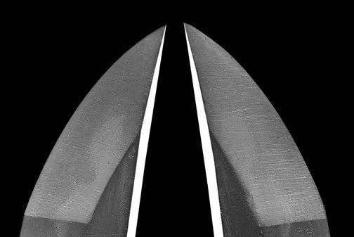

cisco-san Posted August 28, 2009 Report Posted August 28, 2009 Hallo, I also think that it would be a good deal. @all Btw. in the description of the blade you can read that it was polished. If you have a closer look on the kissaki from my point it seems that there are some horizontal "scratches". I saw such "scratches" recently on a freshly polished sword as well I have no explanation for that. Of course a the polish can be bad but.....?! Thanks Klaus Schicker Quote

raven2 Posted August 29, 2009 Report Posted August 29, 2009 Klaus, If you look at all the descriptions on AOI, they all say the blade was polished. From what I have seen, it doesn't mean it was in new polish but just polished at some time. Either that or they are having them done at some of the worst polishers I have seen. Quote
reinhard Posted August 29, 2009 Report Posted August 29, 2009 Proper polishing of NihonTo basically consists of replacing coarser marks by finer ones. By doing so the angle of the sword is slightly changed in relation to the stone from stage to stage. Proceeding like this helps the polisher in wiping out coarser traces from previous stones. He can tell by the angle of the scratches. Polishing Kissaki is different though. All stages are performed within the same 90 degree angle. This makes it very difficult to see wether all of the rougher scratches are really eliminated. Using abrasive Uchiko for sword-care for a long period of time, some of the finer stages will partially disappear and reveal some of the coarser, overlooked scratches one more time. - This feature is not uncommon to be seen on blades in very old polish. reinhard Quote
nagamaki - Franco Posted August 29, 2009 Report Posted August 29, 2009 If you look at all the descriptions on AOI, they all say the blade was polished. Hello, When considering the purchase of 'any nihonto', asking who polished the sword should be a standard question. Followed up by evaluating (kantei) of both the sword and polish once in hand. A "new polish" should not be mistakenly equated with a "good polish", as it often is. The price of miscalculating the quality of a polish is the cost of a new polish, food for thought. Quote
Jacques Posted August 30, 2009 Report Posted August 30, 2009 Hi, Using abrasive Uchiko for sword-care for a long period of time, some of the finer stages will partially disappear and reveal some of the coarser, overlooked scratches one more time. - This feature is not uncommon to be seen on blades in very old polish. reinhard The purpose of the thinner stones is to efface the marks of the previous ones. If the work is well done you never can see the coarser marks again. Quote
Lee Bray Posted August 30, 2009 Report Posted August 30, 2009 If the work is well done you never can see the coarser marks again. If the work is well done...probably not always the case and so Reinhard's post makes perfect sense. Quote
Jacques Posted August 30, 2009 Report Posted August 30, 2009 probably not always the case and so Reinhard's post makes perfect sense. In this case they are always visible, since the end of polishing. Quote
reinhard Posted August 30, 2009 Report Posted August 30, 2009 Before this is getting out of hand one more time I wonder what Ted has to say about this matter. Telling from my very limited polishing-experience I realized great difficulties in telling earlier, deeper marks from later, finer ones when moving a blade over various stones without changing the angle of movement. This is how Kissaki-section is polished traditionally. Apart from theoretical armchair-philosophy, I'm really curious to get some feedback from practitioners. - And for the record: my few polishing attempts were limited to blades of no real importance during my early years of enthusiasm. No important katana was harmed during the making of this film. It was an important lesson for me nevertheless. reinhard Quote
Ted Tenold Posted August 31, 2009 Report Posted August 31, 2009 Reinhard is correct. The kissaki is polished perpendicular to the edge through all stages. In the body of the blade the stroke is changed to distinguish prior marks from fresh, but it also aids in maintaining crisp junctures in the geometry of the sword. However, even in the body of the blade the stroke eventually become parallel to the length of the blade in two or more stones. Typically, from chunagura through uchigomori the strokes are in the same direction, parallel to the edge. The marks can still be distinguished and the removal of the prior ones is a matter of training the eyes to see them as well as observing the clarity of the steel. I've seen many polishes in which the yakiba or ji (especially if there's lots of nie in the ji) looks cloudy or hazy. This is generally caused from not enough time on the stone, poor technique, poor stones, or a combination of these reasons. But through the body of the sword the marks from coarser stones can be distinguished more readily with the stroke angle change. Not so with the kissaki. The kissaki is more difficult because the strokes don't change at all there (though there are some rare exceptions) and finer stones can actually "round off" the tops of course marks rather than remove them effectively masking them. In the end there will be evidence of those courser marks if they are not removed. The kissaki is also a much more confined and complex area. In this sword there is another concern; the appearance of the koshinogi on the right image. It's rounded with poor definition. Perhaps the foundation was not reset and the kissaki just touched up to bring up the boshi. It’s difficult to say from the images what stone may have left the scratches shown in the kissaki, but it could be poor choice of tsuya (i.e. hazuya) for the final finish, lack of removing prior scratches or both. It's also very easy to leave scratches if the tsuya is not properley matched or prepared. Working the boshi/kissaki to a fine finish and full definition can take a very long time. A well defined, scratch free kissaki really is an equation of time, material, and skill. Quote
