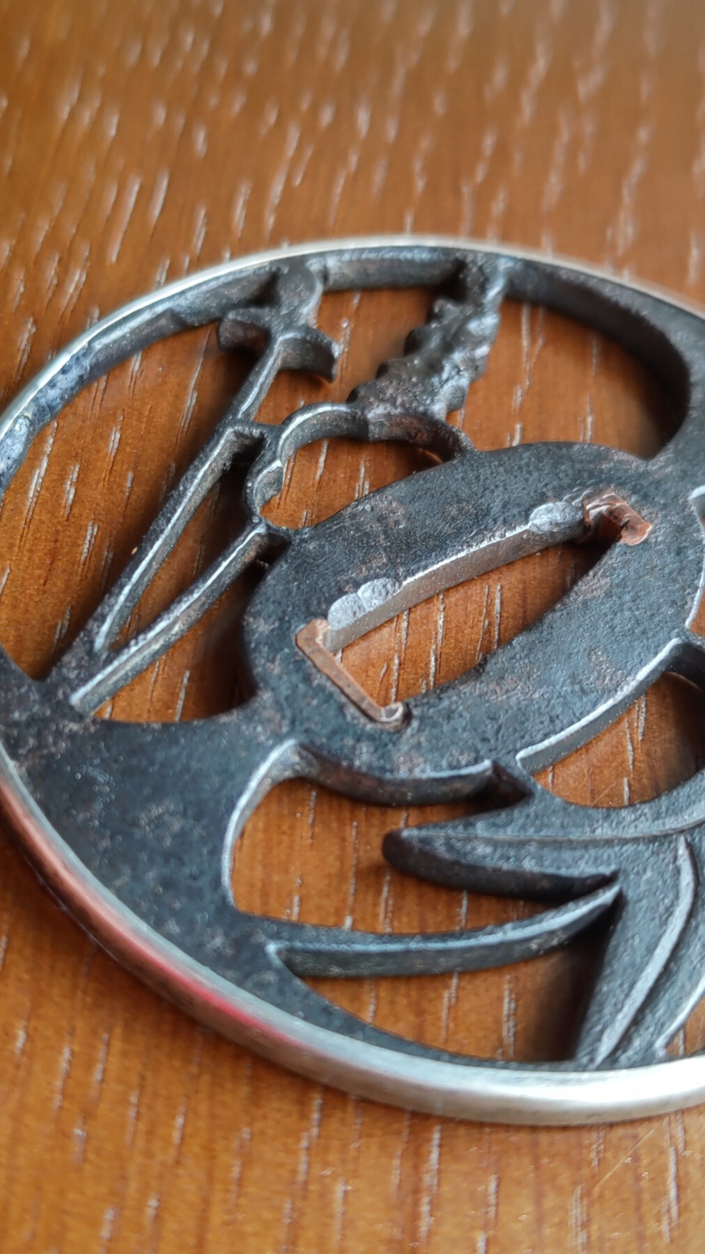

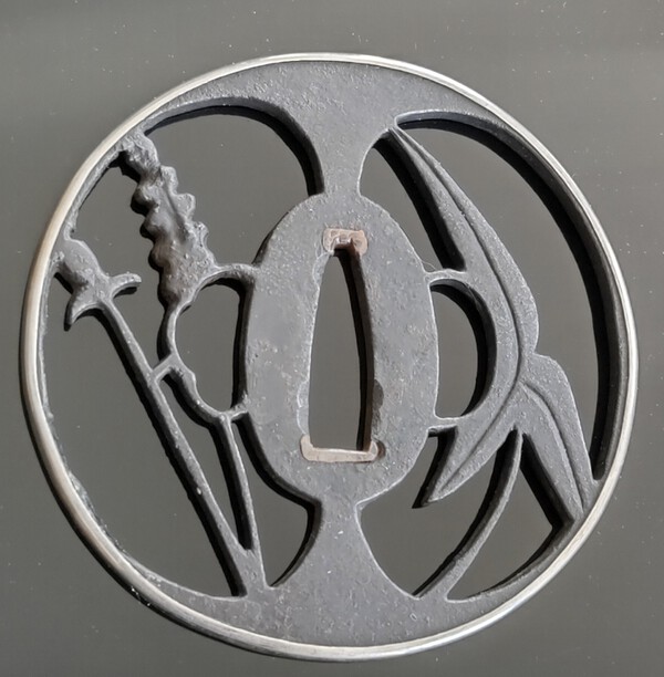

GoldenDrachen Posted June 7, 2023 Report Posted June 7, 2023 Hello gentlemen, Forgive me my stubbornness, but before I will make a final decision on this one, I would like to get more options on this tsuba. I have posted it before here At that time there were no much comments on it , just explanation on the motif. On the Facebook I have received suggestion that this tsuba is modern copy. My concern: why would one fit silver fukurin onto a copy? Are there obvious signs of this one being cast? If this a cast copy why there are no more similar ones on the market? I just really would like to get more options before it goes on iaito. Thank you in advance Vitaly Quote

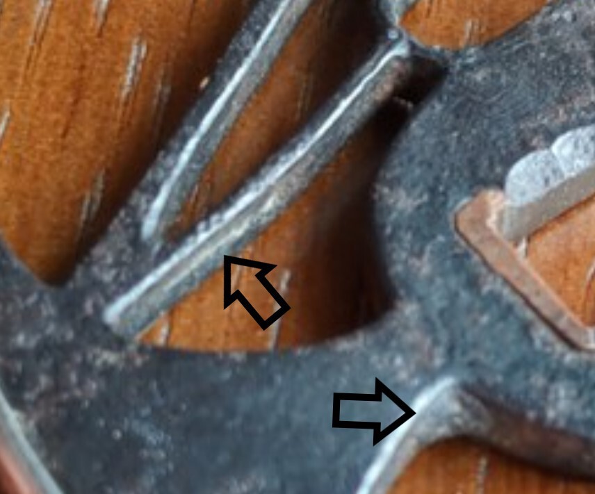

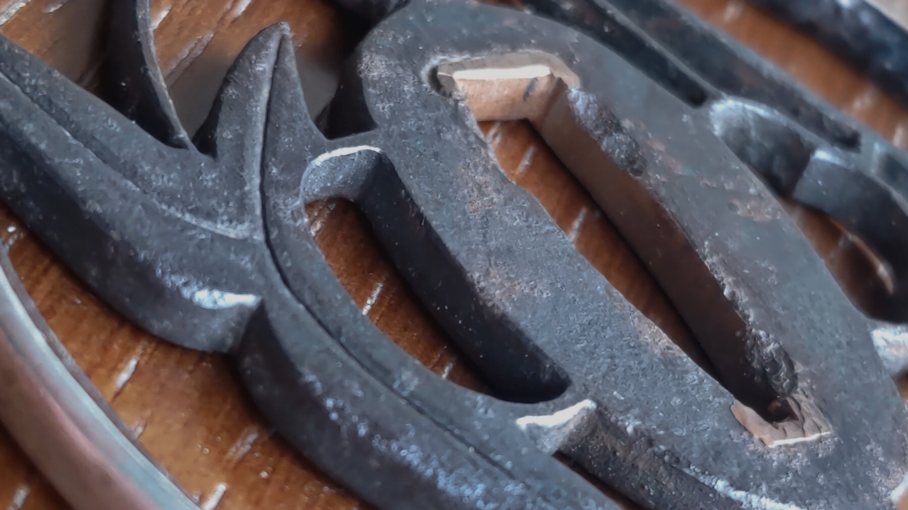

GRC Posted June 7, 2023 Report Posted June 7, 2023 Hi Vitaly, I'm leaning toward cast copy (99% certain)... but sometimes images can give the wrong impression though. I'm guessing the fukurin was probably added to: 1- dress it up a little and make it look more "fancy", and... 2- maybe hide some casting flaws on the outside of the mimi (because the inside of the mimi also looks pretty messy in one area... so maybe there are more flaws elsewhere) In the zoomed-in image below, it looks like there's a clear mid-line seam along the thin sukashi, and the "inside corner" of the sukashi at the bottom right looks too "globby", rough and irregular to have been done by a chisel. There are other areas that show a hint of a mid-line seam but they are darker and less focused. ...and this part is too messy... looks like all of it is best explained by casting flaws (rather than corrosion of some kind). All the "bevels" along the majority of the sukashi edges also makes me think this was cast. ... and of course, this is all just my opinion. 2 1 Quote
rematron Posted June 7, 2023 Report Posted June 7, 2023 Hi Vitaly. I am a novice. This does not look cast to me. I wouldn't expect the sukashi to be quite as thin/fine on a cast specimen even though the carved details are a bit simple and unrefined. And, along with you, I find the addition of fukurin (although I believe these are copper) to be good evidence of a quality piece. I could absolutely be wrong. The iron underneath the mimi on the kogai hitsu-ana side does look a little suspect, but that could easily be a forging flaw. The nakago-ana looks crisp. Though, there is sort of a 'muddy' aspect overall. That said, this is a piece I personally would shy away from because of there being any doubt. I'm very curious to see what others more knowledgeable than me say. 1 Quote
Larason2 Posted June 7, 2023 Report Posted June 7, 2023 I think it could be cast. There's just too many midline defects in the cutouts that look like they are flash. Also, there is the appearance of hammering along the edge of the nakago ana, but they didn't actually move any metal in. The attention to detail is also lacking, uneven cutting around the cutouts, most of the piece is in one plane, poor definition on the plants. The bevels on the cutouts are all different and don't look intentional. The gap around the bottom sekigane doesn't make sense - usually cutouts are square, and the copper is forged into it perfectly. The mimi doesn't have facets, which is a sign it was hammered. So overall, it is not a high quality piece. If you like it though, it could be a good piece for you! 1 1 Quote

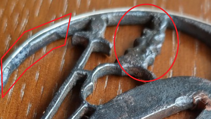

Spartancrest Posted June 8, 2023 Report Posted June 8, 2023 Some sloppy workmanship with it, that inside rim is really odd. The circled area is poorly defined. There may be an explanation on the lack of metal moved into the nakago-ana - if the tagane-ato was old and the hole was filed wider later? 4 1 Quote
Bugyotsuji Posted June 8, 2023 Report Posted June 8, 2023 Could it have had some fire damage on the left, where the mimi is very thin, and is there even evidence of a mimi crack/break near the bottom of Dale's red box above? If so, that could explain the necessity for a fukurin, in an effort to save the tsuba? 1 2 Quote

Kurikata Posted January 26, 2024 Report Posted January 26, 2024 Dear all, I am the new owner of this omodaka tsuba sold by Vitaly. It has suffured a lot that's not the question. Definitivly it is an end of Edo tsuba, not cast, having suffured from fire and restaured with a fukurin to reinforce the mimi. It makes me think of kintsugi consisting in reparing with gold lacquer precious poteries. I like it very much! 1 Quote
