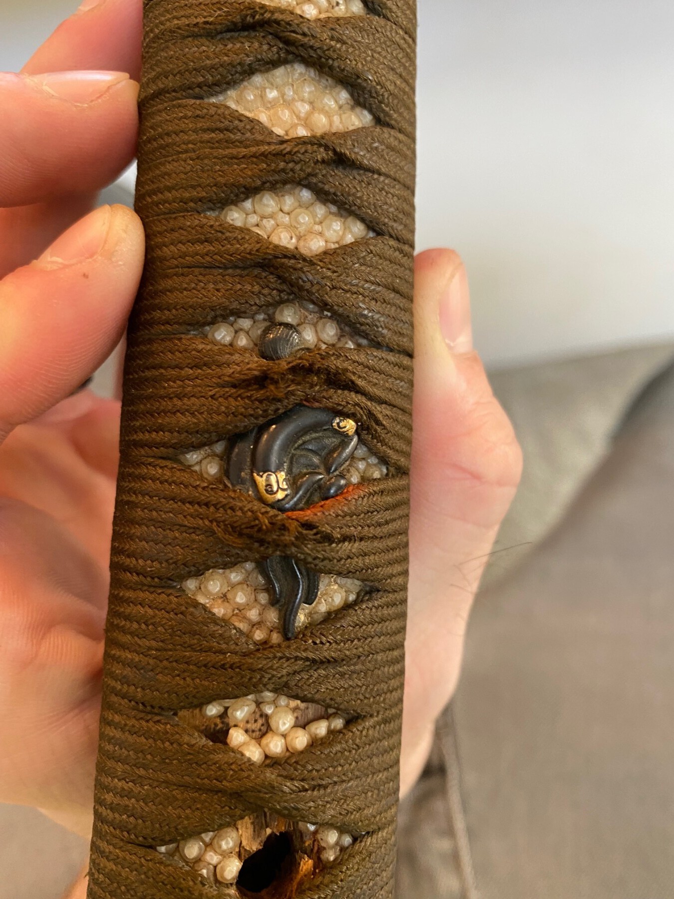

Scogg Posted June 6, 2023 Report Posted June 6, 2023 Hello, it's been a while since I've posted. I recently acquired a wakizashi in koshirae with kiri-mon fuchi and kashira. And a WW2 saya I think I can't for the life of me determine what the menuki is depicting. It looks like someone in the past had the same issue, because the Ito is a little frayed and loose around them. I can move it a little, but fear damaging a koshirae set that I enjoy I am a beginner and novice, but have been reading and studying. I am finally grasping some of the vocabulary, and getting better at identifying features Can you tell what the Menuki is for me? Quote
Spartancrest Posted June 7, 2023 Report Posted June 7, 2023 (edited) I may be way off target here but it looks like a fan and - - something in the background. A strange looking fan for sure but that is the impression it gives me. Closest I can find are these - https://www.pinterest.com.au/pin/374854368970587509/ I would be surprised if this is correct. But someone has to start the search ! Could the "thing at the back" be a daikon? Like in this set? https://www.jauce.com/auction/p1044391226 Edited June 7, 2023 by Spartancrest new data Quote

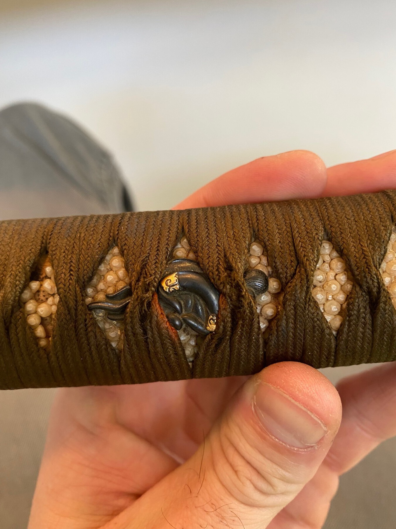

Scogg Posted June 7, 2023 Author Report Posted June 7, 2023 That Daikon looks awfully close! Especially how the end of the 'leafs' are different. One side theres three "tendrils", the other side there are two Thank you for the input. Here's a couple more photos, but I'm not sure if they will reveal anything new. Thanks again! Quote
Bugyotsuji Posted June 7, 2023 Report Posted June 7, 2023 Only just seen this so apologies. They look like good-quality 四方手 'shiode', and kura horse saddle/harness behind. There are four on a saddle at the four corners, which gives them their name, 'four-direction hands/handles', the pronunciation softened over the centuries from shi-ho-te. 3 1 Quote
Spartancrest Posted June 7, 2023 Report Posted June 7, 2023 (edited) Thanks Piers with that information I found another menuki pair - https://ginza.choshuya.co.jp/sale/koshirae_kanagu/menuki/menuki_index.htm see m057 They are sold but the description is "Horse harness (four hands) Menuki unsigned red copper ground engraving Color table: 39.1mm Back: 37mm This is a theme often seen in the works of the Goto family, which went up in the era of high-quality" Edited June 7, 2023 by Spartancrest image missing 3 1 1 Quote
Scogg Posted June 7, 2023 Author Report Posted June 7, 2023 Thank you Dale, and Piers so much. That is spot-on exactly what it is! This is great for my notes Cheers, and thanks again! Ya'll on this forum never cease to amaze me Quote

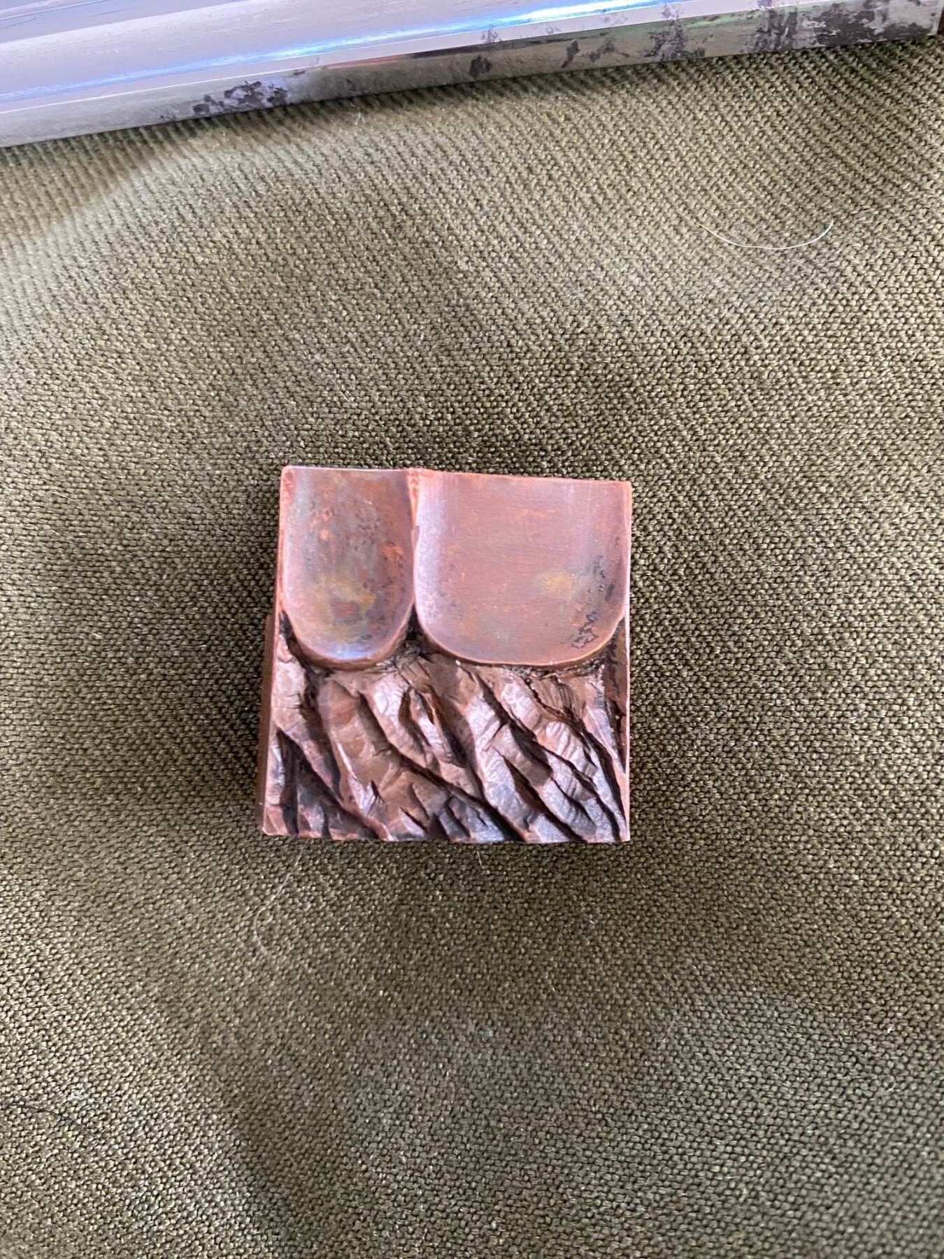

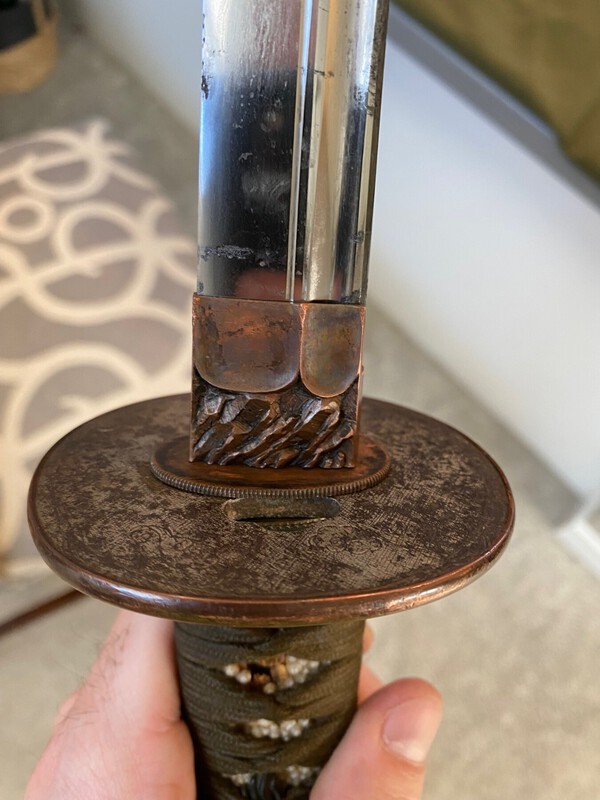

rematron Posted June 7, 2023 Report Posted June 7, 2023 Off topic, but I really like that habaki! 1 1 Quote
Scogg Posted June 7, 2023 Author Report Posted June 7, 2023 5 hours ago, rematron said: Off topic, but I really like that habaki! Thank you! I really like it too Maybe in a while, after some photography practice, I will post post photos of the whole koshirae set 2 Quote

Graybadger Posted June 17, 2023 Report Posted June 17, 2023 I have a pair of menuki in this same design motif, shown in the attached photo. I also saw another pair sell as lot 133 Sotheby's London on March 30, 1994 from the RB Caldwell collection (sold £782=$1157 at that time). I have seen these described as falconry jesses for "takagari" on several occasions, which I accepted until now. The photo of the set shown currently for sale include a horse riding crop. I now concur with the identification as 四方手 'shiode' horse saddle parts. 2 Quote
