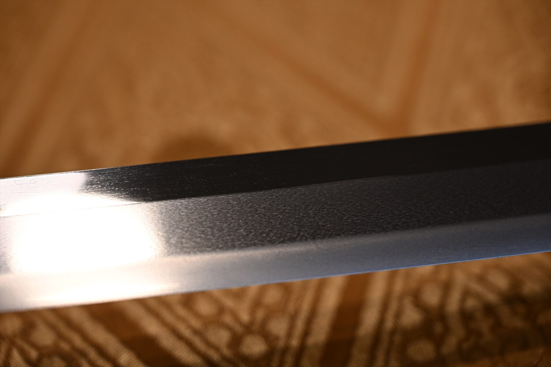

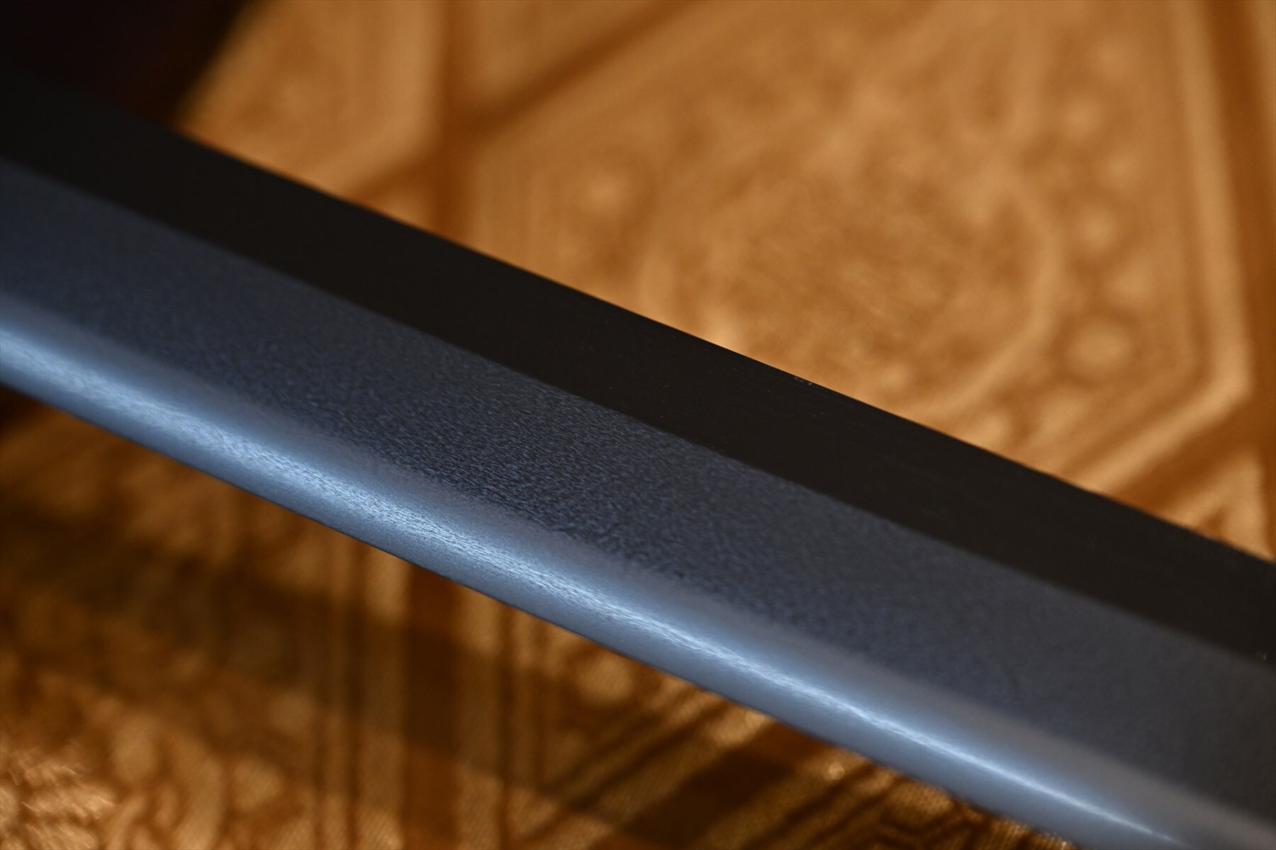

Athoul540 Posted January 1 Report Posted January 1 Not sure if it helps but here is soon to be my 8th Gen Tadayoshi (currently being outfitted in Japan). It has NBTHK TH papers as well. Personally I find the hada to be mesmerizing. 4 Quote
2devnul Posted January 2 Author Report Posted January 2 @Athoul540 Hi, thanks for sharing. It helps to please the eye! I think you should open a new topic and share more pictures once you receive the sword. I envy you! Quote
