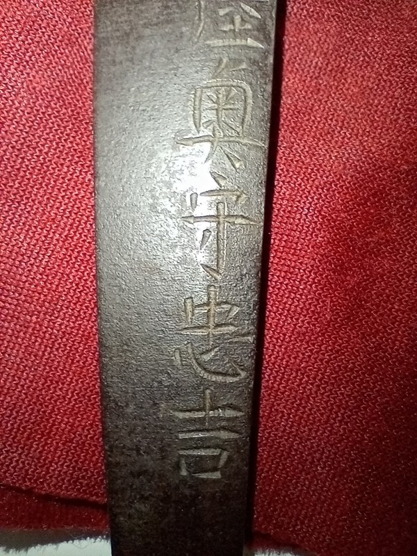

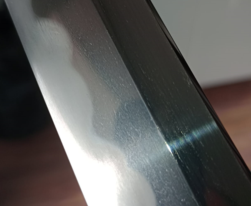

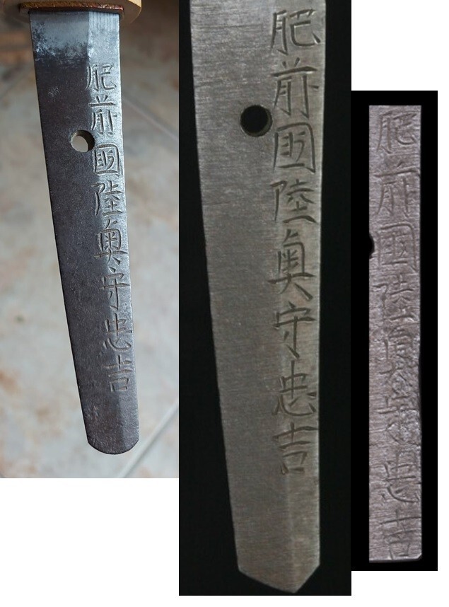

2devnul Posted June 30, 2023 Author Report Posted June 30, 2023 Hello, Interesting finding IMHO. This hizen-kuni-mutsu-kami-tadayoshi Daisho from AOIJapan website: https://www.aoijapan...utsu-kami-tadayoshi/ If you look at wakizashi's mei you will see that it is worse quality (speaking about perfect mei) then the one on mine. Although hamon is suguha style (mine is gunome) other attributes (especially hada) looks very similar. http://www.aoijapan....2014/14356-1-sho.jpg Waki has: NBTHK Hozon paper and NBTHK Tokubetsu Kicyo paper. Quote
2devnul Posted June 30, 2023 Author Report Posted June 30, 2023 To close the topic from my end. I am convinced that if sword would be in possession of Mr. Roger, or posted here by someone with 'high collector rank', or sent to Shinsa by AOI (Oyabun Tsuruta) then it would be 100% Mutsu Tadayoshi. Since it is in possession of 'low rank collector' like me, then it must be gimei. Thank you again everyone for your valuable comments and sharing the knowledge. Quote

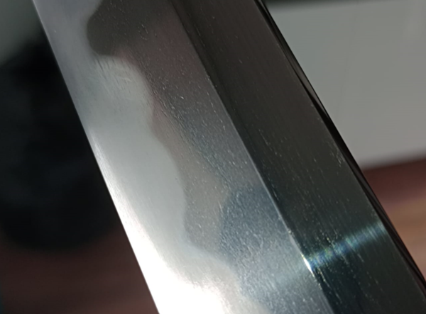

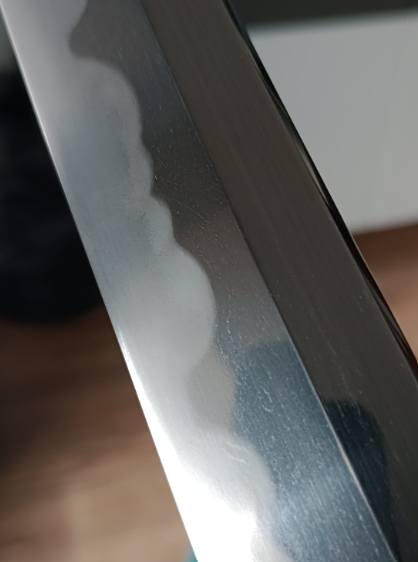

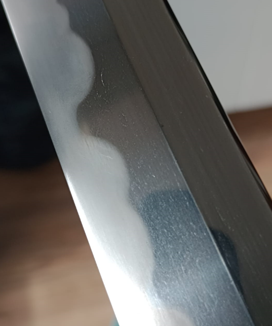

2devnul Posted July 7, 2023 Author Report Posted July 7, 2023 Hello, Thanks Carlos. I think you might be right, I'm taking this personally. I just can't understand one thing. Have a look a this hamon/hada and please explain. Why a swordsmith would make gimei from such masterpiece blade instead of signing his own name. Spreading his own fame. Even with all that 'mei' doubts, when looking at the blade I'm convinced that it's Tadayoshi's work. Quote
mywei Posted July 7, 2023 Report Posted July 7, 2023 There's no need to take this 'personally' imo, it's not an attack on your person or character after all. When you ask for opinions from others there will always be those that you disagree with, unless you just want everyone else to validate your pre-formed opinion on the matter. Unfortunately with really big names like Mutsu Tadayoshi in good recent polish, you have to wonder why it doesn't have papers? You would expect any previous owners to have attempted a shinsa especially if they went to the trouble of polishing it. This does looks like a good blade with konuka appearing hada and an active gunome hamon but questions will always remain in its current state. The signature is not a 100% match to papered Mutsu and the nakagojiri seems different to other ubu examples? Without seeing it in person no one can really say for sure. I would suggest the only to put it to bed would be to send it for shinsa. My two cents 9 Quote
paulb Posted July 7, 2023 Report Posted July 7, 2023 Re why would anyone produce a gimei. Basic answer is to survive. For example Naotane and Naokatsu were both highly regarded Shin-Shinto smiths who made copies of earlier work but also, according to some authorities, were not above making copies and putting a false mei on them. They did what the market asked for to survive. Re your blade, I re-read what I and others had written and I didn't see anything that criticised the blade, quite the opposite, most prefaced their comments with the fact they thought it was a good piece. No one here has sufficient confidence (or at least they shouldn't) to say whether a blade is genuine or otherwise. All they can do is look at all the elements they can see and express an opinion. that is very different from seeing it in hand and people are, quite rightly in my opinion, cautious. The only real way to progress this is to submit it to shinsa. I think it is a good sword. Roger R is the go to person in the west for Tadayoshi and if he believes it could be right his opinion is worth far more than mine or anyone else's here. However I do think it valid to ask why a blade in such good condition has come out of Japan without papers. Was the seller ignorant of what they had? had it been submitted and failed? we will never know but until you submit it for shinsa there will always be a niggling doubt. Otherwise accept it is a nice work and enjoy it for that. 7 1 Quote
Bazza Posted July 7, 2023 Report Posted July 7, 2023 A toad, even a handsome one, is not a frog no matter how much thinking might make it so. Adam in Poland, this sword needs to be seen by the NBTHK in Tokyo, nobody else, anywhere else. Myself and others on this Board have papered Hizen Tadayoshi school blades - shodai, nidai,sandai, godai, etc. I have a possible Mutsu wakizashi, a stout blade with a 'presence', but it needs a polish AND a Shinsa before I can say anything else about it. Until you have an NBTHK paper the maker of your sword is an open question and the 'rank' of the presenting collector has nothing at all to do with this process. As Paul said, accept your sword as a nice work and continue study. Line up some Tadayoshi in UK collections and go to England to study them. Best of an essential ingredient in collecting - luck plus study... BaZZa. (Melbourne, Australia) 6 Quote

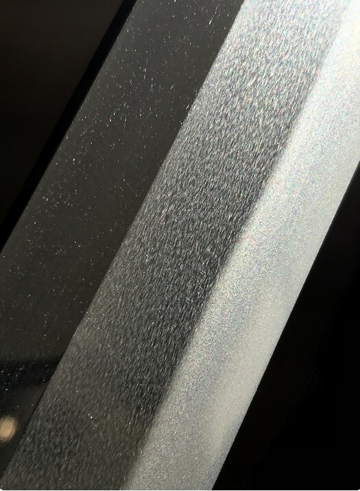

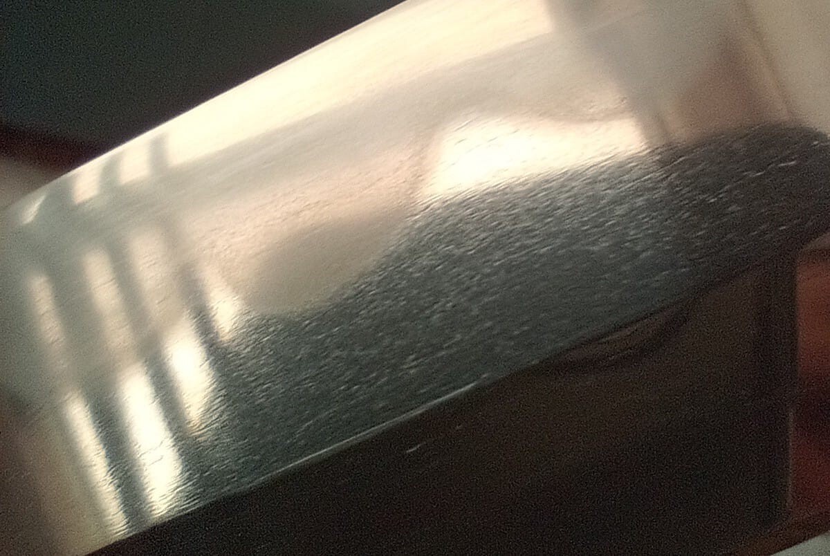

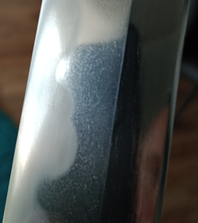

2devnul Posted March 1, 2024 Author Report Posted March 1, 2024 Hello, Please find below my attempt on capturing beautiful Hada of Tadayoshi's workshop. Quote
2devnul Posted March 1, 2024 Author Report Posted March 1, 2024 On 3/1/2024 at 10:29 AM, Rivkin said: I suspect it might be not Hizen. Expand I'm still open for any comments/arguments. Can you please share why the doubts? Quote

2devnul Posted March 1, 2024 Author Report Posted March 1, 2024 On 3/1/2024 at 10:34 AM, Soshin said: Not an expert, but the hamon looks quite different than what I have seen of this swordsmith's work. I wish I could get an unobstructed view of the ji-hada. Expand I wish I could show you the sword in person but that will be difficult/impossible. Unless you plan to visit Poland I can try to make other pictures if you can give me a hint (example picture) of what you are looking for. Quote

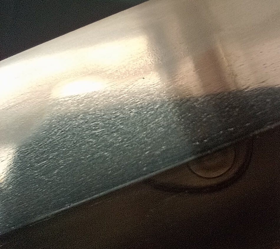

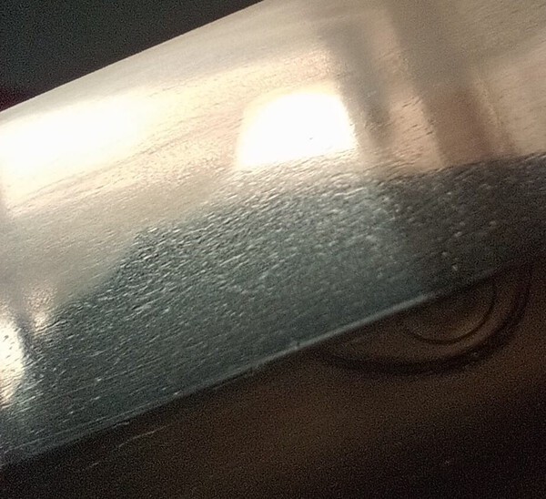

Rivkin Posted March 1, 2024 Report Posted March 1, 2024 Polish is a bit heavy on hadori, but generally the first class Hizen hada is very repeatable, tight with itame's nie being like a dot or protruding a bit along the blade... This one is rougher, wider, more spaced, and non-uniform. Its still nice, but not to the same point. Weaker Hizen smith is an option, but so is a better than average shinto smiths who was inspired probably by Hizen Masahiro. 2 Quote

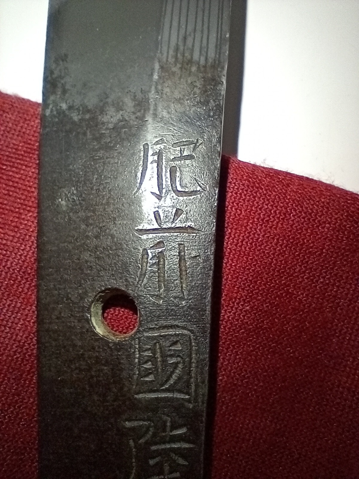

Soshin Posted March 2, 2024 Report Posted March 2, 2024 On 3/1/2024 at 10:43 AM, 2devnul said: I wish I could show you the sword in person but that will be difficult/impossible. Unless you plan to visit Poland I can try to make other pictures if you can give me a hint (example picture) of what you are looking for. Expand I found some old photo of the nakago of my Hizento wakizashi that later was professionally polishing in Japan. It is signed on the tachi side not the normal katana side of the nakago: "Omi Daijo Fujiwara Tadahiro (近江大掾藤原忠廣)". It was later papered to Hizen Tadahiro or something similar by the NBTHK. Sorry I don't have any photos of the NBTHK papers or the sword in polish. I remember the workmanship and characteristics of the steel itself of my wakizashi being vastly different than your sword from looking at photos after the polish that was sent to me by the new owner of the sword who paid for the polishing and appraisal at the NBTHK in Japan. 2 1 Quote
2devnul Posted May 20, 2024 Author Report Posted May 20, 2024 Hi, I'm adding attempts of capturing Hada. Quote

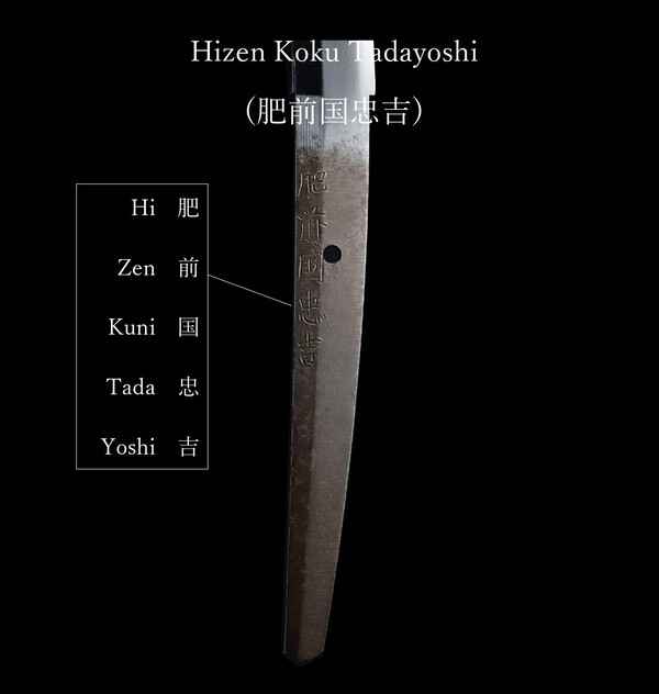

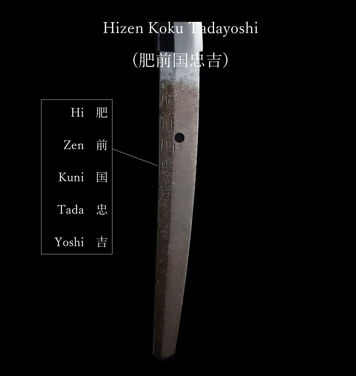

Bosco Posted October 23, 2024 Report Posted October 23, 2024 Have a look at this two from the 8th generation of Tadayoshi, sold from Samurai Museum with NBTHK certification. Both mei 5 characters look tottaly different even it was signed by the same person. So saying a mei is gimei because of the signature is baloney. One could be made when he was young and one could be made when he was older ( or drunk , sick ... ). 1 1 1 Quote
