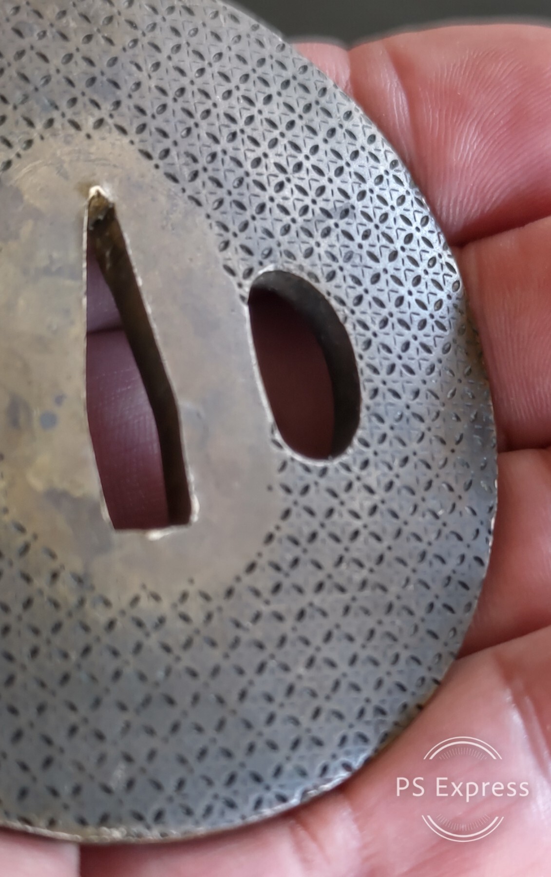

GoldenDrachen Posted June 2, 2023 Report Posted June 2, 2023 Hello gentlemen I have been looking at this design for a while now. Like it very much. Especially ones with signatures and seal. Unfortunately all tsuba that I have seen so far for sale were in poor condition. I came across if this one, but as we can see mumei. Would this one be from the same workshop ( or factory )? Regards Vitaly Quote
MauroP Posted June 2, 2023 Report Posted June 2, 2023 Hi, it doesn't look iron (as far as I know most Tetsugendo tsuba were made in iron) 1 Quote

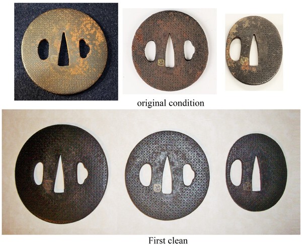

Spartancrest Posted June 2, 2023 Report Posted June 2, 2023 (edited) Yes as Mauro has pointed out, most are in iron, still I think yours is genuine - might even be much rarer. It is a style I like very much. I have seen a few where the signature has been erased - I don't know why, so not being signed is just a distraction - if it was meant to deceive they would have included a fake signature I am sure, certainly easier to do on soft metal? The pattern on the rim edge convinces me it is good. [at least you don't have to watch out for rust like my three examples !] This one is in not too bad a shape - [some wear on the right hand side] bit of a clean would help - https://www.jauce.com/auction/q1088007643 Edited June 2, 2023 by Spartancrest new data 1 Quote

GoldenDrachen Posted June 2, 2023 Author Report Posted June 2, 2023 Hi @MauroP thank you for the comment! I really hope that key word in here, is "most" Dale! @Spartancrest Thanks a lot. As always very elaborate comments and useful information. Hi Piers! @Bugyotsuji I have seen this word in conjunction with above design description. Now I know its meaning. Thank you! 1 Quote
