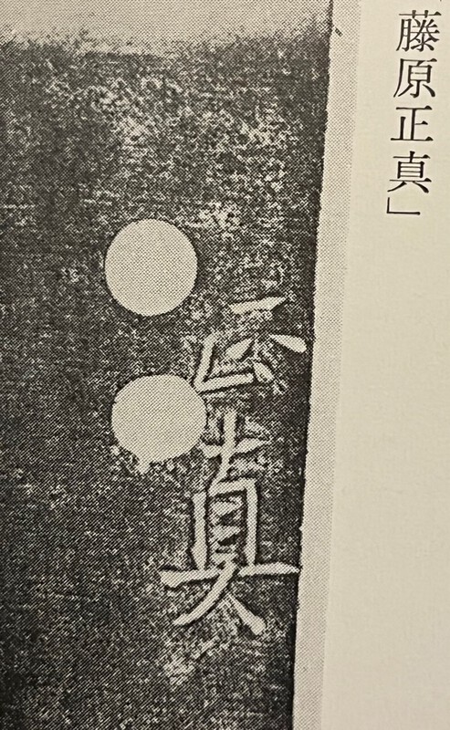

Ray, another site translated this as Masanao. Could this be both or did they make a mistake?  Just wondering what direction to go in researching the name.
Thanks again,
Howard Dennis
Howard,
I can’t make out if the last character has the two little “foot strokes”. Nao “直” and Zane ”真“can sometimes easily mixed up.
So if the two foots are present, than it’s Masazane….
The only example of Masanao in my old copy of Fujishiro, Shintō, shows no photograph.
On the other hand there are some Masazané examples shown in Fujishiro’s Kotō volume.
What do you think?
Thanks again for all the help. To be honest I didn't invest in books about signatures because it was learn about the swords and have enough money leftover  to actually buy some OR just own books. So let me see if I'm understanding what you all have posted. In order for the kanji to be Masazane the upper newer hole has to have taken out the righthand side of the bottom horizontal stroke AND the lefthand "foot" stroke. Am I seeing that correctly?
Howard Dennis
