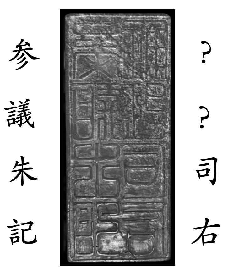

Brian Posted May 26, 2023 Report Posted May 26, 2023 I think this one is asking a bit much, but here it is anyways. I was emailed these pics by an elderly gent who purchased this 'seal stamp' from Japan. Apparently it is on the way to him. I don't even know what this is exactly. He was asking if it is possible to translate the seal. I'm not sure if this is Chinese or Japanese, modern or old. On the larger pic of the stamp itself, I have flipped it horizontally so that it shows as it would if it were used. Anyone have any ideas at all? This is waaaay out of my comfort zone, and I always expect stuff like this to be modern Chinese curios. Quote
Nobody Posted May 26, 2023 Report Posted May 26, 2023 The flipped image looks upside-down. Here is a rotated image. 3 Quote
Brian Posted May 26, 2023 Author Report Posted May 26, 2023 Fantastic work, thanks! That is a LOT easier to see. Quote

xiayang Posted May 28, 2023 Report Posted May 28, 2023 8 hours ago, Larason2 said: 縯寞靻礐 Fine horse startles, leather will harden 呂앵臦遯 tremendous noise, wealthy person escapes. I don't think that is quite correct. The seal script variants of those characters or the ones in your image don't look like the characters on the seal at all (and you've even got a Hangul syllable in there too). Check for yourself on shufazidian.com (and select "篆刻"). Also, I'm fairly certain your image is upside down. Did you use OCR for this? Moriyama san's image has the correct orientation. The calligraphy is not the prettiest, but I believe I've managed to identify six out of the eight characters: ? ? 司右参議朱記 The first two characters are very likely a personal name, 司右 is a court official's title (literally translates to something like "right manager"), 参議 can be translated to "councillor" and 朱記 is "red seal". 5 2 Quote
k morita Posted May 28, 2023 Report Posted May 28, 2023 xiayang, you are great! ?? on the pic,I think it's 通 政 通政司右参議朱記 The stamp was Possibly a senior official of the Qing dynasty China.(?) what do you think about it. 4 1 Quote
Brian Posted May 28, 2023 Author Report Posted May 28, 2023 Wow...you guys are amazing! Carlos, great effort. But Jan and Morita san....wow! Incredible effort. Quote
xiayang Posted May 28, 2023 Report Posted May 28, 2023 51 minutes ago, k morita said: xiayang, you are great! ?? on the pic,I think it's 通 政 通政司右参議朱記 The stamp was Possibly a senior official of the Qing dynasty China.(?) what do you think about it. Yes indeed, that's it! 通政司 (Tongzhengsi) was a sort of liaison office between the emperor and various ministries in the Ming and Qing dynasties that dealt with things such as payrolls and proofreading. So it's not actually a personal seal as I first thought, but rather the seal of office of the "Tongzhengsi right councillor". I can't say whether it's a genuine antique item or a later reproduction though, that's not my area of expertise I'm afraid. 5 1 Quote
