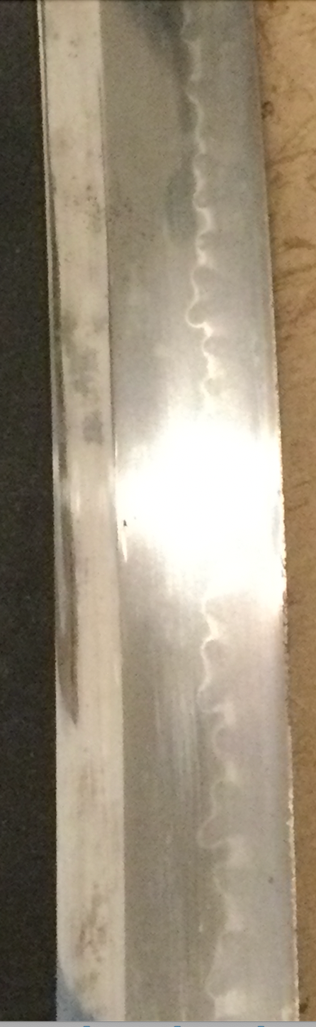

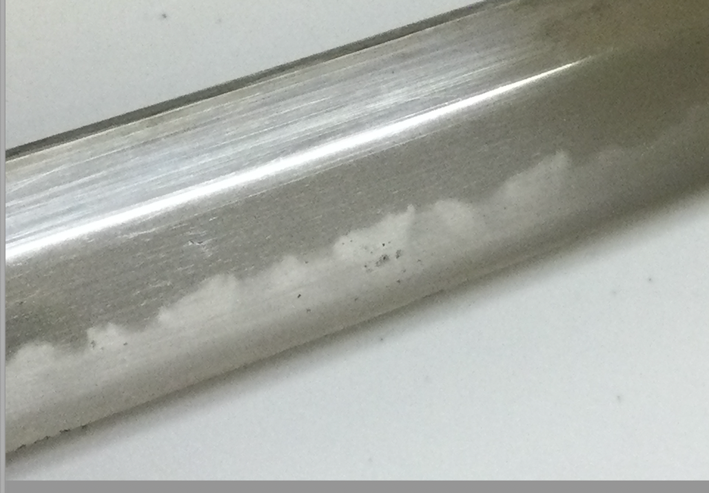

John C Posted May 23, 2023 Report Posted May 23, 2023 Hello: This is from an unstamped, undated type 98 (Ando Kanemoto). I know statistically this is probably oil quenched, however I do not have the experience to know for sure. My pictures are crap but I think I can see slight ashi and ko-nie. But I also think I can see slight dark streaks of oil quenching. What do you guys think? Regards, John C. p.s. Did I mention my pictures are crap? Best I could do. 1 Quote
Brian Posted May 23, 2023 Report Posted May 23, 2023 I've had one very similar. I came to the conclusion it was a high end Showato. Basically one of those forged and folded, maybe even from good steel. But oil quenched or something else preventing it from being fully traditionally made. Not sure yours is the same, but it is indeed very similar. Nice looking blade. 1 Quote
robinalexander Posted May 23, 2023 Report Posted May 23, 2023 John a couple more (crap) pictures on different angle might help. Rob PS....I've always found oil vs water hamon an interesting if not perplexing subject. Quote

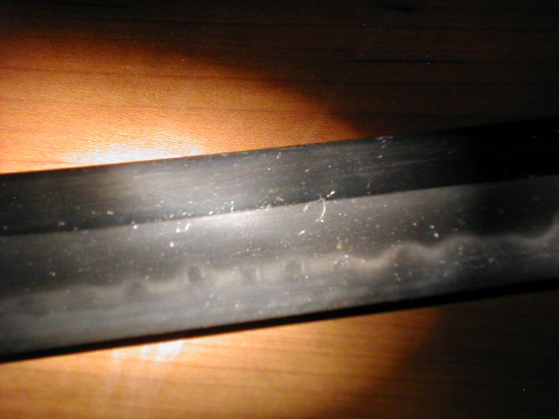

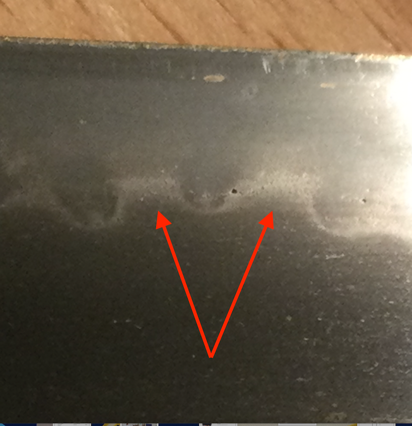

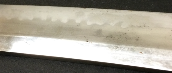

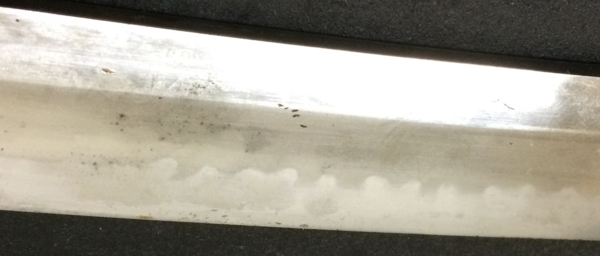

John C Posted May 23, 2023 Author Report Posted May 23, 2023 On 5/23/2023 at 10:26 AM, robinalexander said: John a couple more (crap) pictures on different angle might help. Expand Thank you for the responses. A couple more. In one, I think I can see the tell-tale dark line of an oil quench but not in the other. Hada seems dense as well, so I am leaning toward oil quenching. John C. Quote

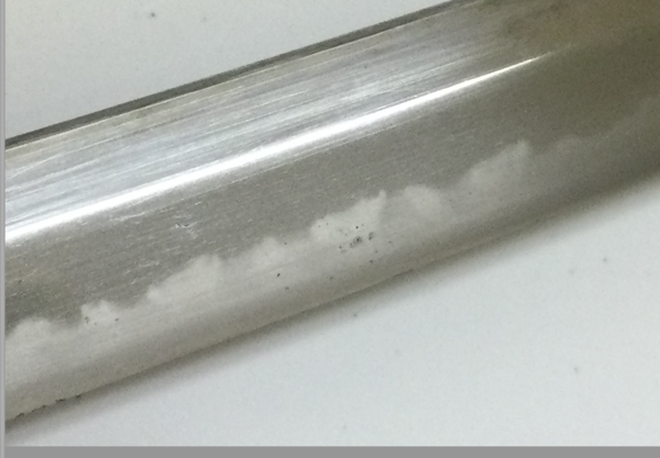

robinalexander Posted May 23, 2023 Report Posted May 23, 2023 Hi John, Nice hamon. I would ere on the side of water quenched (probably a game call) . While I cant make out any hada or nei, your hamon is more cloud-like and irregular and without the obvious tell tale darker spots that appear on oil quenched blades (as per example immediately below)... but pls don't 'put hour house' on my opinion. Quote
PNSSHOGUN Posted May 23, 2023 Report Posted May 23, 2023 Hi John, from the first picture it does look to be oil quenched with the distinctive dark spots in the tips of the Hamon. For reference this shape looks to be Yahazu Midare. 1 Quote
robinalexander Posted May 24, 2023 Report Posted May 24, 2023 Just to clarify. The first picture above is a random oil quenched I posted just to highlight the difference with John C's blade which are oriented/shown in bottom two pics. Quote
John C Posted May 24, 2023 Author Report Posted May 24, 2023 Thank you both for the information. A good polish would probably settle the question, however not on a showato. In the meantime, I'll look for a spot on the blade that may provide something definitive. Thank you all again, John C. Quote
mdiddy Posted May 24, 2023 Report Posted May 24, 2023 In addition to the distinctive dark spots in the hamon that John mentions (to my eye, they are like lightbulbs at the top of gunome formations), you can also look for nie in and around the hamon. The showato rarely (if ever) show nie while a lot of the gendaito do. Even good gendaito done in nioi deki may show traces of nie where the hardening was inconsistent in a spot or two. Quote

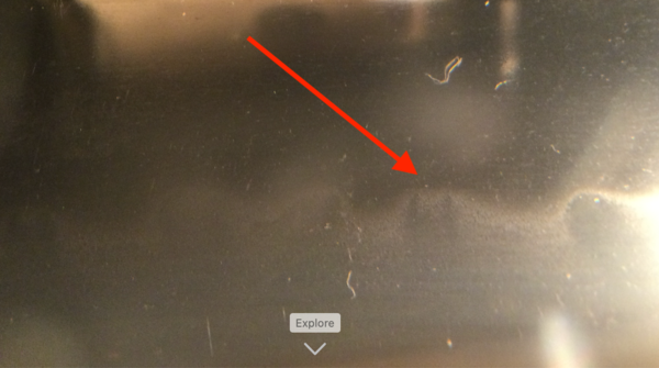

John C Posted May 24, 2023 Author Report Posted May 24, 2023 On 5/23/2023 at 10:26 AM, robinalexander said: John a couple more (crap) pictures on different angle might help. Expand Rob: I was able to attach a loop to my crap camera and found some interesting areas. Looks like martensite crystals, however I don't know if that necessarily indicates water quenching. What do you think? John C. Quote
mdiddy Posted May 25, 2023 Report Posted May 25, 2023 On 5/24/2023 at 9:32 PM, John C said: Looks like martensite crystals, however I don't know if that necessarily indicates water quenching Expand It's at least a positive sign. Look also to see if there is ji nie and any other hataraki in the hamon. Look also to see if/how the nie pools along the nioi guchi. Quote
