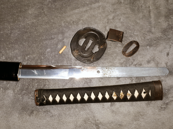

I picked up this gunto. I have owned several in the past, currently own just this one.
The silver foiled cat scratch habaki made me think it was going to be a "decent" i.e signed blade. Well, I was wrong. Mumei, showato blade with what "looks" like a FAKE polished in hamon. And a weird "star" punch mark under the habaki.
The Tsuba has sekigane to fit the nakago. I have never seen this on a gunto. The remaining seppa(one missing) are all scratched with kanji that matches the tsuba and fuchi. Seppa are NOT for this nakago as well, but match the original nakago-ana of the tsuba(before sekigane)
Not pictured is a wood saya that is missing leather cover, has single hanger and metal collar with "tab" for locking chuso.20230522_194023.thumb.jpg.164bde827793c0a0b03fc4918e6863ee.jpg20230522_193956.thumb.jpg.c72364c2a0e0cfdfbbb8b66584baf2d9.jpg

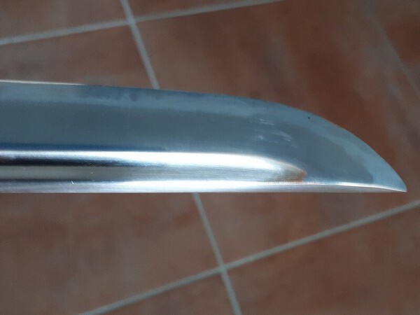

Blade looks like some sort of Murata-To process sword, oil forged with cosmetic Hamon applied. Can't speak if the mounts are original to the sword without more pictures, however the Tsuka and Tsuba are the early pre 1940's style.
Thanks for the reply. Murata-to makes sense, and it crossed my mind as well. It has rust pitting in spots, but is flawless besides that. It's a very lightweight blade also.
The fittings are what made me question if it was pieced together, as like you said I always thought the pierced tsuba was an earlier design.  And why the seppa, fuchi and tsuba nakago ana are all a match, but are larger than the tsuka and nakago threw me off. I would have assumed they would be fitted to the blade The tsuka is definitely fit for the blade.
If it didn't have sekigane applied to the tsuba I would have immediately thought postwar replacement. 20230522_214036.thumb.jpg.7eefe835f361c7b14a58dc96c041ccce.jpg
Edit: When putting the tsuka back on after taken the above photo I noticed the end of the nakago is scratched with the same kanji. Hard to see, but is there. So, I don't know what to think?
Not sure if it is the case here, however I have seen "0" marked as an "X" on fittings. So 720? Does that number show up anywhere else? Any roman numerals on the edge of the habaki (VII II X).

Wow, crazy John. I was curious so, dismantled it again and the habaki has something on it, but doesn't match the rest? It was pretty dirty but wiped it with alcohol and got this. Not sure what it means.
BTW, those "numbers" show up on the fuchi, tsuba, all seppa, and end of nakago(its partially rusty and hard to make out)

The overall shape of the nakago and alignment of the machi seem legit, though. Bohi looks okay. Not sure about this one.

To answer a few things. The samegawa is real and not the plastic type. The blade is razor sharp and not a tsunagi. The habaki is a perfect fit, the tsuka was definitely cut out for this nakago and the saya fits everything perfectly as well. The seppa and tsuba are the only questionable things to me.

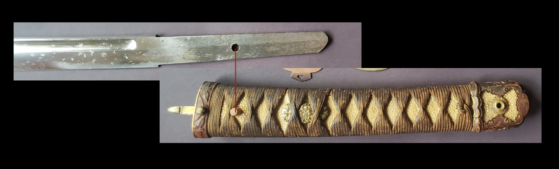

Regarding the unusual yasurimei, this looks to me the work of an engineer/ machinist, not a swordsmith. The longitudinal file marks are the result of a technique called 'draw filing', which is quite common amongst engineers. It leaves a similar, but much finer marks to sensuri. Possibly, this blade was made in a machine workshop?
Russ
1 hour ago, Bruce Pennington said:
Offset machi, common Chinese style.  Only seen on Type 95 NCO blades in WWII Japan.
Not mine, an example of a zohei-to blade I found in kyu gunto mounts. Pretty sure ita just the photos making it look like that.
