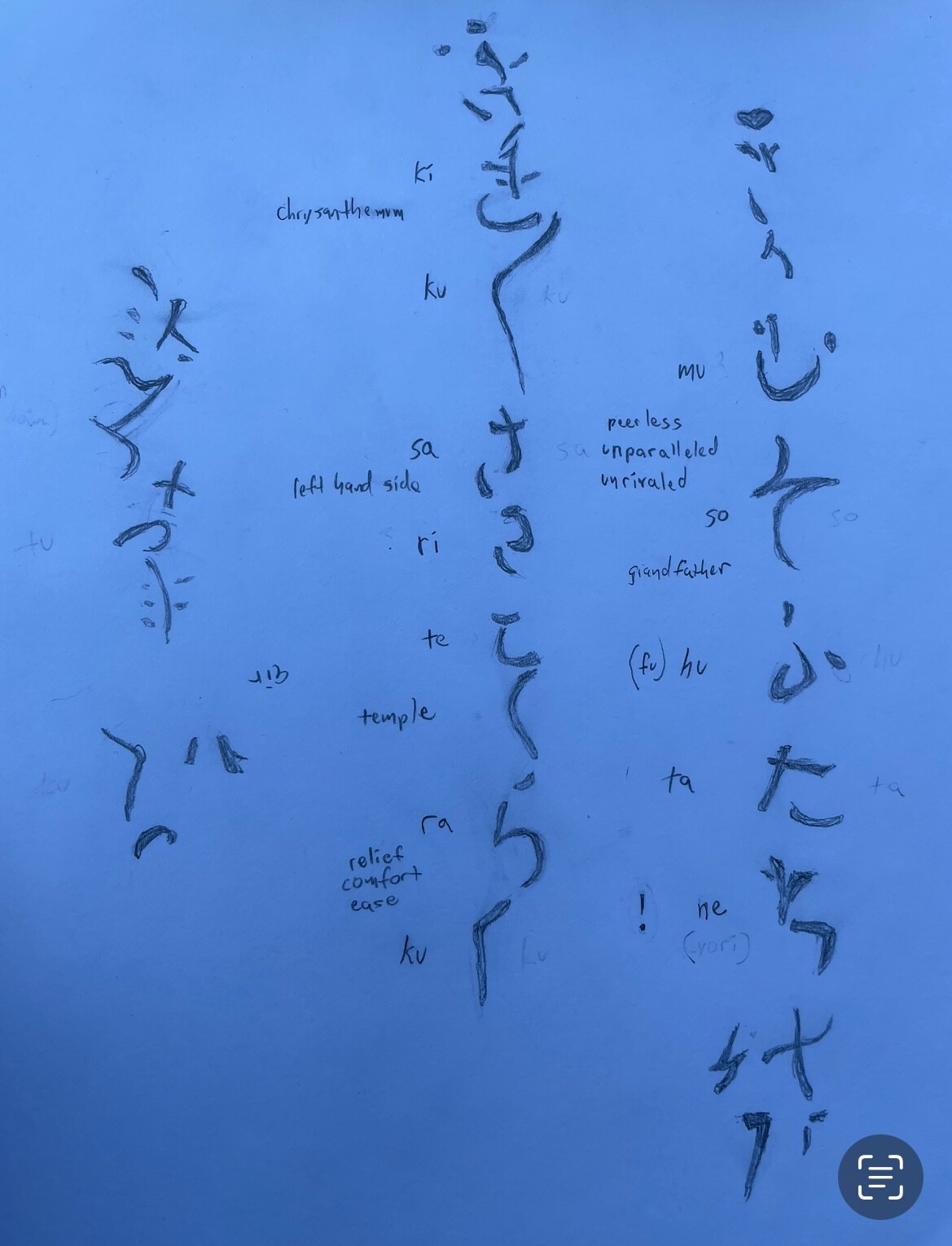

Hello, wonderful translators.  I naively really wanted to figure this out because it’s one of my favorites but I’ve hit a wall.  I did attempt to draw out the kanji so that I could discern it from the fine honeycomb background and I did some simple searches for words but I’m just not knowledgeable enough to pull this off.  Please, shed some light!
Some of the interpretations I made are grasping at straws and I think the third row of kanji is upside down on the tsuba?

I looked at this, but have to wave the white flag.
囗囗そふたち (むそうたち in modern Japanese - 無双? 夢想?)
さきさ囗ごくらく  (the one in red looks like the repeat symbol 〱, rather than hiragana く). The last one I don't know if its ごくらく (極楽paradise) or if that is just some kind of cognitive bias on my part).
and then the bit on the side たんだ? I don't know if that's part of the poem/saying, or something else. Unusual.
Sorry, very slim pickings from me, but maybe something will shake loose from there.
I can read the Nobuie signature...if that's any help ;-).

Oh, the theme is "nozarashi", skeleton of warrior left on the battlefield and exposed to the elements (you might already know this). A popular theme, and popular with Nobuie. There is an epic thread on this theme below. In fact, I think the writing on your tsuba may be an excerpt or an allusion to a poem found in this thread
切りむすぶ太刀の下こそ地獄 なれ、進めやー先は極 楽
Kiri musubu tachi
no shita koso
jigoku nare
susumeya-a
saki ha gokuraku
"To be cut under the long sword is hell, to advance forward is paradise" (courtesy @Henry Wilson)
The parts in blue are (I think) the ones written on your tsuba, with some slight differences

Thank you again, Steve.  I did see that thread and had looked it over a few times but (because my brain isn't wired for kanji yet :laughing:) I couldn't 'see' the correlating characters.  Thank you for pointing it out specifically.  I really appreciate your effort here.

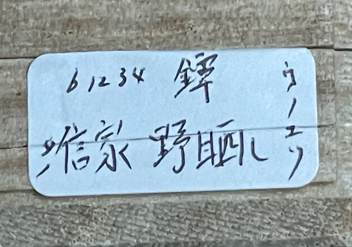

I forgot to ask about this writing on the box in the thread. The first characters look the same as the mei on the tsuba so I guess: Nobuie.  Could someone please verify that and tell me what the whole label says?  Also, the seller mentioned the name: Shinya Azuchi. Does that mean anything to anybody?
Maybe a student of Nobuie? Or a known ‘tribute’ maker? Thank you, people. :bowdown:
