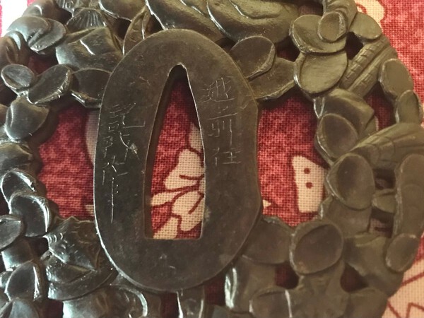

Second TSUBA seems to be signed ECHIZEN no JU KINAI SAKU. Sparrow TSUBA possibly has a signature beginning with HACHIMAN.....TSUNEMASA (not very sure, photos are less than excellent...).
The wave tsuba is rather tanto size. I have just taken pictures of the batch, I will post them in the tsuba section

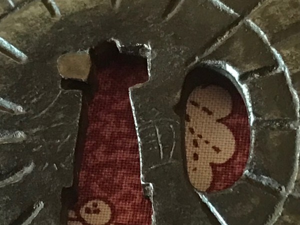

This is a photo I took of the mei of tsuba #3.  Does it read:
KONOBU MUNEMASA ?
I’m struggling a little with the first kanji.
It looks a little like ‘ko’ on the right and ‘nobu’ on the left.  Sorry for my ignorance.

宗政 is read as Ki Munemasa
Normally he signed 宗政 (also pronounced Ki Munemasa). I don't know why the different kanji (same pronunciation) is used. Seems very unusual. He is from the Myōchin line, but in looking at the tsuba #3 in this thread I don't see the word "Myōchin" on the tsuba. (It is, however, present on the tsuba in Matt's link).
"Hatomaru" refers to the shape of the tsuba (hato = pigeon).
Hi Steve I did wonder about the discrepancy in the Ki 記 on this tsuba, but perhaps wrongly assumed it was just a variation given the same pronunciation!
Interestingly I found another tsuba of this design and inscription but just signed 紀宗政 without the Myochin. This was a probably a popular design that had a few copies made at the time? Which would make them at risk of having gimei also ...
https://ginza.choshu..._3200/3165/k3165.htm
Thank you, Steve. Perhaps this is a later generation of Munemasa that signed without the Myochin kanji? I suppose I will need to find other examples of a legitimized mei that are just Ki Munemasa if there are any.  Needless to say, I hope it’s not gimei.
Matt, thank you for the links of other examples.
Yes this use of 記 (rather than 紀) is very unusual. The lack of Myōchin doesn't really bother me as much as the use of 記. I looked at a lot of signatures online and couldn't find any use or reference to 記宗政. Like Matt, I didn't think much about the discrepancy at first, but the more I dug around, the more it bothered me.
Wakayama lists 7 smiths who used the Munemasa (宗政) name, and 3 of these were from the Myōchin school. None of the entries mention this use of 記. But I think its obvious this inscription is intending to signal a connection to 紀宗政. Whether its a legitimate connection, or some kind of forgery, is a question that might only be answered through appraisal.
