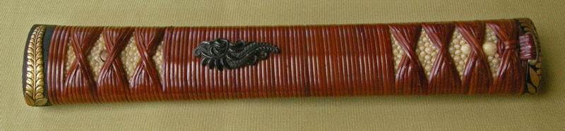

Lorenzo Posted October 28, 2009 Report Posted October 28, 2009 I was looking today at Mishina's website; on the page referring to contemporary tsukamaki by Yasuo Toyama I see an example called "Fuji-maki" which seems to be baleen. Does somebody knows the kanji for "fujimaki" or the kanji to use for the baleen wrapping please? Any help is appreciated. I have done some random kanji choice and search but the closest thing I got as result is the wrapping of Japanese saws handles. Thank you 1 Quote
IanB Posted October 28, 2009 Report Posted October 28, 2009 Lorenzo, Ah, this is what I suspected and mentioned in my post above. Fuji is of course wisteria which grows as a creeper over other trees. The tsuka you show is bound with material cut from the wisteria vine and presumably given a coating of lacquer to preserve it. What a beautiful job that binding is. Ian Bottomley 1 Quote
Lorenzo Posted October 28, 2009 Report Posted October 28, 2009 Thank you Ian, I didn't see that part of text before... stupid me It now makes sense why I find tool wrappings using 藤まき. I would be interested in this case to know the baleen kanji as well please Quote
Guido Posted October 28, 2009 Report Posted October 28, 2009 I would be interested in this case to know the baleen kanji as well please鯨髭巻 (くじらひげまき). And don't feel bad about not coming up with "Fujimaki", because it is not: it's not 藤 (wisteria) but 籐 (rattan), so it reads とうまき; the kanji look very similar, so it's easy to confuse them. Quote
Lorenzo Posted October 28, 2009 Report Posted October 28, 2009 Wonderful Guido ... thank you so much Quote
