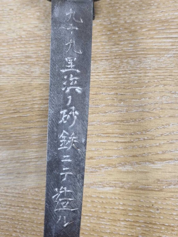

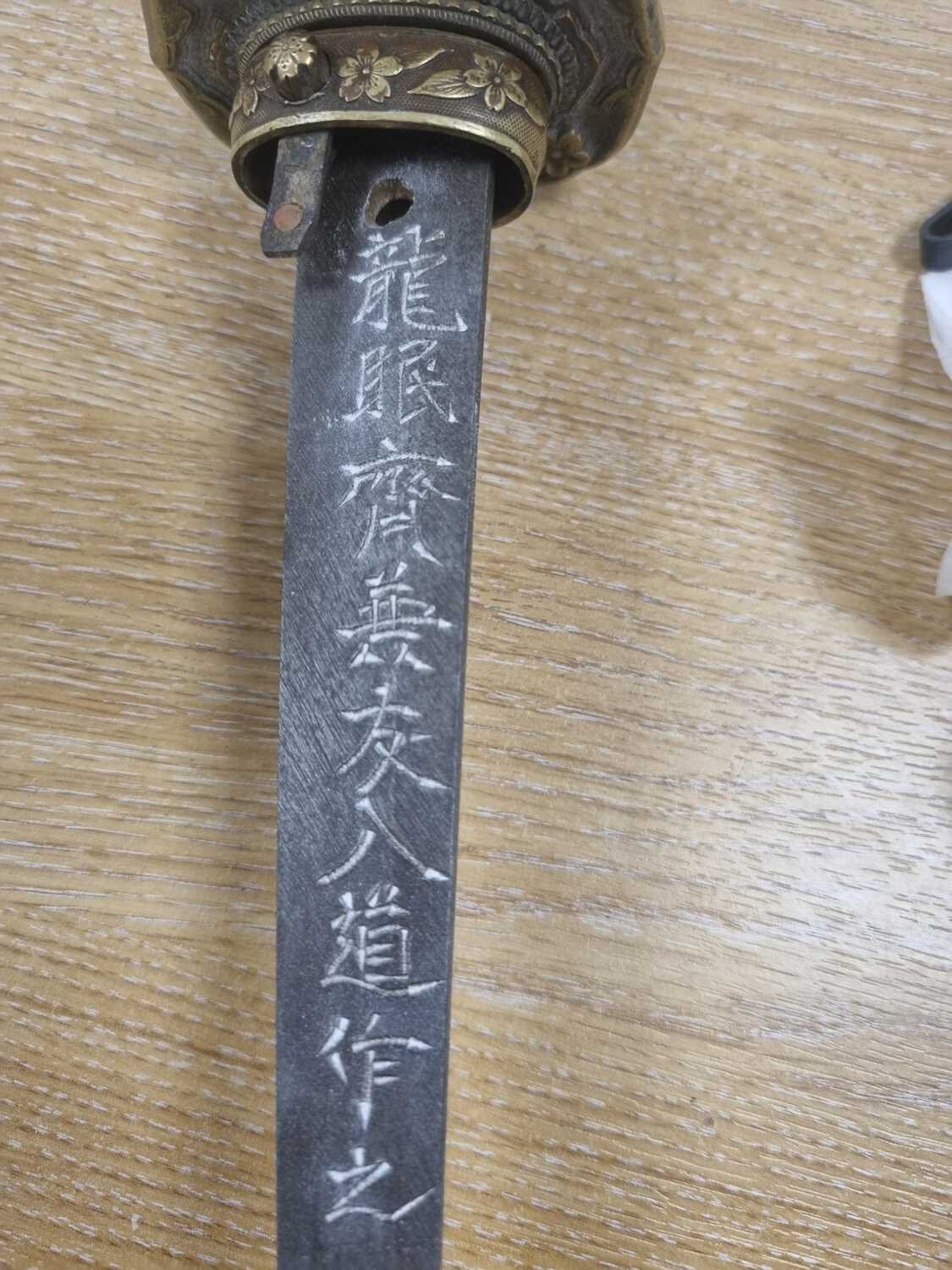

Ryuminsai Kanetomo made with iron sand from Kujukuri beach. Bought in auction last year. The Mei fascinated me. Never before seen similar except for nanban tetsu. I think he is a well thought of smith.

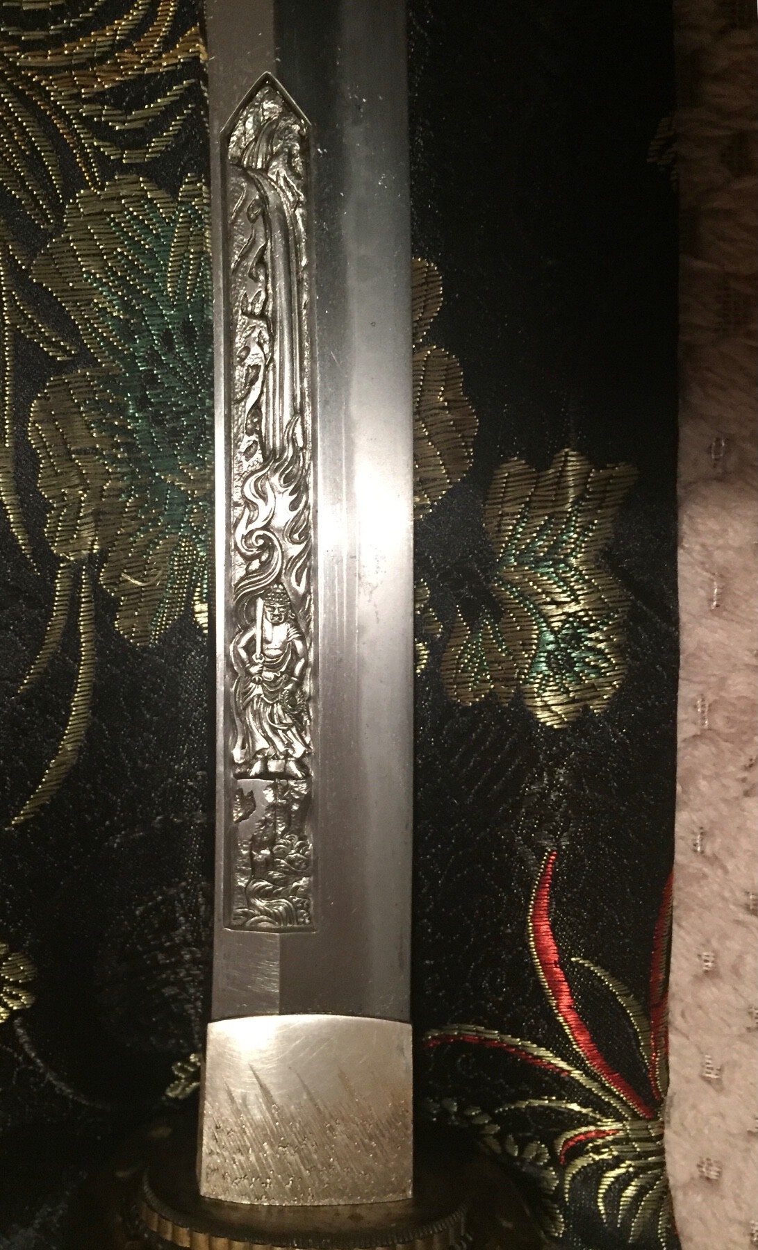

Unique Tanto
This Tanto was showed to Ogasawara san on the oncassion at an exhibition of important Japanese swords in the
Klingenmuseum in Solingen and clearly confirmed as a work by Hori Toshihide, short before his passing
 unusual long (28,8 nagasa)Tanto in a wooden box blade used as a mobile shrine.
The inscription on the omote indicates that the blade is to keep alive the memorey to Captain Paymaster Kubota Yukio
He died in action  in showa 18 nen 9 gatsu 21 hi
The mon presumably represents the
  dead mans familiy
The inscription reads. Chusein (Name of the Monks temple) KOYO JUNDO (spiritual name implying the deceased was a martyr
TESTSUSHIN ( posthumous Buddhist name)  KOJI (BUDDHIST layman) SENSHI (Death in action
  • Like 8
  • Love 4
this Tanto has two different hamon
one side is in gunome choji in Bizen style
other is worked in soshu..
Hori Toshihide was known for his works like that

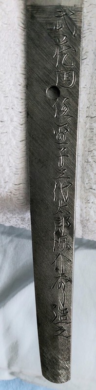

Don't know if this fits in here : Musashi Koku Jyu Kaneko Sandai Taro Minamoto Sukehide special order katana in bizen sanmai construction.
  • Like 6

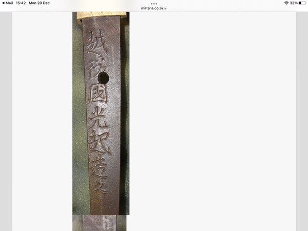

Somewhere buried  in old post( I tried to find it) I had a sword that said seven lives for my country
Pheasant thigh nakago
Shichi sei hokoku...
Probably misspelled and probably why I can't find it

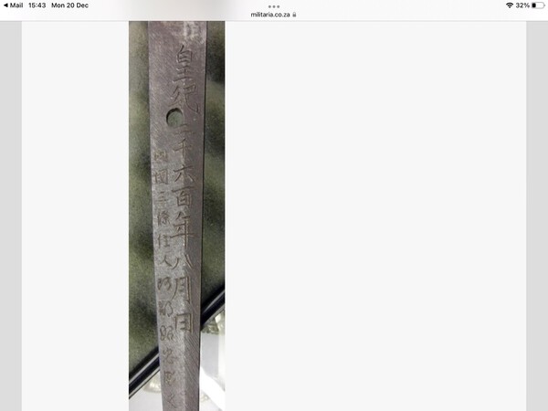

Here's a rare one.  I've seen a couple over the years with an inscription on the nakago mune like this.  Posted by @Okan
IMG_9536.thumb.jpg.3507451e351298e53132933c8956538e.jpg.3051e0d03f4e9adfde805b73adfc09ed.jpg IMG_9539.thumb.jpg.7cabf36b3a337f57e6c8d5bab680b007.jpg.1d229957165a34182b10be99b0bb980a.jpg
1943 Kanemitsu blade with a unique kiri engraving and LOOOONG inscription on the nakago mune that says "皇紀二千六百三年大東亜戦必勝祈願刀 – 2603 Imperial year (1943), a prayer sword for victory in the Greater East Asian War"
