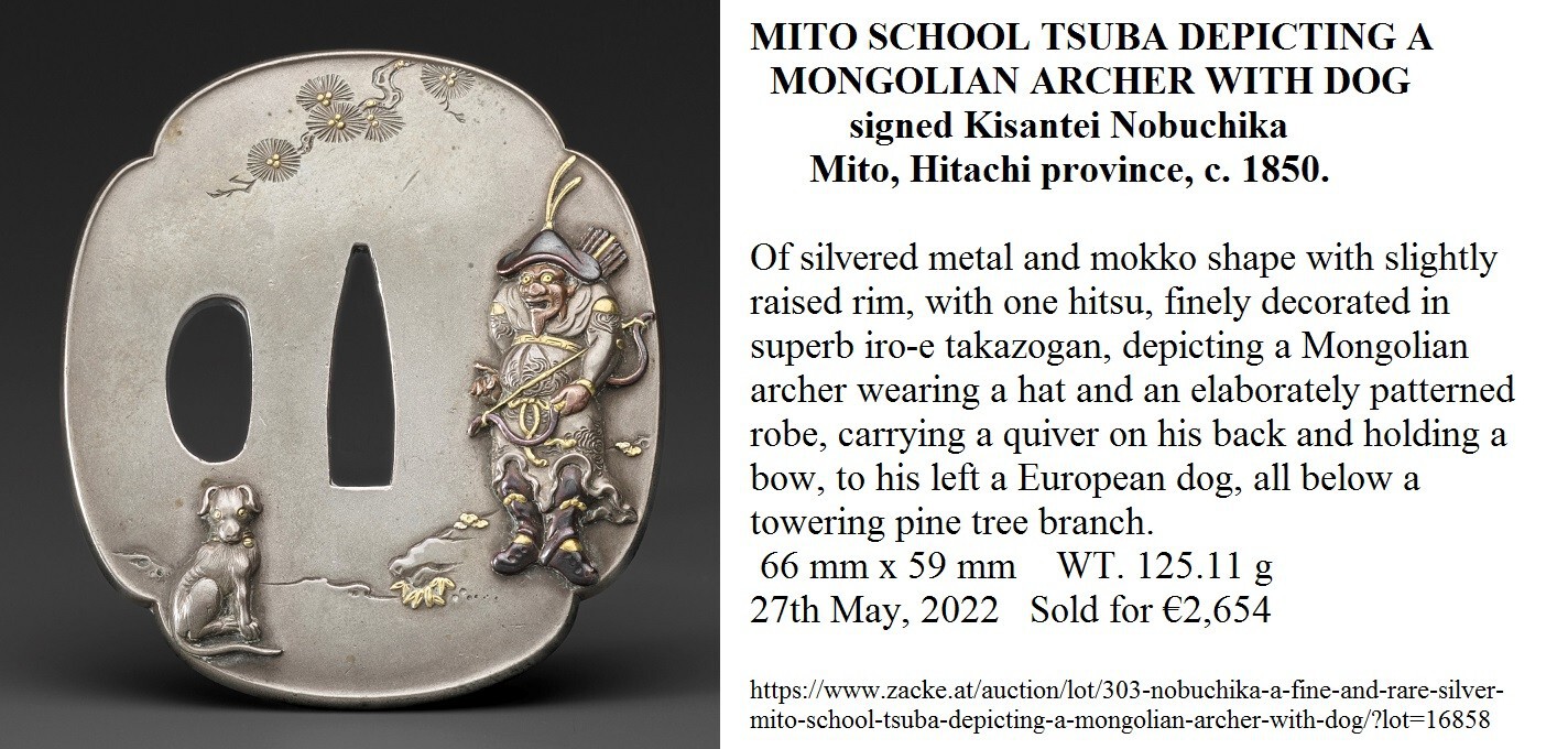

Spartancrest Posted May 14, 2023 Report Posted May 14, 2023 Hi Les, I have seen this guy a few times - he is described as a Dattan, Tatar (or Tartar) even just as a 'Foreigner' blowing a trumpet. He is also very often accompanied by the same long eared dog or hound. On rare occasions only the dog will appear. The image from the Metropolitan would seem to be closest to your Kozuka - great find by the way. https://www.metmuseum.org/art/collection/search/25724 6 Quote

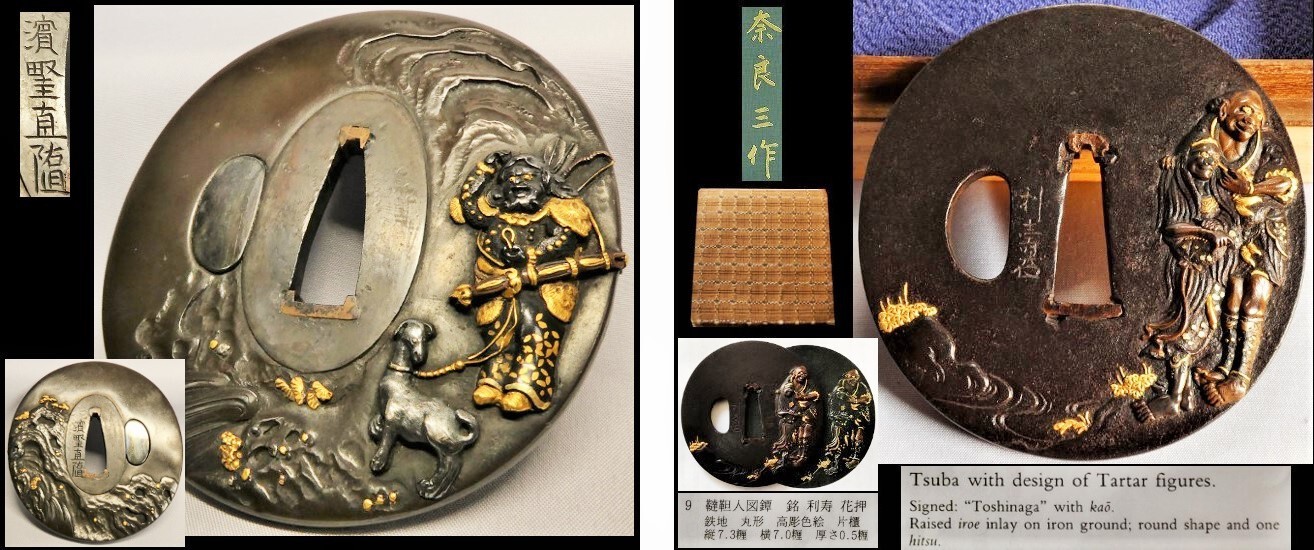

Spartancrest Posted May 14, 2023 Report Posted May 14, 2023 (edited) Other examples of Tartar with dog [that looks more like a goat!],one with wife? With wife and Shishi and just taking the Shishi for a walk. The designs are not as close, but you might notice the trumpet reappears in the third image. I may as well add this one to keep all the examples together. These 'foreigners' sure like their dogs! Edited May 14, 2023 by Spartancrest new data 3 Quote

Kanenaga Posted May 14, 2023 Author Report Posted May 14, 2023 Dale, great similars, especially that first group. Thanks so much. So I'm gathering that perhaps there is no story, just a semi-standardized way of depicting Mongolian gaijin? But such a similar image from the Hamano and Mito makers -- and now mine, which happens to be signed Toshinaga, a very big name so it's likely gimei. Nevertheless, I'll have to send it over for shinsa, on the off chance.... Any other thoughts about the origin of this image? Quote

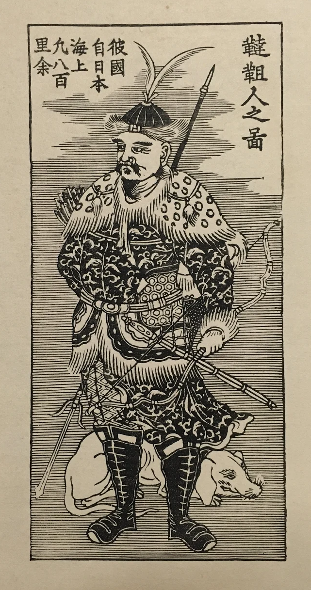

Spartancrest Posted May 14, 2023 Report Posted May 14, 2023 59 minutes ago, Kanenaga said: just a semi-standardized way of depicting Mongolian gaijin? I can't find much in the way of other images, perhaps it was a particular workshop design that was taken on by several smiths? I did find this little Netsuke of a Tartar warrior - - and I thought tsuba could be expensive!!! The long eared dog reappears in this woodblock, his hands are full of weapons so no room for a trumpet or "Charumera" 1 Quote
