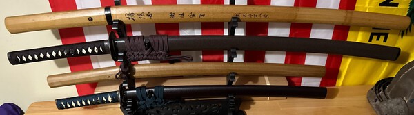

Seth Posted May 18, 2023 Report Posted May 18, 2023 Just contributing with my set (redneck daisho ), they are similar but certainly not matched or true. Both are Shinto. Please do not judge on the Chinese kake I haven't found the right real one yet. I also do not keep these out just snapped this pic when inspecting. 2 2 Quote
