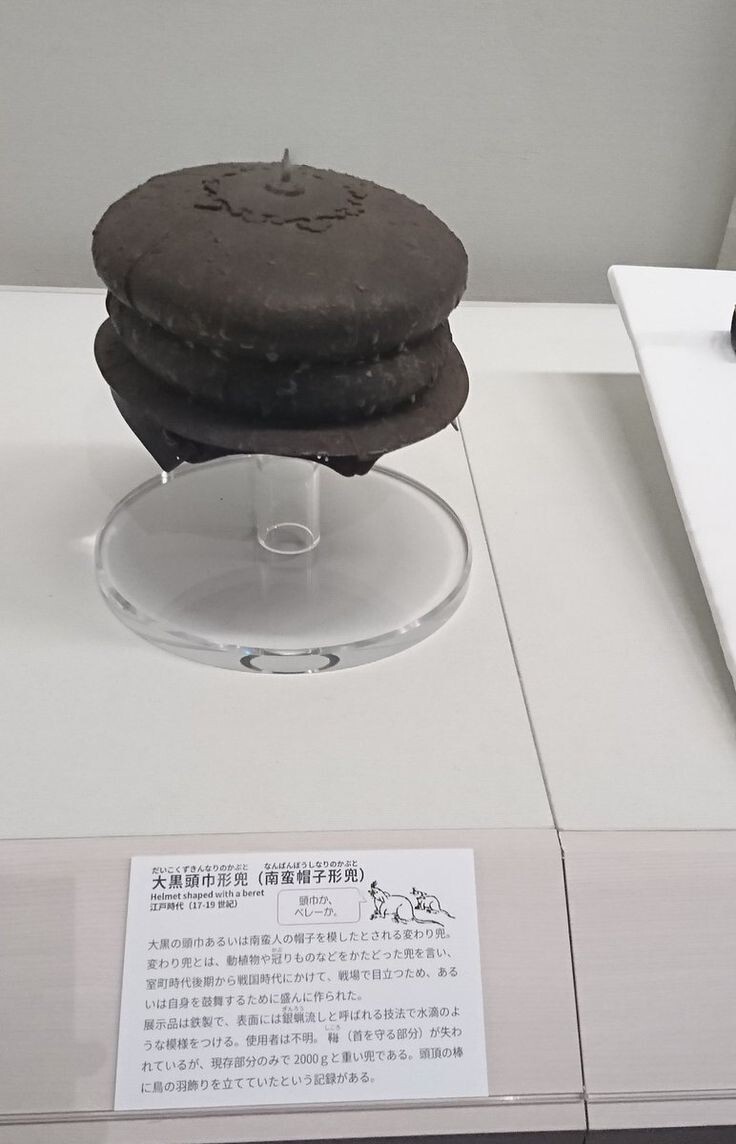

Here's a weird one. I have it filed away as a zukin, but it feels like it's in the same family.
  • Love 1
It’s described as “Daikoku zukin nari kabuto” as also as “Nanban bōshi nari kabuto”.
I spot sawari?! But the caption says ginrō-nagashi….
That helmet would be a worthy challenge. But not how the Tokugawa helmets were made. Anybody has a budget, let me know. 👍🏻And its off topic again! Haha. New daikokunari thread please....
