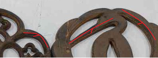

cast fakes
I have the same opinion -  cast. They may have come from a display board.
The first two have cast seams in the cut out areas. The other two are worse IMO.  The Crane or 'Tsuru' one I believe was made as a paperweight and had a cord tied through the "udenuki-ana" [now missing] the slot was used so the cord could lay flush with the tsuba. The pattern is usually associated with the Higo school - such as this one  https://www.tosoguya.com/higo_crane_tsuba.html   similar pattern in "Bronze" ?
