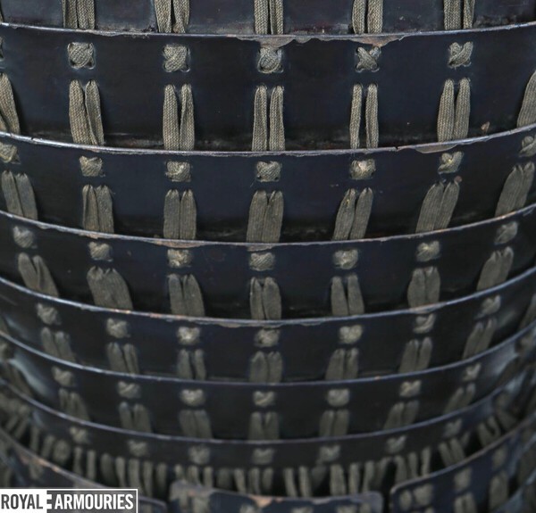

Okegawa do for an ashigaru - Royal Armouries collections | Samurai armor, Okegawa, Character ...
Unfortunately, this is not what the name is referencing. There is a deeply engrained tendency for Westerners to base their descriptions and appraisal of Japanese items on what it looks like to their eye. This leads to a fixation on things of a decorative nature, or a deeper need to relate something truly foreign to something more familiar from their own culture.

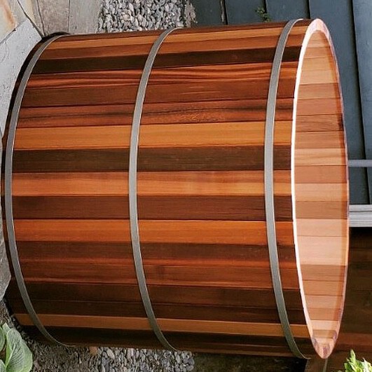

This is what the word Oke is actually describing:
「桶」イラスト無料
It is not referring to the appearance of the object but rather its construction! This is the case for many (thought not all) old styles of Japanese armor.
The old fashioned Japanese tubs and buckets are made with wood slats tightly butted to each other. So, a "tub sided" dou is referring to the construction being like that of the sides of a wooden bucket or tub, being made of flat plates of steel.
But where and when did this term originate you might ask? This will be addressed later after showing the physical evolution of the riveted plate, two section Okegawa-dou. For now though, in short, this term was originally used to describe what we now call the Mogami-dou, and was already in use no later than around 1570.

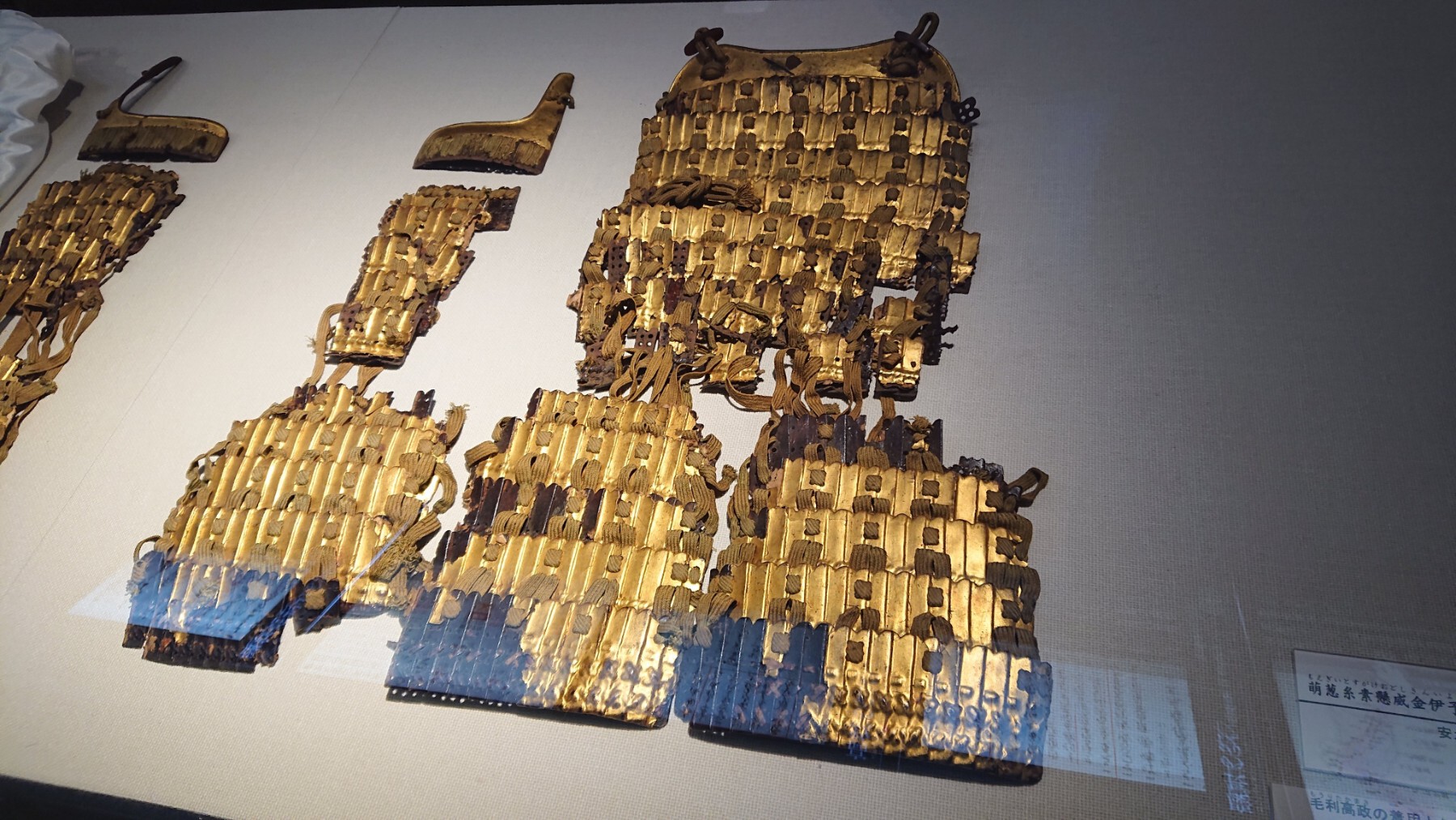

Illustration of a Kin-Kozane Domaru
Black Laced Tetsu-Iyozane Haramaki:
image.png.c2ae48fd42d212ac3d7582df3c9f97d9.pngimage.thumb.png.e0a8b77b80476f7de31e501bc19d909f.png
Note the kusazuri in both cases are still made from leather kozane to reduce weight.

This dou is comparable withe the golden one of Maeda Toshiie.  1570-1580.
