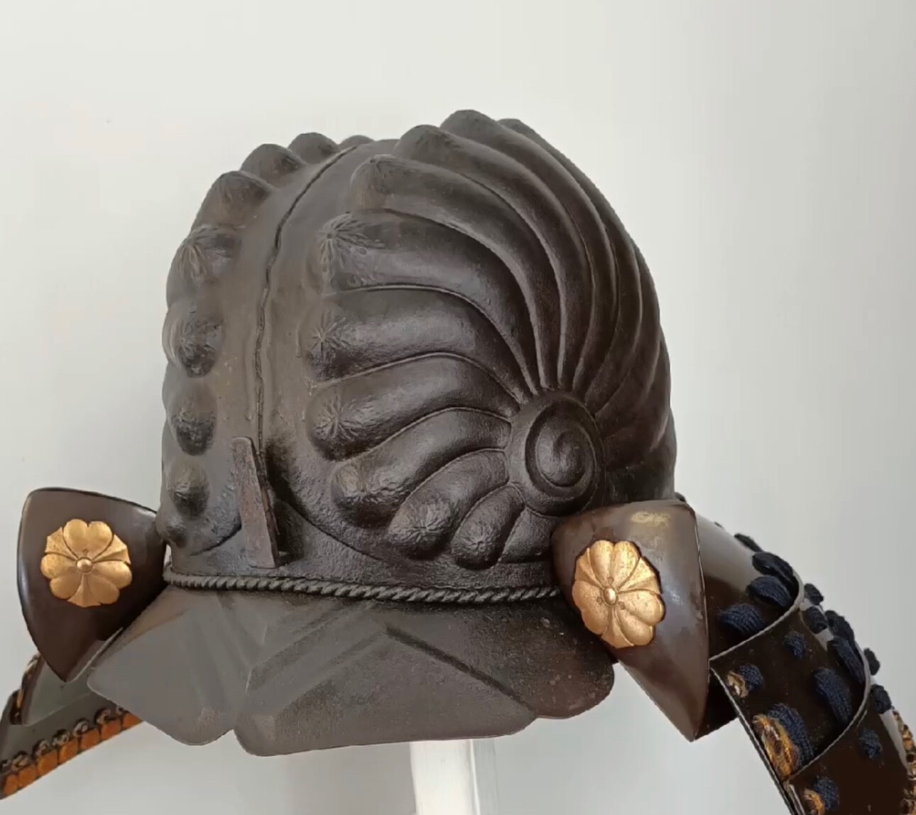

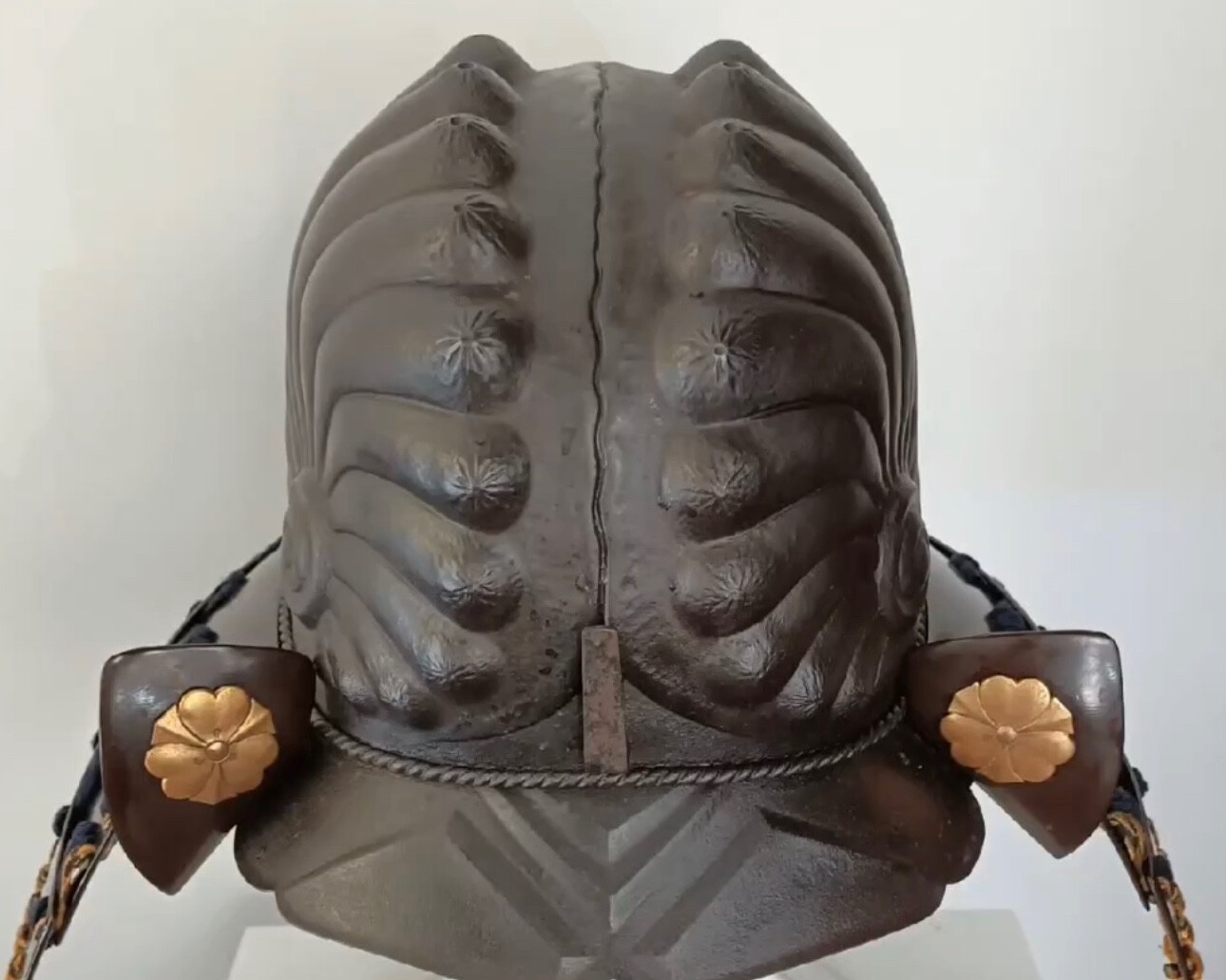

Luc T Posted May 18, 2023 Report Posted May 18, 2023 In the early edo period, the Myochin started to copy Nanbokucho and Kamakura kabuto. They also copied Gitsu and Nobuie. But. They always made the same mistake, they exaggerated all the old features. This abalone is a joke. Bad proportions, ugly, fluffy forging, and over the top. I wonder where it was made, Tadjikistan? Tora bora mountains? Or Bangkok? I vote outside Japan. 1 Quote
GN174 Posted May 19, 2023 Report Posted May 19, 2023 I would agree outside of Japan, there is a seller on Juace who regularly posts Kawari Kabuto. I will post the next one when it comes up, they are from the images very good looking (too good) and do attract bids. The person making them clearly has a skill set and its a shame they are passing them off a earlier pieces to attract higher prices. They have talent they would probably still get sales if they marketed honestly 2 Quote

Gakusee Posted August 10, 2023 Report Posted August 10, 2023 On 5/17/2023 at 11:04 AM, Luc T said: What do we have now… Expand Hi Luc May I please sense check your thoughts on and impressions of the kawari kabuto that I saw on social media below? It looks definitely better executed than the one you originally linked. However, to me the shape is again rather preponderant and bulky. Some recent lacquer work on it too. Thank you. Quote
YOJIMBO Posted August 10, 2023 Report Posted August 10, 2023 On 8/10/2023 at 10:22 AM, Gakusee said: Ahoj Luc Mohu si prosím ověřit vaše myšlenky a dojmy z kawari kabuto, které jsem viděl na sociálních sítích níže? Vypadá to rozhodně lépe provedené než to, které jste původně propojili. Nicméně pro mě je tvar opět spíše převládající a objemný. Některé nedávné laky na tom také pracují. Děkuji. Expand it's a longer debate, but it was sold by a seller in Japan, who is overwhelmingly counterfeiting. ( the first kaburo ) Quote
