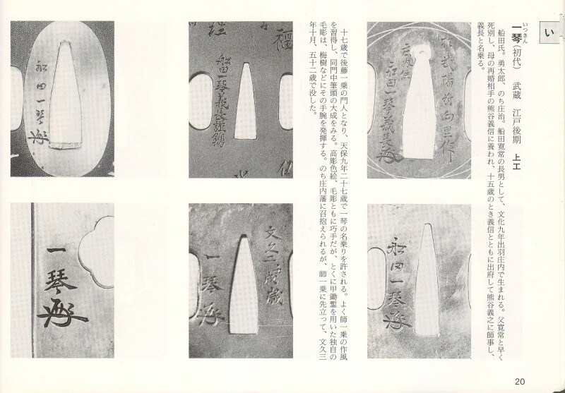

I don't wrote that this tsuba has old Type NTBHK Tokubetsu Kicho cerificate
Also Kinko Meikan contains similar mei Ikkin Funada ( page13-15 )
What do you think about this mei ?
Mikolaj
This is from the revised Kinko Meikan:
I feel that there are too many differences upon close examination to be confident in the mei. Older papers should always be held with some suspicion as there have been many mei since excluded from the reference literature. It is also important to have the latest version of the Kinko Meikan which is from 1998 if memory serves. I also checked the ten pages of examples in the Toso Kodogu Meiji Taikei with the same result. If in doubt send it for shinsa -- that's what it's there for.
