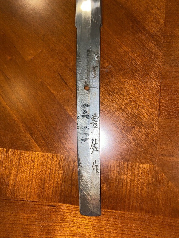

Bruce Pennington Posted April 21, 2023 Report Posted April 21, 2023 Here is a Toyosuke, stainless, anchor-stamped in army fittings. Posted by MactheWhopper: Quote
PNSSHOGUN Posted April 21, 2023 Report Posted April 21, 2023 That looks a little suspect as well, early Type 94 Tsuba with rewrapped handle (maybe new samegawa). 2 Quote

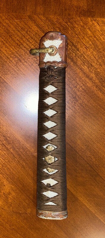

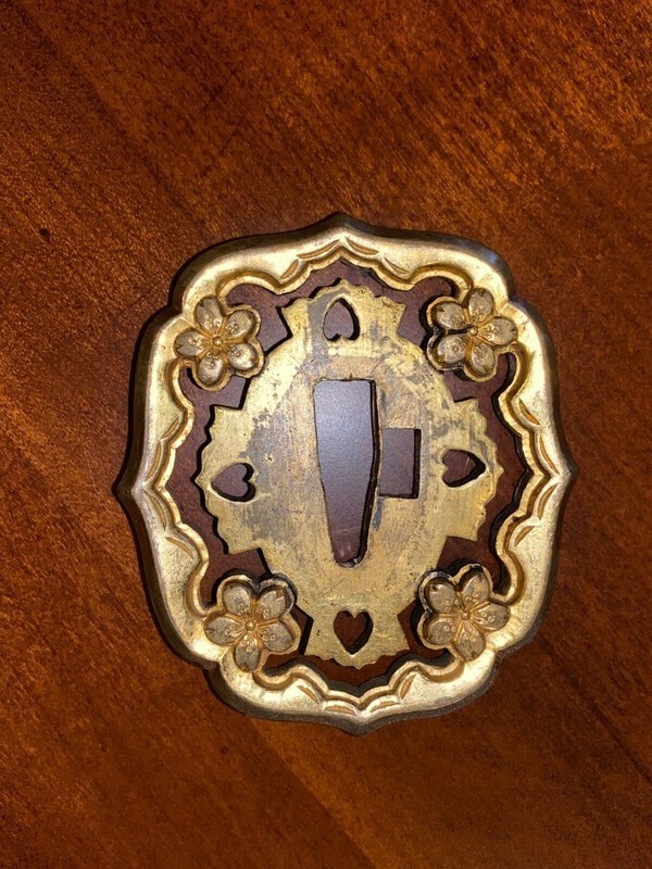

Jcstroud Posted April 22, 2023 Report Posted April 22, 2023 On 4/21/2023 at 12:54 PM, Whitecap said: Thanks for reply, hope this picture is clear enough. Expand This koshirai could not be original because the tsuka has 2 holes and nakago only one. Not to mention : the seppamania required to make it all fit.Takeyasu is among a list of souvenir swordsmiths that made swords for sale at Tokyo Px Quote

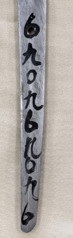

John C Posted September 26, 2023 Report Posted September 26, 2023 On 4/22/2023 at 3:24 PM, Bruce Pennington said: Good point, John. I only had 1 Takeyasu on file and it's in souvenir fittings. Expand May be of interest - a Takeyasu in Kai gunto fittings. Note the really large assembly number. https://www.ebay.com/itm/305147883374?hash=item470c3b2f6e:g:5HwAAOSwA71kGKm7&amdata=enc%3AAQAIAAAAwAJyVVdat78P%2FLcavGGqQTkzxcEDU41MoweMIg6Dpu4FZrDWR5rnOEQm0wJZoG8HJ9KNIYRiLghXe22WlWCFvfyyy%2FVnNepTcF2qoH4HqWkVLG1LTJZZzuW4TquCYXI%2Bc%2Bu98NsZzsA9bx51kl0%2BSg3E9wVVGomN5w1GWg6bnMKUw6MoePJ4ZTEqv05HKZxB%2F12C73iV5dZ8Zcmt5CX05C%2FO2ftLwpA0m0K4El3fOe%2BY%2BwUt15lxoXZ9CcE03WqrmA%3D%3D|tkp%3ABk9SR5bTtbLaYg John C. 1 1 Quote
Bruce Pennington Posted September 27, 2023 Report Posted September 27, 2023 I would take this as evidence that the smith had been making blades during the war, and then worked with Tenshozan after the war. It has been my experience that the large numbers are seen on wartime blades. Quote
Jcstroud Posted September 28, 2023 Report Posted September 28, 2023 690969096 weird am I reading this right seems almost like secret message code? Quote
Kiipu Posted September 28, 2023 Report Posted September 28, 2023 I don't think it is a 6 per se. Note the 909 is in kanji while the "6" is not. Usually they used a character prefix and this is what it could be. Could be the 6th set of the series? Very unusual whatever it means. Now, lets get back to Toyosuke, the man, the myth, and the legend? 1 1 Quote
Jcstroud Posted October 14, 2023 Report Posted October 14, 2023 Found another Takeyasu very similar with curious numbering also 1 Quote
