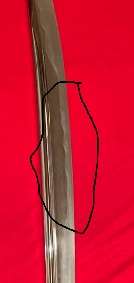

jsv Posted May 23, 2023 Report Posted May 23, 2023 I think the nakago looks too dark for late shinshinto and what is going on in this area? 1 Quote

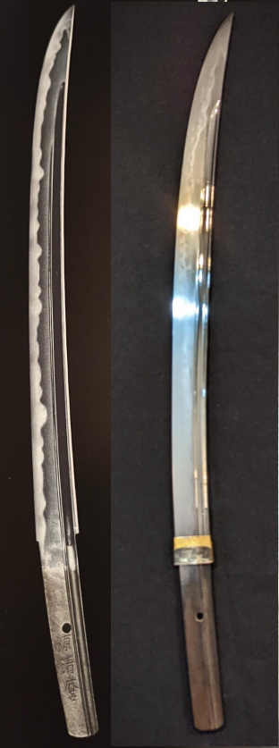

Promo Posted May 24, 2023 Report Posted May 24, 2023 Thanks for providing additional pictures! I've did my best in a quick and dirty method and tried to match your two pictures to a single one. The hamon is quite high up in the blade, except for a part of the front half of the blade starting around the middle. @Ray Singer did you actually have the blade with you personally when you sold it, meaning you have had it in hands? Quote
Promo Posted May 28, 2023 Report Posted May 28, 2023 @Sutraken I thought your blade deserves a better side by side so I did the attached "enhaced version" of the previous image better (but still a bit "quick'n'dirty" since a bit of the red background is still visible) in Photoshop. Thought you may appreciate it: Quote
Sutraken Posted May 28, 2023 Author Report Posted May 28, 2023 Hello Georg, thank you for putting both pictures side by side. Quote
