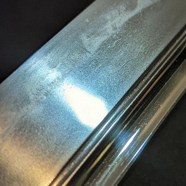

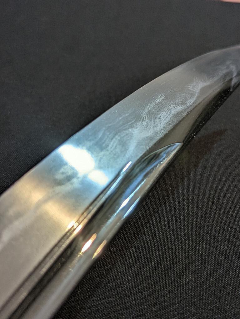

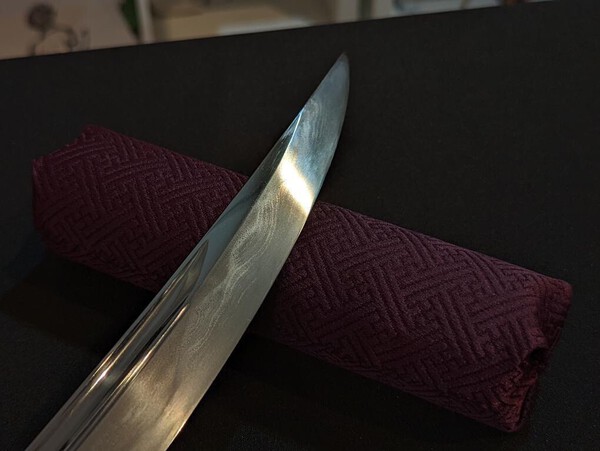

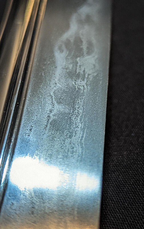

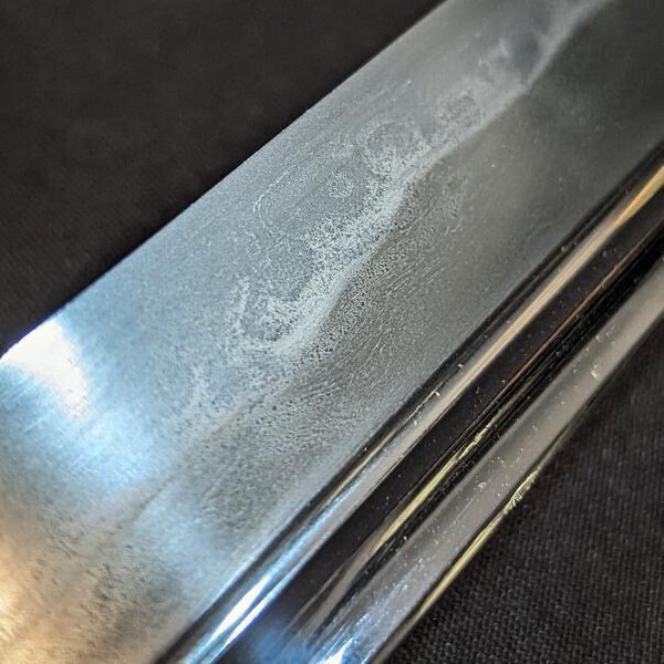

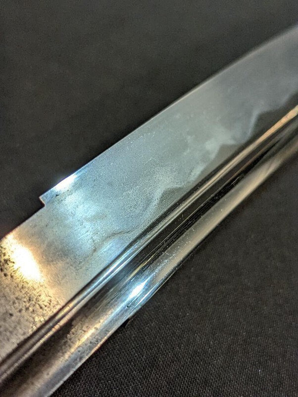

Sutraken Posted April 20, 2023 Report Posted April 20, 2023 Hello Gents, I want to share with you some pictures of my Kiyomaro mon naginata naoshi o wakizashi, which I bought last year from Ray Singer. Although it is mumei, it is a ubu sword with a nagasa of 51,5cm. The possibility that Kiyomaro himself made this great soshu den wakizashi is very high. A final attribution should be given by a NBTHK shinsa. I hope you enjoy. All the best 14 5 1 Quote
Franco Posted April 21, 2023 Report Posted April 21, 2023 Hello Stefan, Thank you for sharing these excellent images of this unique and exciting naginata naoshi o-wakizashi. Could you please describe the lighting techniques and type of camera used in taking these images? Many thanks in advance. Regards, Franco Quote
Guest Simon R Posted April 21, 2023 Report Posted April 21, 2023 Hi Stefan, That is an absolutely exquisite blade which looks very much like the work of the master tosho Kiyomaro. My only question is why the seller, Ray - a person for whom I have the greatest respect and know to be extremely knowledgeable of Nihonto - had not already put the blade through NBTHK shinsa himself? Certainly, if I possessed a credible, potential Masamune, Kotetsu or Kiyomaru, I would have it 100% authenticated by the highest accredited body of experts before even considering selling it on. Ray? Anyhow, just my immediate thoughts. Congratulations on a phenomenally beautiful blade. Simon Quote
Sutraken Posted April 21, 2023 Author Report Posted April 21, 2023 Thank you for the replies. These pictures were taken by Ray Singer, so I don‘t know which techniques he used. Ray sold me this wakizashi last year as a commission piece. He never owned it. This naginata naoshi doesn’t have a high class Japanese made shirasaya. The current shirasaya was probably made in the US. The polish is excellent and seems to be very old. I am quite sure this sword was not in Japan for a very long time. Quote

reinhard Posted April 23, 2023 Report Posted April 23, 2023 A beautiful and spectacular blade. Nevertheless I am leaning towards Taira (no) Nobuhide as the maker of this blade as far as one can tell from pixels. Congrats anyway. reinhard 1 Quote
Rivkin Posted April 23, 2023 Report Posted April 23, 2023 Good thing about being universally hated is one can be honest. I don't think its Kiyomaro. Its indeed his style and you see such blades with green papers to Kiyomaro in Japan probably once or twice a year. To me there are two issues. First, the portion of the hamon towards the edge is non-distinct, harsh and glassy, while with Kiyomaro one often sees it gradually reducing to ko-nie and rather beautiful nioi, kind of like Sa - large, bright nie on top, soft flowing nioi on the bottom. Second issue - jigane is a bit harsh, in good Kiyomaro its more consistent, distinctive, granulated, bright, chikei and ji nie are more pronounced, while here besides ara nie there is not that much. A later work in Kiyomaro style, of good quality. 2 1 Quote
Sutraken Posted April 23, 2023 Author Report Posted April 23, 2023 56 minutes ago, Rivkin said: Good thing about being universally hated is one can be honest. I don't think its Kiyomaro. Its indeed his style and you see such blades with green papers to Kiyomaro in Japan probably once or twice a year. To me there are two issues. First, the portion of the hamon towards the edge is non-distinct, harsh and glassy, while with Kiyomaro one often sees it gradually reducing to ko-nie and rather beautiful nioi, kind of like Sa - large, bright nie on top, soft flowing nioi on the bottom. Second issue - jigane is a bit harsh, in good Kiyomaro its more consistent, distinctive, granulated, bright, chikei and ji nie are more pronounced, while here besides ara nie there is not that much. A later work in Kiyomaro style, of good quality. I see nothing but envy and resentment in your words, but that is okay: some collectors know these feelings in such situations. A prime example is Georg’s thread about his Masayuki. The majority supports the collector and his finding on the way to shinsa, but a small minority tries to blame a sword as gimei, only to get rid of their frustration and envy. 1 1 Quote
