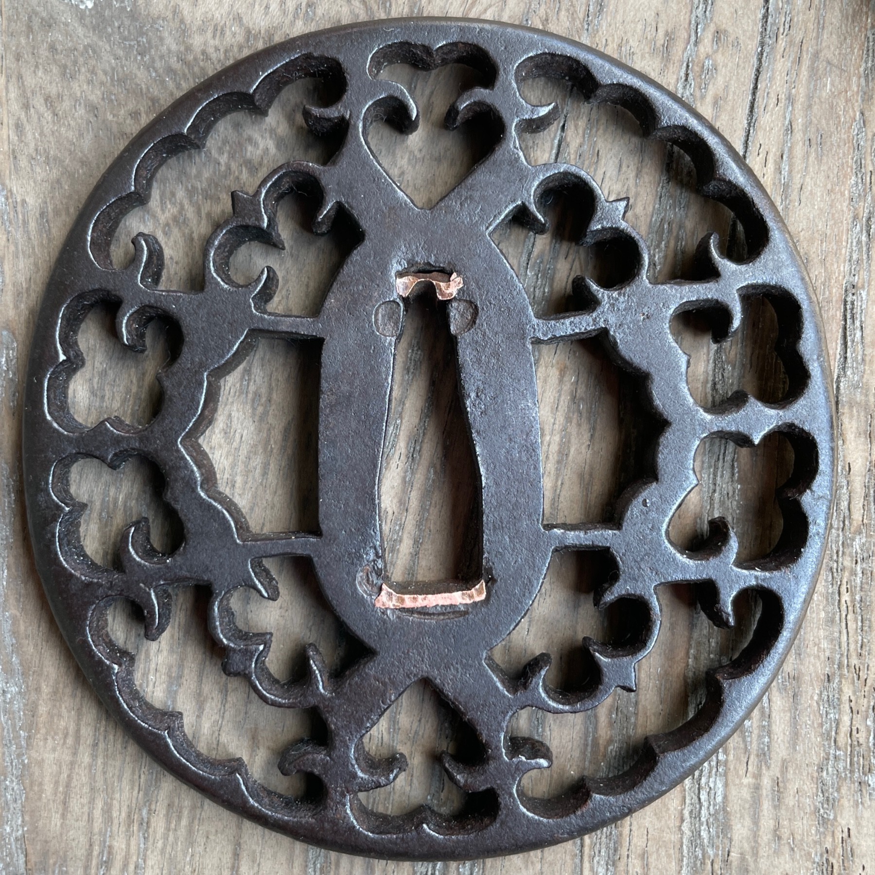

Yves55 Posted April 16, 2023 Report Posted April 16, 2023 Bought last friday on a flea market... Is the wavy inside of the rim a feature of a specific school? 7,29 x 7,01 x 0,63 cm seppa / 0,58 cm rim 88 grams - iron Any comment is welcome 😉 6 Quote
ROKUJURO Posted April 16, 2023 Report Posted April 16, 2023 Very nice find! Might be AKASAKA, but similar designs have also been used in HIGO 1 1 Quote
Spartancrest Posted April 17, 2023 Report Posted April 17, 2023 Some similar designs, the second one described as Kyo-sukashi - https://www.tosoguya.com/kyo_sukashi_myoga_karigane_tsuba.html but it has much thinner elements. Papered Akasaka - https://yakiba.com/akasaka-tadashige/ 2 Quote
FlorianB Posted April 17, 2023 Report Posted April 17, 2023 My first impression was later Akasaka, because of the design and the different sized hitsu-ana, but as said above Higo could also be a possibility. Here’s a similar Nishigaki of mine: Are there any signs of sanmai awase on the outer rim or inner sides? Florian 1 Quote

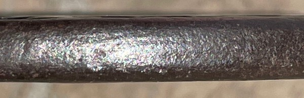

Soshin Posted April 17, 2023 Report Posted April 17, 2023 On 4/16/2023 at 1:38 PM, Yves55 said: Is the wavy inside of the rim a feature of a specific school? Expand @Yves55 not really clear what you are referring to in the above comment and the with the single photo vital details of the rim are not at all clear. With that said what I think you are referring to are visible layers in the iron of the rim. That is just one of few important kanei points for the Akasaka ( 赤坂) School circa middle to late Edo Period. I say your tsuba is likely the work of the Akasaka School but would need additional photos (clearly showing the details of the rim) or to see the tsuba in person and allowed to examine it under good lighting. I hope you find my comments helpful in your study. What a very nice find at a flea market! 1 Quote

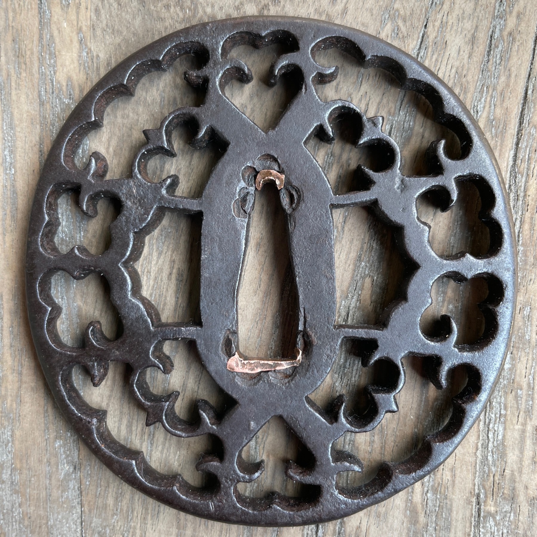

Yves55 Posted April 17, 2023 Author Report Posted April 17, 2023 Thank you all for the replies 😃 Some more photos following! So, waiting for more comments 👍🏻 Quote
Yves55 Posted April 17, 2023 Author Report Posted April 17, 2023 On 4/17/2023 at 4:59 AM, FlorianB said: My first impression was later Akasaka, because of the design and the different sized hitsu-ana, but as said above Higo could also be a possibility. Here’s a similar Nishigaki of mine: Are there any signs of sanmai awase on the outer rim or inner sides? Florian Expand I posted some more photos. BTW, your geese are flying in, mine are flying out... 🤣 Quote
Yves55 Posted April 17, 2023 Author Report Posted April 17, 2023 On 4/17/2023 at 10:42 AM, Soshin said: @Yves55 not really clear what you are referring to in the above comment and the with the single photo vital details of the rim are not at all clear. With that said what I think you are referring to are visible layers in the iron of the rim. That is just one of few important kanei points for the Akasaka ( 赤坂) School circa middle to late Edo Period. I say your tsuba is likely the work of the Akasaka School but would need additional photos (clearly showing the details of the rim) or to see the tsuba in person and allowed to examine it under good lighting. I hope you find my comments helpful in your study. What a very nice find at a flea market! Expand Just bought another tsuba with waves (?) at the inside of the rim. Same school or...? 1 Quote
FlorianB Posted April 17, 2023 Report Posted April 17, 2023 Not sure about the rim (a little bit fuzzy), but in the inner structure there are some areas which look laminated. So Akasaka seems possible. Your second Tsuba shows pines, a branch (probably plum if I see the carved blossom correct) and two blossoms. The wavy hitsu-ana represent snow or snowflakes. Same problem like above: Akasaka or Higo - more detailed pictures needed to pin down the origin. In my opinion it looks rather like Higo because of the sophisticated style. But it should become obvious that "same design, same school" is a wrong conclusion. Alas it's more complicated... Florian Quote

FlorianB Posted April 18, 2023 Report Posted April 18, 2023 Theses are areas seeming laminated I refered to: Florian 1 Quote
Soshin Posted April 18, 2023 Report Posted April 18, 2023 On 4/17/2023 at 11:44 AM, Yves55 said: Just bought another tsuba with waves (?) at the inside of the rim. Same school or...? Expand From the additional images I am still standing by the call of Akasaka School. Everything looks consistent for that school's work in terms of the plate construction, distribution of the plate metal, and thickness and shape/style of rim. This other tsuba is a nice later Akasaka School copy of an original Higo openwork design which was very popular by the time the Akasaka School was making its copies in Edo. Still, what a great find at a flea market. Keep up your excellent work and enjoy this hobby. 1 Quote
