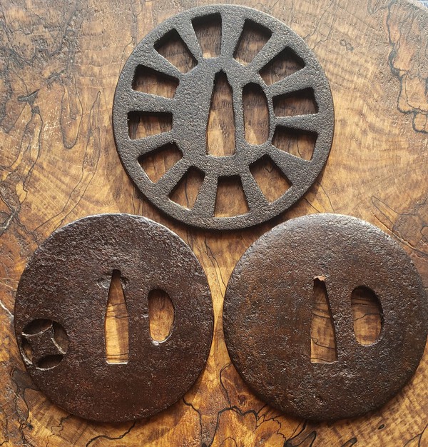

Looking for opinions on this, I know not the most brilliant looking thing, but the large hitsu ana peaked my interest. Thank you.
Dimensions:
7.7cm x 7.4cm
Thickness 4mm
Nakago ana 28mm
Hitsu ana 20mm.

Dear Matt.

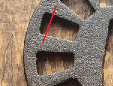

Speaking personally I would leave this one where it is.  The plate does not seem to have any age and the irregularity of the whole design leaves me cold.  The seppa dai is not seppa dai shaped and the overall crudeness of the sukashi looks pretty rough.
What interests you about it?
All the best
Thanks for the replies. I'm not a collector of tsuba. I got it with 2 other tsuba and seppa from Japan. Didn't think anything of the "circle" shape of the seppa dai as I have seen others like that. But compared to the other two the color seems off. And I agree with the crudeness of the nakago ana and overall design.

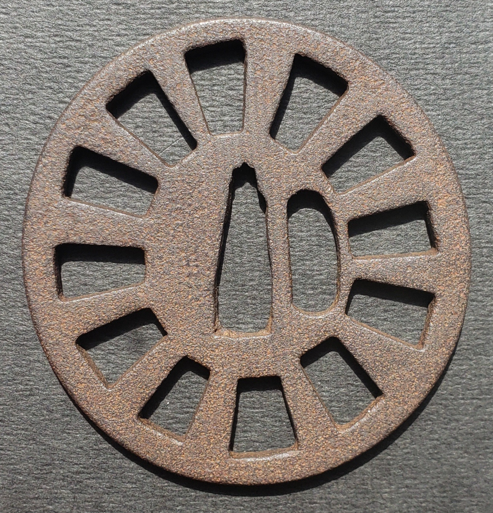

The first photo i cleaned it with ivory and washed it with soap and dried it off. The below photo is after applying oil and wiping off. 20230414_175514.thumb.jpg.ccf656ac08d3ffe2f7cf774b0cfd79f7.jpg
