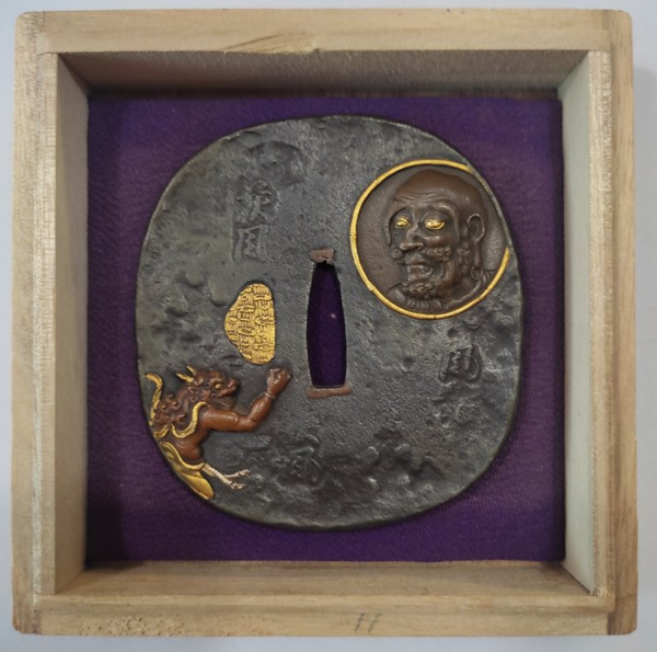

Tlognaws Posted April 12, 2023 Report Posted April 12, 2023 Hello everyone, I have just got this tsuba recently. It's a very good iron tsuba to me, showing very bold design and composition. Also it present confident technique with a beautiful and quite matching mei of Nagatsune. Could anyone tell me your opinion on this? I have seen many of gimei Nagatsune out there, any chance that this could be a gimei too? Quote
Brian Posted April 12, 2023 Report Posted April 12, 2023 Quality is fantastic. Can't verify the mei, but the work belongs to a really good maker. @Ford Hallam? 1 1 Quote
Franco Posted April 12, 2023 Report Posted April 12, 2023 Checking Sesko's Meikan - sword fittings, am not seeing anything that gives confidence to the mei on this tsuba. Other sources? Regards, 1 Quote

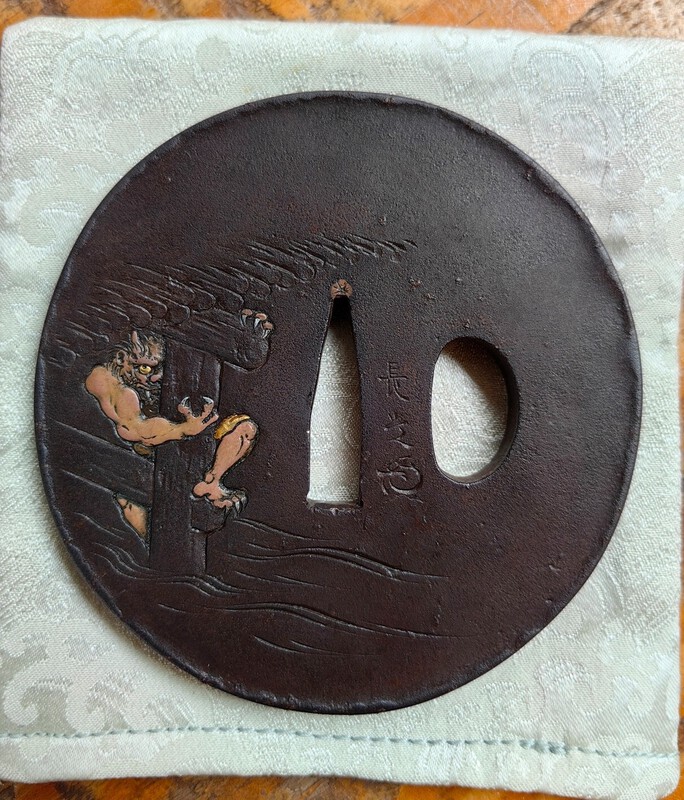

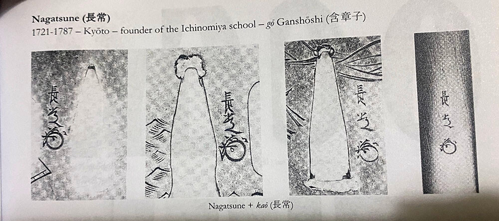

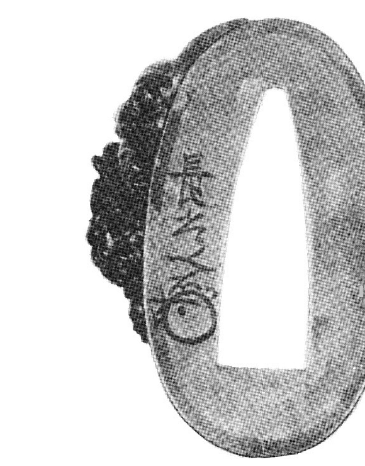

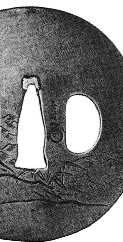

Tlognaws Posted April 12, 2023 Author Report Posted April 12, 2023 On 4/12/2023 at 5:55 PM, Franco D said: Checking Sesko's Meikan - sword fittings, am not seeing anything that gives confidence to the mei on this tsuba. Other sources? Regards, Expand Hi Franco, Markus has a great book which is translated from Wakayama Takeshi researching into Nagatsune life ( published 1985). There are several recorded mei that can use to compare to the mei on this tsuba ( although I find them a little bit different to each other) I have attached them below. Quote
Brian Posted April 12, 2023 Report Posted April 12, 2023 I agree, the mei doesn't match. But still feel the quality is very decent. 3 1 Quote
b.hennick Posted April 12, 2023 Report Posted April 12, 2023 It has a very new feeling for me. 1 1 Quote
Grey Doffin Posted April 12, 2023 Report Posted April 12, 2023 The tsuba has an ishime like finish: tiny pebbled or hammer worked. However, the surface doesn't look right for ishime and it appears the finish carries over into the mei, especially into the kao, which wouldn't be the case if the mei were chisled. I'm going to stick my head way out and suggest that this may be a cast copy. Hope I'm wrong and waiting to see what those more knowledgeable have to say. Grey 1 1 Quote

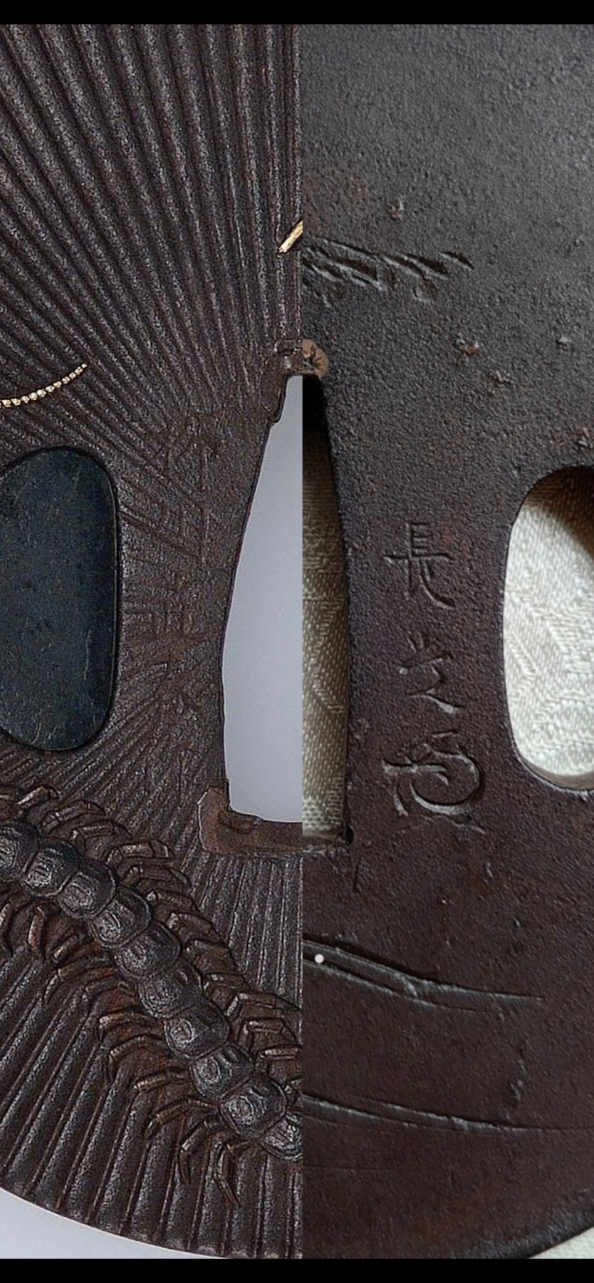

Tlognaws Posted April 13, 2023 Author Report Posted April 13, 2023 On 4/12/2023 at 10:01 PM, Grey Doffin said: The tsuba has an ishime like finish: tiny pebbled or hammer worked. However, the surface doesn't look right for ishime and it appears the finish carries over into the mei, especially into the kao, which wouldn't be the case if the mei were chisled. I'm going to stick my head way out and suggest that this may be a cast copy. Hope I'm wrong and waiting to see what those more knowledgeable have to say. Grey Expand Hi Grey, thanks very much for your opinion. I thought the grainy surface here is quite common traditional Japanese patina finishing on iron, and was proceeded very carefully. I'm not sure about the name of it, but I have seen various of iron tsuba with same looking surfaces. As i observed the process of making iron tsuba, they did engrave the mei before leaving the whole tsuba for rusting, then scrub it with brush, and repeat the task several times to get perfect and even surfaces. The inner line of mei then exposed a little bit grainy. I have a comparison below to another Yanagawa Naoharu iron tsuba from MFA with same surface finishing. 2 Quote
Spartancrest Posted April 13, 2023 Report Posted April 13, 2023 On 4/12/2023 at 10:01 PM, Grey Doffin said: I'm going to stick my head way out and suggest that this may be a cast copy. Expand If I have one 'problem' with it, it looks too good? Except for the paint job? Would an artist make this bad a mistake when applying the gilding? I know another Nagatsune - [Minamotono Nagatsune] a design that has been widely copied and mass produced, it has fooled museum "experts" for years. https://www.pinterest.com.au/pin/231724343316551362/ https://www.worthpoint.com/worthopedia/Japanese-tsuba-oni-and-priest-large-katana https://www.eldreds.com/auction-lot/inlaid-iron-nade-gaku-hokei-tsuba-by-sekizan-depi_75E43C99FB - This Fake sold for $1,300.00 https://www.catawiki.com/sv/l/63441801-tsuba-jarn-Japan-edoperioden-1600-1868 - this one sold for €500 https://www.ebay.com/itm/175279807811 - the basic un-coloured version For the Italian speakers out there - http://www.intk-token.it/forum/index.php?/topic/7940-unaltra-tsuba-e-un-pò-di-più/ I hope the facts don't upset the owner too much! Anyone interested I can find you twenty or thirty on ebay, Jauce, Buyee - you name it! Quote
Franco Posted April 13, 2023 Report Posted April 13, 2023 On 4/12/2023 at 10:01 PM, Grey Doffin said: I'm going to stick my head way out and suggest that this may be a cast copy. Expand My first thought was reproduction although, I'm uncertain of method. 1 Quote

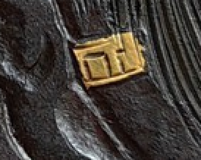

Tlognaws Posted April 13, 2023 Author Report Posted April 13, 2023 On 4/13/2023 at 5:57 AM, Franco D said: My first thought was reproduction although, I'm uncertain of method. Expand This tsuba could be an reproduction at my first thought, too. However I'm quite impressive with how the maker present his skill on the piece. Below is an focusing on super tiny strokes ( may be hammering) outside fingers of the Oni, to lower the tone of the area, make them more textured and highlight shapes next to them. This is done delicately and completely on purpose. 1 Quote

Brian Posted April 13, 2023 Report Posted April 13, 2023 But it's equally important to disregard a signature and focus on the work itself and how it is done. If not by the maker represented, imho it still stands as very decent work, and far above the usual mass produced works we often see. I still don't see this as modern, or mass produced. The patina, the contouring (look at the eyelids) and the flow of the strokes still strikes me as very competent work. Of course I could be completely wrong...and I have no better judgement than anyone here, so it's just my opinion. Not master work, but not a cheap quickly made tsuba? 2 1 Quote
Matsunoki Posted April 13, 2023 Report Posted April 13, 2023 Tlognaws This is going to sound a stupid request, but would you just confirm that a magnet sticks to this tsuba please? Quote
