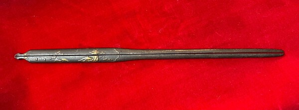

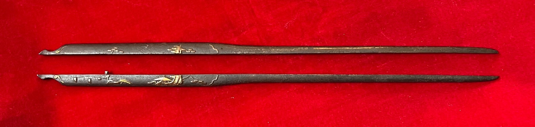

Ian Posted April 13, 2023 Report Posted April 13, 2023 I have made it a rule for myself never to think I have seen it all with Japanese art. Here is a pre Edo kogai recycled into a one piece kozuka/kogatana. The non decorative end seems to have been flattened down and made to look like a blade and it's surprising ridged and sharp, but can't imagine it cutting much! The ear wax remover has been taken off completely, I guess to have more of a kozuka look to it. I do wonder why this was all done, maybe sentimental to the owner at the time? We can all romanticise about the samurai going to battle ect, but the koshirae was like a Swiss army knife of the time, carrying the essential tools for grooming too!? 3 Quote
Bugyotsuji Posted April 13, 2023 Report Posted April 13, 2023 Mmmm… nice, kind of weird but I like it, Ian. Never say never indeed! Figuring out the rules, and then the acceptable exceptions! 3 Quote
