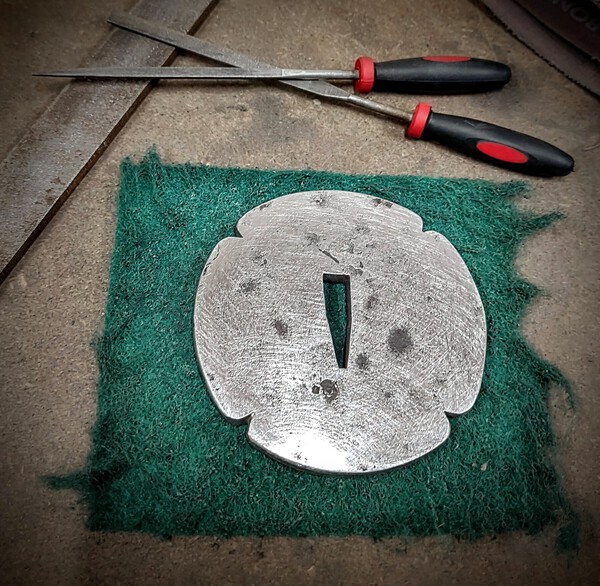

The tsuba is going to get at least one more hole in it. I'm also going to add a few silver overlay elements.
I guess I prefer the older (?) plain iron tsuba, to the more elaborate and highly decorated examples.
On the antique sword in my care, the tsuba is plain round iron, with one hole for a companion blade. It has very limited engraving, but is otherwise pretty utilitarian.

I understand, and I share your liking. Please let us see pictures as soon as your TSUBA is finished!

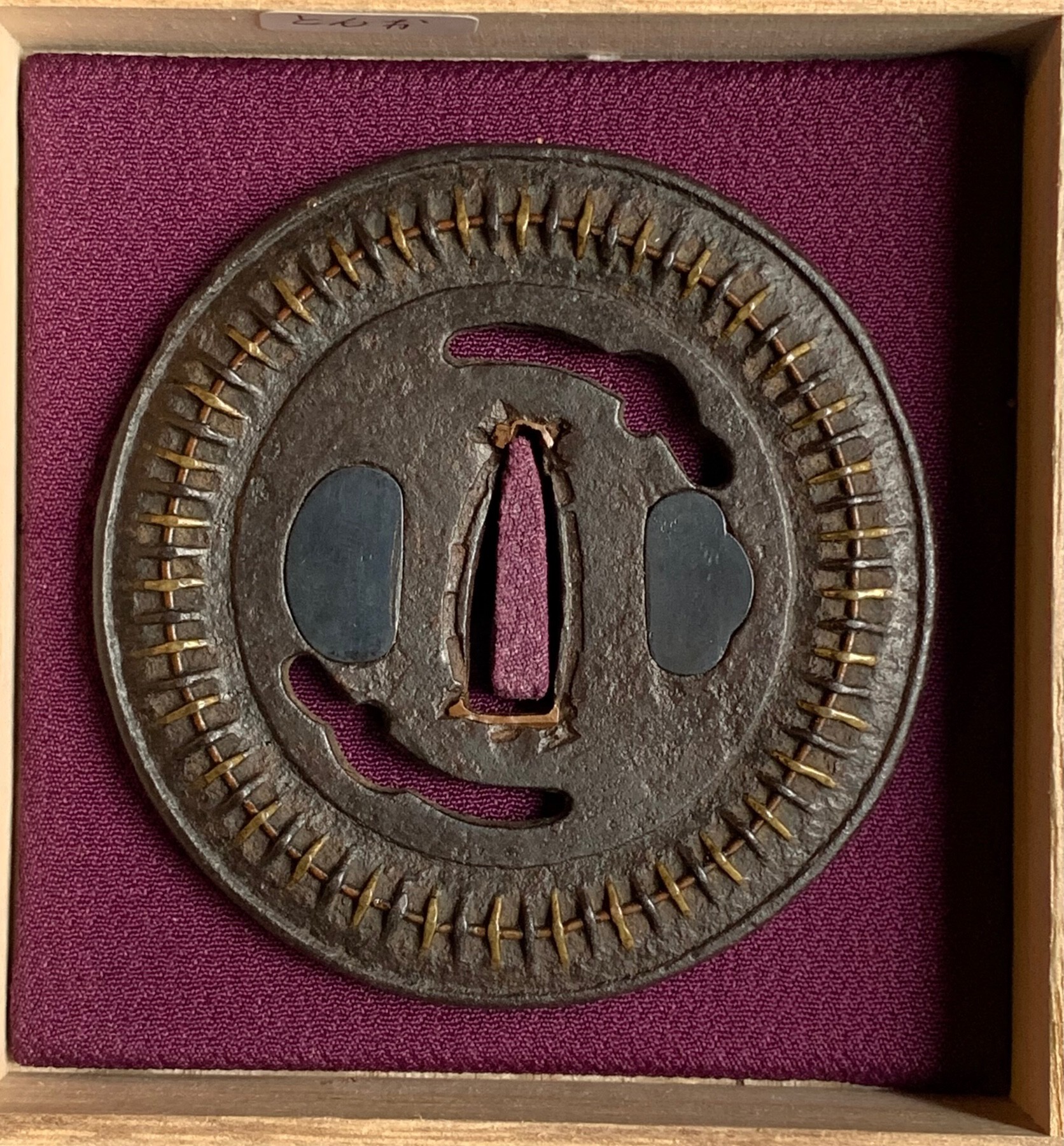

When you see a tsuba in a presentation box, as if the blade edge is upwards, the lobed kogai hitsu-ana hole (if there is one) is usually to the right of the triangular nakago hole.
