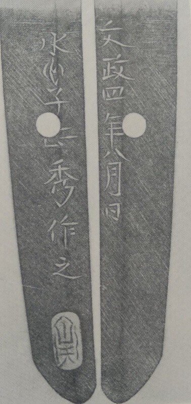

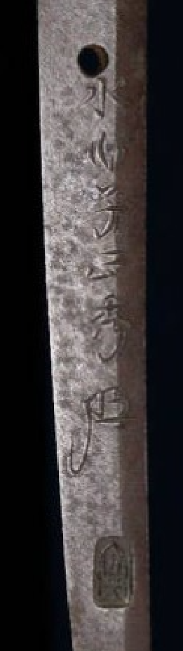

Mark Posted April 6, 2023 Report Posted April 6, 2023 Suishinshi Masahide smith from around 1800. very famous. you can find a lot online. compare the signatures you find. to my eye this looks gimei 1 Quote
Mike Z Posted April 6, 2023 Author Report Posted April 6, 2023 On 4/6/2023 at 1:08 AM, Mark said: Suishinshi Masahide smith from around 1800. very famous. you can find a lot online. compare the signatures you find. to my eye this looks gimei Expand Mark! Thank you so much! That is fascinating, and yes, with that information, I find various points of corroboration online. The signature in the following site for instance is a spot on match. https://markussesko.com/2014/02/24/the-tsunahiro-connection-of-suishinshi-masahide/ I had attempted to muddle through interpreting the date on the other side of the nakago, and thought that one possibility was 1804. But again, I have no idea what I'm doing, and didn't want to even mention my interpretation. My understanding is that gimei means an inauthentic signature. I'm attaching a few pics of the other side of the nakago, in the even that it may help with further identification. Again, any assistance in understanding this mei is greatly appreciated! Quote

Nobody Posted April 6, 2023 Report Posted April 6, 2023 應長尾權三郎元治需 – Responding to the order from Nagao Gonzaburo Motoharu 文化十五年二月日 – Bunka 15th year (1818), 2nd month 2 2 Quote

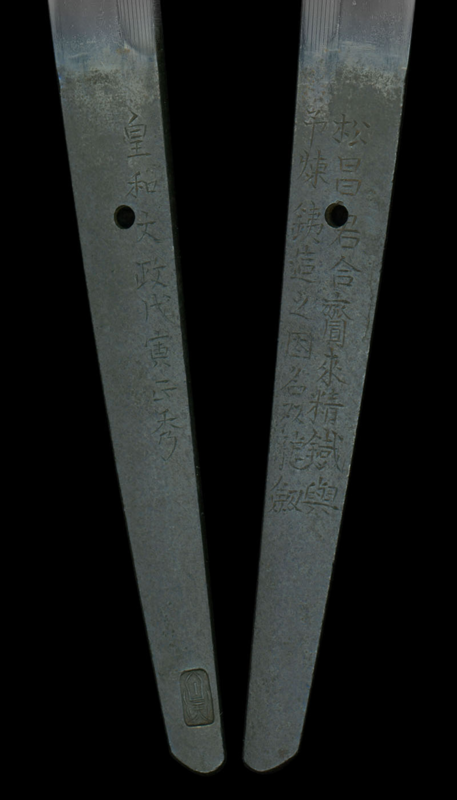

PNSSHOGUN Posted April 6, 2023 Report Posted April 6, 2023 Compare to a papered example from the same year: https://www.Japanese-sword-katana.jp/未分類/1810-1130.htm 1 Quote
Bruce Pennington Posted April 6, 2023 Report Posted April 6, 2023 In the "FWIW" category, I have other Masahide, including with the same kakihan, to compare. To my extremely untrained eye, they mei isn't that different. But, I'm often wrong about such things. 1 Quote
Mike Z Posted April 6, 2023 Author Report Posted April 6, 2023 Thank you John & Bruce! So my entirely uneducated opinion is that the signature on my sword is sort of "messy", and just not as precise as those authenticated as Suishinshi Masahide. I am also reading and learning more of the historical significance of this smith, the rarity of authenticated blades from this smith, and the prevalence of gimei bearing his signature. I think the prevailing opinion is that this is likely an inauthentic signature, correct? That said, can anyone enlighten me as to what that means in the context of the quality and likely age of the blade? All I can say for certain is that this sword was unaltered from the time it arrived in South Dakota in 1946. Does the fact that the omote is gimei mean that this still may be an older blade from a less historically significant smith? Or does this indicate that the ura date is also falsified, and this could be a mass-produced military blade? Again, my grandfather has passed, and these swords are treasures for my family, regardless. My inclination is to have them professionally polished and restored to the extent practical, regardless (I may have more questions on how to go about this in another thread!). But, knowing the difference between a blade from the 1800's vs one mass-produced in the 1940's will help inform what is a practical investment in restoration! Thanks all so much for an enjoyable night of learnings! Any further guidance is much appreciated! Quote
Brian Posted April 6, 2023 Report Posted April 6, 2023 Mike, the sword is definitely genuine, and likely made at that time or before. So even if the signature is gimei, you still have a decent antique and genuine sword. Swords like this should definitely get professional opinion, just on the chance that it is shoshin, it would be a significant find. Also bear in mind that gimei doesn't mean inferior quality. Lots of very good swords out there with false signatures. You may want to consider one of the US shinsas at some point later. You have done well to arrest the active rust. Oiling and wiping over time will help. Nothing abrasive of course. Looks like a decent sword, and I see nothing that places it in the wartime arsenal category. 2 1 Quote

ROKUJURO Posted April 6, 2023 Report Posted April 6, 2023 Mike, there seems to be scale on the NAKAGO and I can't see any YASURIME. This may point to one of the very many GIMEI blades of the famous MASAHIDE, but as Brian pointed out, it might still be a decent blade. 1 Quote
