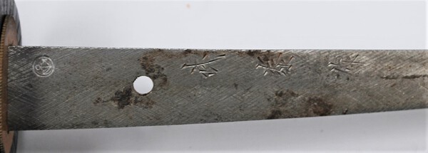

Kiipu Posted August 27, 2023 Report Posted August 27, 2023 On 4/4/2023 at 5:35 PM, Bruce Pennington said: Do you have more photos of this one? Expand For the rest of us, here you go. WWII Signed Japanese Navy Officer “Takayama Sword” Shin Gunto 1 Quote
Bruce Pennington Posted August 28, 2023 Report Posted August 28, 2023 On 8/27/2023 at 6:47 PM, Kiipu said: For the rest of us, here you go. Expand That's an interesting one. Note the filled second, original hole in the nakago: 1 Quote

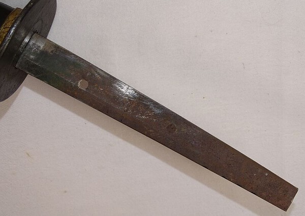

Bruce Pennington Posted August 28, 2023 Report Posted August 28, 2023 John, Here's an example of a wartime kaigunto make by Toyosuke. Posted by Don Sshlickman on this Gunboards Thread. We've seen a couple of these, if memory serves me, so I don't think the name was made up for the souvenir contract. Like you suggest, it could be an alternate name for another smith, but I doubt it was simply a souvenir fake name. 1 Quote
Kiipu Posted August 28, 2023 Report Posted August 28, 2023 On 8/28/2023 at 4:17 PM, Bruce Pennington said: Here's an example of a wartime kaigunto make by Toyosuke. Expand Takeyasu 武泰. I have yet to see a wartime made Toyosuke 豊佐. 1 1 Quote
Jcstroud Posted August 28, 2023 Author Report Posted August 28, 2023 Maybe we should ask @SteveMhis opinion on this kanji I dont know what to make of this one,seems quite different. Or @Kiipu. Quote
Jcstroud Posted August 28, 2023 Author Report Posted August 28, 2023 On 8/28/2023 at 5:05 PM, Kiipu said: Takeyasu 武泰. I have yet to see a wartime made Toyosuke 豊佐. Expand Notice the same crosshatch filepattern? Interesting comparison...T y s k? Quote
SteveM Posted August 28, 2023 Report Posted August 28, 2023 The one in Bruce's post is Takeyasu-saku (武泰作) 2 1 Quote
Bruce Pennington Posted August 29, 2023 Report Posted August 29, 2023 On 8/28/2023 at 5:05 PM, Kiipu said: Takeyasu 武泰. I have yet to see a wartime made Toyosuke 豊佐. Expand I need an emoji for “Dang!” Thanks guys, i’ll go correct myself over on gunboards. Quote

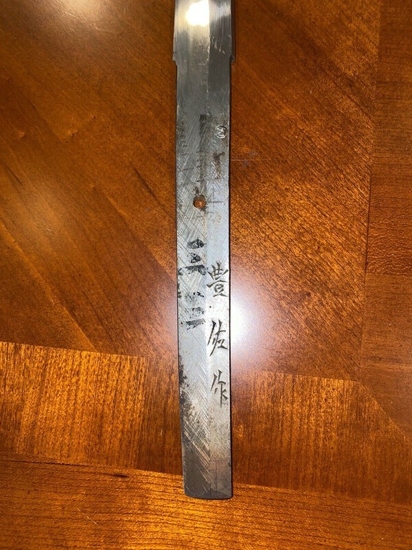

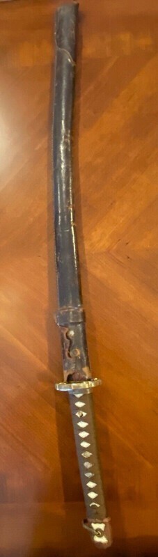

Jcstroud Posted August 29, 2023 Author Report Posted August 29, 2023 On 8/29/2023 at 1:25 AM, Bruce Pennington said: Takeyasu 武泰. I have yet to see a wartime made Toyosuke 豊佐. Expand There was a post by Mac the whopper that had a shingunto Toyosuke in combat saya #33 if my memory is correct I will search for It. Quote
Jcstroud Posted August 29, 2023 Author Report Posted August 29, 2023 Was wondering ? I think this is it. Quote
Bruce Pennington Posted August 29, 2023 Report Posted August 29, 2023 Yes, I'd forgotten I had that one on file. I have it in the souvenir chart, simply because I don't have a better place for it. 1 Quote

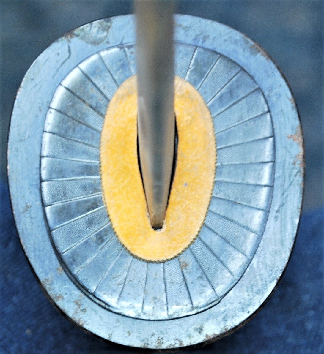

Jcstroud Posted August 29, 2023 Author Report Posted August 29, 2023 In retrospect I have my doubts about this one the mune machi appears back cut. 2 Quote
Bruce Pennington Posted August 29, 2023 Report Posted August 29, 2023 (edited) The ito and same’ look new, while the leather saya cover is quit weathered. It could be a souvenir blade that someone has piece together a scabbard and handle. On the other hand, it could have been a really weatherbeaten sword with a destroyed handle, and someone has had the tsuka re-wrapped. Edited August 29, 2023 by Bruce Pennington 1 Quote

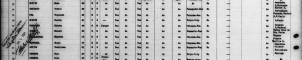

John C Posted September 10, 2023 Report Posted September 10, 2023 JC: I'm not sure this is your guy. The Toyosuke Oda posted above was in Brazil as of 1929 living with his family. He went back to Japan (via Los Angeles) in 1941 to stay with his uncle then back to Brazil by 1954, where he died in 2000. On his immigration records and passport he is listed as a farmer. I suppose he could have worked as a swordsmith at the end of the war if his uncle was one, but it seems unlikely. John C. Quote
