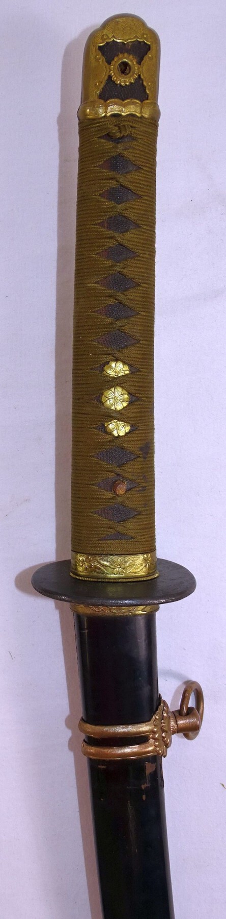

Jcstroud Posted April 1, 2023 Report Posted April 1, 2023 After a multitude of searches of Sword Smith lists and kai gunto and shin gunto blades I finally came up with a possibility that maybe.......in the 1943 gendai tosho ninki banzuke jyungenro I have found a swordsmith by the name of. TOMITA SUKEHIRO (TOKYO) Apon Viewing at least 6 of his swords along with a masahiro,a masanao all having the same mixed army navy souvenir fittings,same in black same snapped off kiri nakago near Identicle........I have been looking for years to solve the mystery .any help would be greatly appreciated. Due to the uniformity of construction I am thinking they all possibly worked together along with name association. Help! Quote

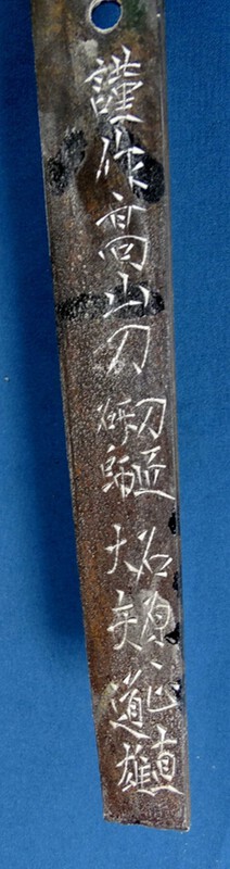

Jcstroud Posted April 2, 2023 Author Report Posted April 2, 2023 On 10/26/2021 at 1:40 PM, Bruce Pennington said: Wanted to post this one, found on THIS GUNS.RU THREAD. It has an undated blade with mei: Takayama To Masahiro made this; with small Toyokawa anchor. From the shadowing of the kasaki, it appears to have the fat tip of the Takayama styled blade. So the question is - did Masahiro continue to work for the Tenzoshan factory making blades for the souvenir operation, or was this a surplus blade? It is the first Takayama-to I've found in one of these. The growing variety of smiths and blades I'm finding in them seems to support the idea that at least some of the over 8,000 souvenirs they sold had surplus blades. Expand Quote
Jcstroud Posted April 2, 2023 Author Report Posted April 2, 2023 On 4/2/2023 at 12:51 AM, Jcstroud said: This is one of them.also Expand Quote
Jcstroud Posted April 2, 2023 Author Report Posted April 2, 2023 Please help me solve this.thank you Quote
SteveM Posted April 4, 2023 Report Posted April 4, 2023 No, that's Toyosuke. Your third post in this thread is a Takayama-tō (navy sword made at the Takayama forge). It has nothing to do with Toyosuke, as far as I know. There doesn't seem to be much in the way of documentation regarding Toyosuke. He just seems to be one of those smiths who left us a few swords, but left no records indicating anything about him personally. It happens from time to time. 2 1 Quote

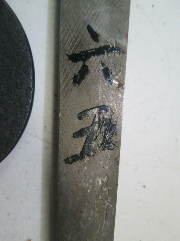

Jcstroud Posted April 9, 2023 Author Report Posted April 9, 2023 Thought I would post a few more photos of Toyosuke's other works for comparison..... Quote

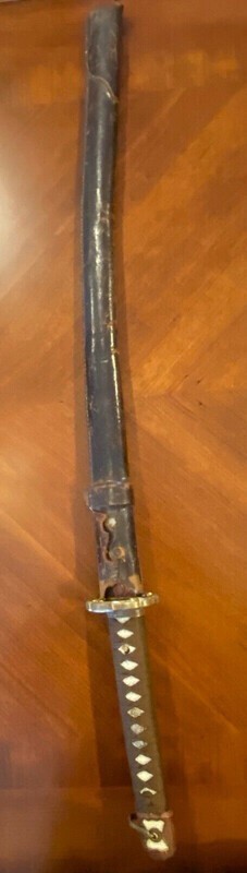

Bruce Pennington Posted April 10, 2023 Report Posted April 10, 2023 Thanks John. That makes 7 I have on file now. Painted numbers: 8 33 45 65 68 81 No paint No paint And an editorial note - is that Type 98 associated with these? Seems out of place. 1 Quote
John C Posted April 10, 2023 Report Posted April 10, 2023 On 4/10/2023 at 12:44 AM, Bruce Pennington said: Painted numbers Expand Bruce: The picture of the one on the wood table...is that number 33? John C. Quote
Jcstroud Posted April 10, 2023 Author Report Posted April 10, 2023 The type 98 was originally posted by Macthewhopper a Toyosuke made blade I borrowed from the NLF Discussion page 3 by Bruce .Oh and by the way thank you for your help Bruce ! Any one else have any to Toyosuke blade pics or info to share ? Quote

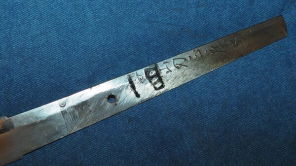

Bruce Pennington Posted April 10, 2023 Report Posted April 10, 2023 On 4/10/2023 at 12:52 AM, John C said: Bruce: The picture of the one on the wood table...is that number 33? John C. Expand Yes, at least, that's the way I see the number. Oops, I see I left that out of my post above. I've edited, and inserted it in the list. And that particular one, "33" in well-used Type 98 fittings, tells me that Toyosuke was working during the war. Which raises the question - Are the souvenir blades from him war surplus, or was he actively employed in the making of the souvenirs, or both? More questions on this: - The wartime Type 98 was numbered "33", yet we see souvenirs numbered earlier ("8") and later. How did this happen? Was the 33 blade grabbed randomly before war's end and used, while the others sat in a warehouse unused? Or was 33 refitted after the war by a collector? - I looked at all the nakago jiri I have photos of, and all but one have that same squared-off, but finished look. Not much evidence of the over-heated metal coloration. Number 81 is a Takayama-to with full inscription. And 65 has a traditionally shaped jiri. I think this slightly tips the scale toward these blades being surplus. 1 Quote

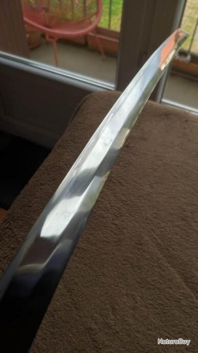

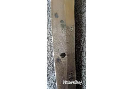

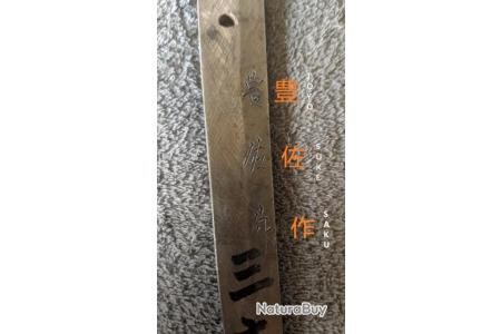

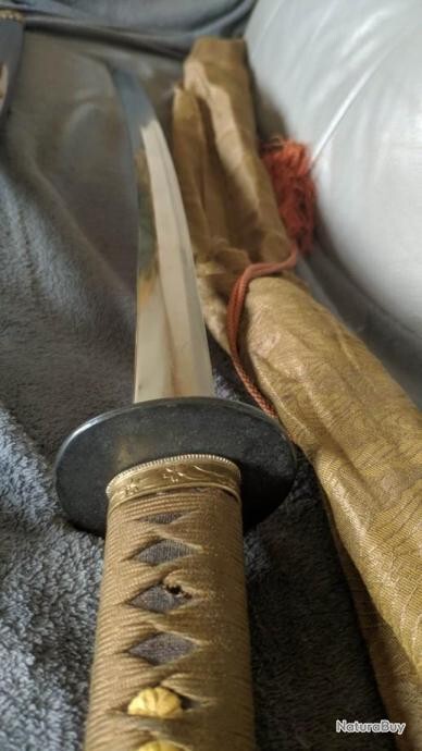

Jcstroud Posted April 13, 2023 Author Report Posted April 13, 2023 Found another on an auction in France named Naturabuy including the canvas bag and all for 1800 euros! 1 Quote
Jcstroud Posted April 14, 2023 Author Report Posted April 14, 2023 If you compare this one with the souvenir on page 1 of the NLF Post you will find a match !!!!. The bag ,tassle,mei ,this proves my sword is indeed a souvenir. !!! Sold at the px either in Tokyo or possibly Korea. Which tends to indicate Toyosuke likely worked for the Tenshozan Tanrenjo after the wars end. Maybe unless the blades were surplus from Toyokawa ??? Quote
Bruce Pennington Posted April 14, 2023 Report Posted April 14, 2023 Yes, very good verification of the very first one with bag and certificate. Any chance they show a full picture of the nakago, or at least a shot of the jiri (end)? 1 Quote
Jcstroud Posted April 21, 2023 Author Report Posted April 21, 2023 Latest update on the search for Toyosuke: in the Gendai Toko Meikan:Tomito Shotaro is his real name his art name is. Tokyo Sukehiro TenKaishi from page 78.in the ohmura study his ranking is jojo saku and received special honors mention. In 1945. He was a student under Horii Taneyoshi at the Tokyo Hanazawa Tanrenjo during the period of 1912-1926.it is an assumption of mine that this was Toyosuke because no other meets all the criteria. If I were making swords for the enemy I too would change my name. No shame in this. He was also titled Black Sword Master" ! Quote

Jcstroud Posted April 22, 2023 Author Report Posted April 22, 2023 On 4/22/2023 at 3:14 PM, Bruce Pennington said: John, Not disagreeing, but could you fill us in on your reasons for this assumption? How did you zero in on Sukehiro/Shotaro? Expand After comparing the yasurime of Toyosuke which is higake or crosshatched to Tomito sukehiro,s which is kesho yasurime I am not so convinced now that they were the same person. Not to mention the kiri cut nakago versus the kuri-jiri nakago .The main reason if you call it that is that you search for the nearest possible text string match, and then compare nakago info to verify.I have searched 7 years and every swordsmith list I can find and still nothing concrete. Due to the common practice of some to use different names you have to rule out the possibilities. E.g. To. First2 letters second yo last 2 letters mid. Suke..... closest I could find . Oh well back to the drawing board........ 1 Quote
