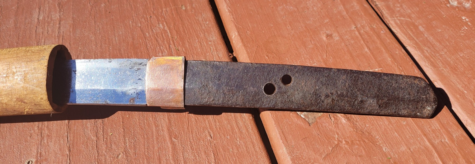

RunaTuna Posted April 1, 2023 Report Posted April 1, 2023 Hello, I recently won an auction for two Japanese swords. One is a kyu guntō the authenticity of which I have already verified. However this 2nd sword I am not able to find any information on, as it has no markings on it. I only bid the value of the kyu-gunto, so this one was just a bit of a bonus. I normally collect milsurp firearms, bayonets, and other militaria, so I was hoping this might be a shin guntō. I had someone tell me it has Muromachi era patina and that the shape is characteristic of Bizen (kurijiri nakago) which was one of two major sword producing sites in the civil war. But honestly that sounds too good to be true. Was hoping to get some more opinions. Also, the hilt is missing so any ideas of how I would replace it in the even it IS authentic would also be appreciated. Quote
Fuuten Posted April 2, 2023 Report Posted April 2, 2023 Welcome, From the picture here it is hard to say anything except, I'm leaning towards real though quite the abuse victim. To me it looks a little like suriage - shortened from sugata or overall shape. But the nagako doesn't look like it, more Edo period. Better photos and close up on the handle and kissaki - tip of the sword, dimensions etc, are necessary. Others will chime in shortly. Also, please sign with atleast your first name👍 Quote
RunaTuna Posted April 2, 2023 Author Report Posted April 2, 2023 15 minutes ago, Fuuten said: Welcome, From the picture here it is hard to say anything except, I'm leaning towards real though quite the abuse victim. To me it looks a little like suriage - shortened from sugata or overall shape. But the nagako doesn't look like it, more Edo period. Better photos and close up on the handle and kissaki - tip of the sword, dimensions etc, are necessary. Others will chime in shortly. Also, please sign with atleast your first name👍 Sorry about that. Here is some more pics to the best of my ability. The blade is about 20.5 inches (52 cm) long. I guess I just want to make sure it's not some mall ninja junk haha. If it is any sort of real Japanese antique I will be happy. Quote
Fuuten Posted April 2, 2023 Report Posted April 2, 2023 Hello Alec, Sadly it looks less like a real Japanese swords from the new photos (to me anyway). Starting with the undefined shape, the lack of a well defined shinogi - ridge line, destroyed point to the habaki and weird looking rust on the tang. I'm afraid it looks like a fake. However since you only valued the lot on the other piece I suppose you didn't lose anything. 3 Quote
RunaTuna Posted April 2, 2023 Author Report Posted April 2, 2023 46 minutes ago, Fuuten said: Hello Alec, Sadly it looks less like a real Japanese swords from the new photos (to me anyway). Starting with the undefined shape, the lack of a well defined shinogi - ridge line, destroyed point to the habaki and weird looking rust on the tang. I'm afraid it looks like a fake. However since you only valued the lot on the other piece I suppose you didn't lose anything. Ah, that sucks. Thanks for the help. At least I still have my other Japanese blades. Quote
Grey Doffin Posted April 2, 2023 Report Posted April 2, 2023 Hi Alec, For what it's worth, I think this is a real Nihonto that has seen abuse. The kissaki has been reshaped, most likely because the tip was broken. The nakago does look Bizen so late Muromachi Bizen may be right. Grey 1 1 Quote
Matsunoki Posted April 2, 2023 Report Posted April 2, 2023 This isn’t a fake! It’s had a hard life but it’s old and genuine. From these images it’s ubu at the nakago end…..not sure about the kissaki end. 2 Quote
RunaTuna Posted April 2, 2023 Author Report Posted April 2, 2023 15 hours ago, Grey Doffin said: Hi Alec, For what it's worth, I think this is a real Nihonto that has seen abuse. The kissaki has been reshaped, most likely because the tip was broken. The nakago does look Bizen so late Muromachi Bizen may be right. Grey 11 hours ago, Matsunoki said: This isn’t a fake! It’s had a hard life but it’s old and genuine. From these images it’s ubu at the nakago end…..not sure about the kissaki end. Well hot diggity dog, that's really cool! Now to find someone who can restore it. I'm not giving it to Bubba the amateur blacksmith, I need someone who knows what they're doing. 1 Quote

Fuuten Posted April 8, 2023 Report Posted April 8, 2023 (edited) On 4/2/2023 at 2:50 AM, Fuuten said: Sadly it looks less like a real Japanese swords from the new photos (to me anyway). Disclaimer. I could, should've prefaced it by saying I'd probably be wrong. For the record: absolutely fallible 😄 Edited April 10, 2023 by Fuuten Awkward choice of words 1 Quote
RunaTuna Posted April 10, 2023 Author Report Posted April 10, 2023 So, I reached out to David Hofhine about getting the blade restored. He confirmed the sword's authenticity. He guessed Koto period (pre-1600). He said however, his services to restore it would cost more than the blade is actually worth. He said it's about a 500$ sword and he charges 70$ per inch of blade for his cheapest polish. He does not recommend other people's work (of course not, he doesn't want to lose business). And that doesn't even take into account what it will cost to replace the hilt and sheath. So I'm kind of back to square one. Surely there must be someone who is in the middle between "Expensive 30+ years experience sword master" and "Bubba the cheap amateur blacksmith". Quote
