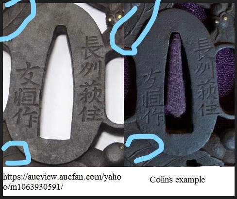

Ford Hallam Posted April 3, 2023 Report Posted April 3, 2023 and yet another one, with the same mei. also perfectly genuine piece imo. https://aucview.aucfan.com/yahoo/m1063930591/ 2 1 Quote

Spartancrest Posted April 3, 2023 Report Posted April 3, 2023 On 4/3/2023 at 11:09 AM, Ford Hallam said: and yet another one, with the same mei. also perfectly genuine piece imo. Expand I think you missed this part of the description [Current condition product!]. That is: made recently. Never been near a sword blade. Directly comparing the signatures the position of every character is in the same spot - Now I know the Japanese can be very precise but this is not within the realm of belief. 2 Quote

rematron Posted April 3, 2023 Report Posted April 3, 2023 On 4/3/2023 at 1:56 PM, Spartancrest said: I think you missed this part of the description [Current condition product!]. That is: made recently. Never been near a sword blade. Directly comparing the signatures the position of every character is in the same spot - Now I know the Japanese can be very precise but this is not within the realm of belief. Expand @Ford Hallam , I'm trying to learn and this debate is dizzying. Thank you for your expert opnion. I would please like this above to be addressed. These are exactly the same and the skill required to do that is INSANE. Right? If there were hand carved, basically exact replicas being produced, I feel like they would be very very expensive and sought after for the skill required to do that. I'm also missing where it was claimed that these particular tsuba were cast in the Edo period. Why not after, as souvenir pieces? I have no chips in the whole "Edo period tsuba casting" debate. I just want clear understanding of what is what and why. So, what is the explanation for identical tsuba being produced if not cast, regardless of time peiod? 1 Quote
Matsunoki Posted April 3, 2023 Author Report Posted April 3, 2023 On 4/3/2023 at 4:55 PM, rematron said: These are exactly the same Expand Hi Jeremy I think the Mei are at first glance identical but when look they appear to me to be cut differently with many minor variations. One cut thickly, the other less so etc …..or maybe it’s my old eyes Quote

rematron Posted April 3, 2023 Report Posted April 3, 2023 On 4/3/2023 at 5:03 PM, Matsunoki said: Hi Jeremy I think the Mei are at first glance identical but when look they appear to me to be cut differently with many minor variations. One cut thickly, the other less so etc …..or maybe it’s my old eyes Expand It's not just the mei. It's the positioning of every item on the whole piece. Every contour of the berries. Every vein on the leaves. Quote
rematron Posted April 3, 2023 Report Posted April 3, 2023 I just noticed that, while these objects occupy identical spaces and have identical curves, one is convex while the other is concave. Quote
