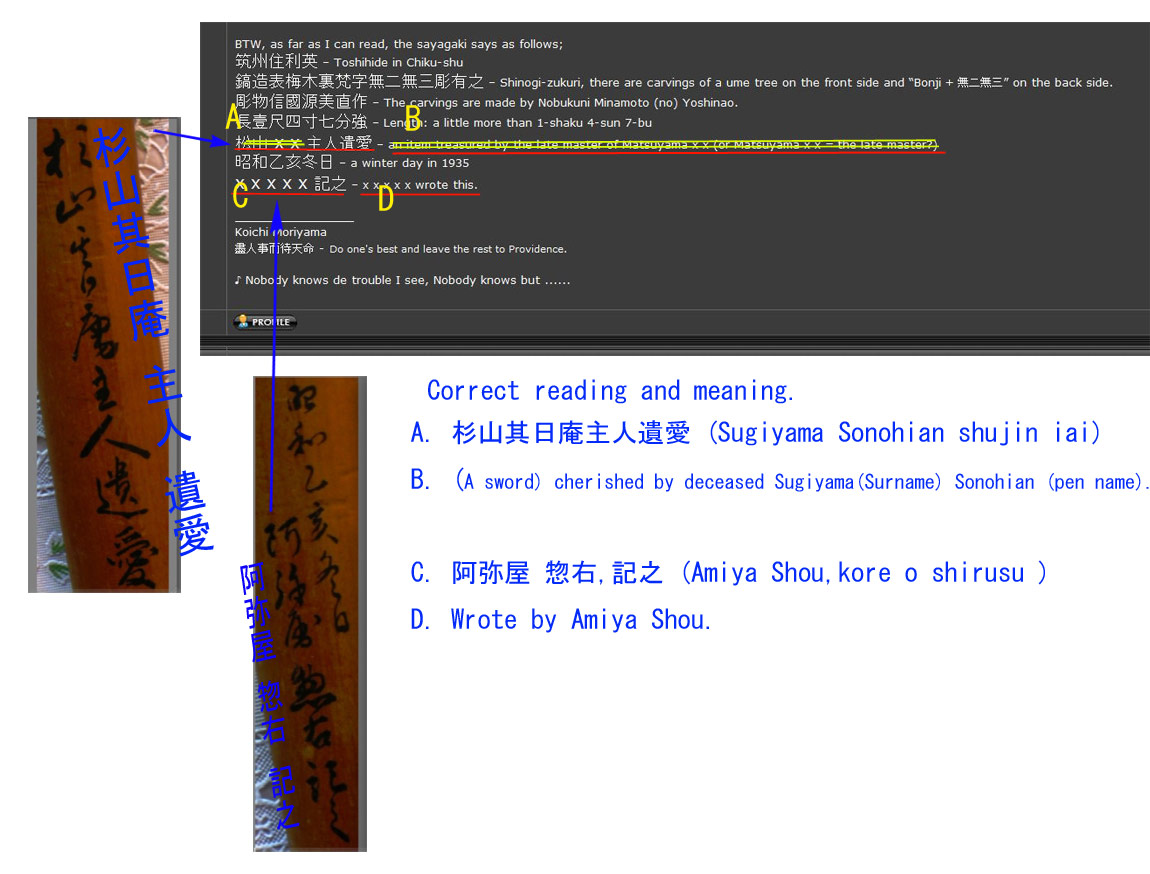

I can read this Sosho Sayagaki that Mr,Moriyama(Nobody) were not able to read partially at (XXXXXXXXX) .
It is two parson's names (artname).
P/S " Itakura Katsusuke" is not relatd this sayagaki and sword.
I woud saying is former owner of this sword that writing name on the sayagaki.

Charlie,
Correct readig and meaning as follows.
However, I don't know the Sayagaki is genuine or not.(Sorry ,Charlie)
A. 杉山其日庵主人遺愛, (Sugiyama Sonohian, shujin, iai ).
B. (The sword) cherished by Sugiyama Sonohian.
Real name of 杉山其日庵 (Sugiyama Sonohian) is Sugiyama Shigemaru (杉山 茂丸,1864- July,1935).
(In Japanese) http://ja.wikipedia.org/wiki/%E6%9D%89% ... 2%E4%B8%B8
C. 阿弥屋惣右記之,(Amiya Shou, kore o shirusu.)
D. Wrote by Amiya Shou.
Real name of Amiya Shou (阿弥屋 惣右) is Amiya Souemon (阿弥屋 惣右衛門).
Maybe connoisseur of swords etc,.
