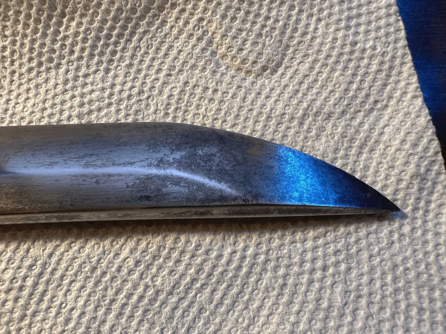

This morning I recently received a mumei wakizashi that I got fairly cheaply online. (Photos attached below)
The seller was very knowledgeable  and told me that this piece was from Edo Period. I would really like to know any other information that anyone can tell me about the piece since I am very new to the hobby. I'd like to be a good custodian for the sword so I'm also very open to any information on how to possibly receive a shirasaya for the piece? If I've said anything wrong or if any additional photos are required please feel free to correct me.

Hi CG,
Welcome to NMB and to Japanese swords. :thumbsup:
Unfortunately it's hard to tell very much from the pictures - I'd agree that the sword is Edo period, it might be early Edo period around the Keicho period (1596 - 1615) as, what looks like, a larger tip would point in that direction (these blades were modelled on the shape seen in the Nambokucho period) though this is also a trait seen in shinshinto blades (1764 and later) when there was a second revivalist movement that favoured the same shape.
The patina on the tang is quite a dark colour and that might indicate early Edo period but wouldn't be conclusive as environmental factors can prematurely age the tang.
If you can try to get some detail shots of any activity in the tip, near the hardened edge and any activity of the folded steel then you might get a better pointer towards its age and where it was manufactured but I think it might be hard to be more exact given the spider rust and that it looks as though someone as taken an abrasive to it.
Anyway, congratulations on owning your first Japanese sword and I hope that it's the first of many.

Wow John,
Thank you very much that is a lot of very helpful information! I was worried that someone had taken an abrasive to it due to some scuff marks throughout the blade so it's also very helpful to hear that you see it too. If I get some more time after work I'll see if I can get some more detailed photos of the tip. Thank you so much!
