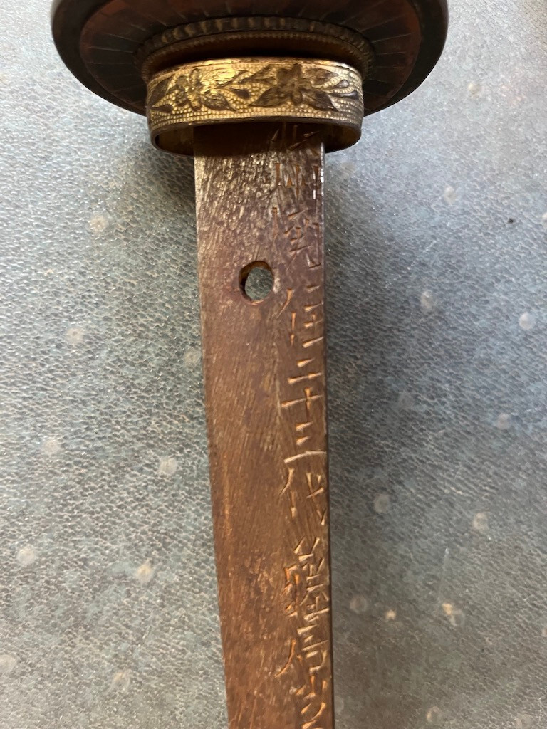

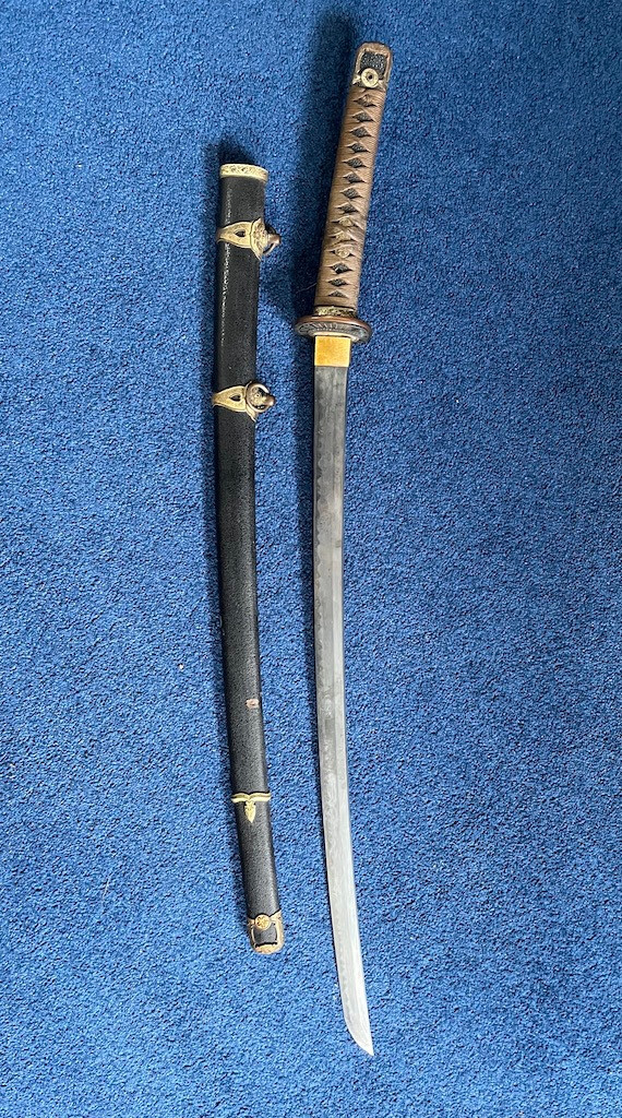

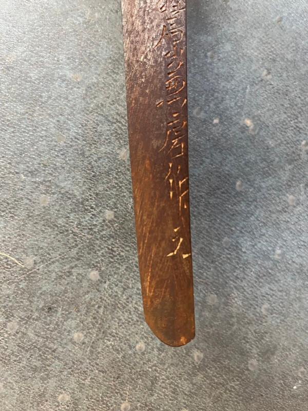

Den1884 Posted March 23, 2023 Report Posted March 23, 2023 Hello, I have a type 97 Kai-Gunto recieved by an English Captain at the surrender of Singapore ( full provenance ) - could someone help us with the markings on the tang? Quote
xiayang Posted March 23, 2023 Report Posted March 23, 2023 濃州関住二十三代藤原兼房作之 = Nōshū Seki-jū nijūsan-dai Fujiwara Kanefusa saku kore (Kanefusa the 23rd, resident of Seki in Nōshū province, made this) Mal's file has more information about this smith: 2 Quote

Bruce Pennington Posted March 23, 2023 Report Posted March 23, 2023 Production/assembly numbers "687". Some Kanefusa blades have a small stamp above the mei. You would have to remove the tsuba/seppa set. Anything there? Quote
Stephen Posted March 23, 2023 Report Posted March 23, 2023 Im dealing with eye conditions. The area to the top left Looks like circular area that may have been pinned? Or is it just my blurry eyes. Quote
Bruce Pennington Posted March 23, 2023 Report Posted March 23, 2023 I see what you mean, Stephen, but I can’t make out what it might have been. Normally the stamps I am looking for are higher on the nakago. 1 Quote
