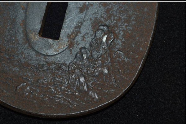

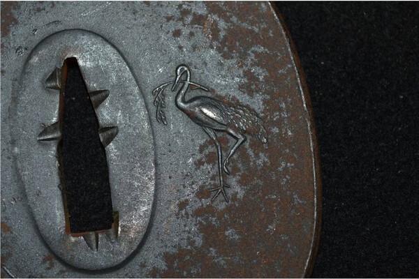

GoldenDrachen Posted March 17, 2023 Report Posted March 17, 2023 Hello gentlemen! This is me again. Looking for an urgent advice. (auction ends in 2 hours) I have spotted this tsuba as a part of tachi koshirae, all in poor condition, but anyway I might go for it. This tsuba, I think, is interesting. (or not? What do you think) Can this rust be removed? Thank you in advance Vitaly Quote
vajo Posted March 17, 2023 Report Posted March 17, 2023 Looks like a fake tsuba for me. Zinc alloy. 2 Quote
Infinite_Wisdumb Posted March 17, 2023 Report Posted March 17, 2023 Agree with @vajo it’s garbage 1 Quote
GoldenDrachen Posted March 17, 2023 Author Report Posted March 17, 2023 @vajo and @Infinite_Wisdumb thank you so much! I am glad that I have asked! Regards Vitaly 1 Quote
Spartancrest Posted March 17, 2023 Report Posted March 17, 2023 These were made for "practice swords" sometime between 1950 onwards. Usually in steel, hence the rust, some have been switched out from their original mounts and some altered like the one in the top post. Tagane-ato [punch marks] are there to make them appear used and older. Curiously these "reproductions" are based on a very fine master work by Goto Hokyo Ichijo (1791 - 1876) who may have stolen [borrowed?] the image by Utagawa Kunisada "Dawn at Futami-ga-ura" near Ise and the self same "reproductions" were copied by both Japanese and Chinese forgers and casters. How do I know this? Because it is in my first book! And I have an altered one with an inlay of a silver moon and a hitsu cut through the plate. 9 3 Quote
