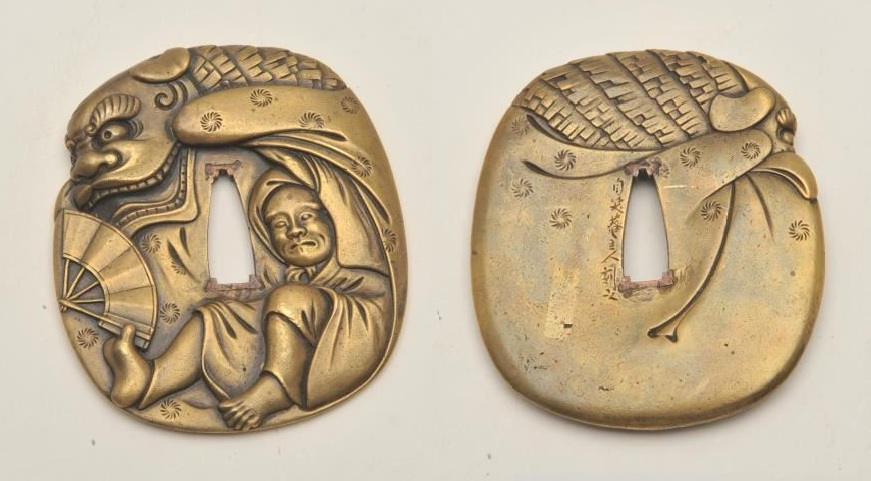

New fake "lion dance tsuba" in high relief with mei - beware
Here's one that made me raise an eyebrow yesterday, then sure enough, spotted another one today... latest modern casting that will catch some people unaware.
If you want one, fine, just know that it is a modern casting made yesterday, so pay accordingly.
This one quickly got bid up to 18,500yen on its first day of being listed on YahooJ.
The one I saw yesterday had a black finish with gold highlights, so it comes in a variety of finishes.
If you look closely at the images, there's lots of signs that it is cast (air bubbles and surface irregularities).

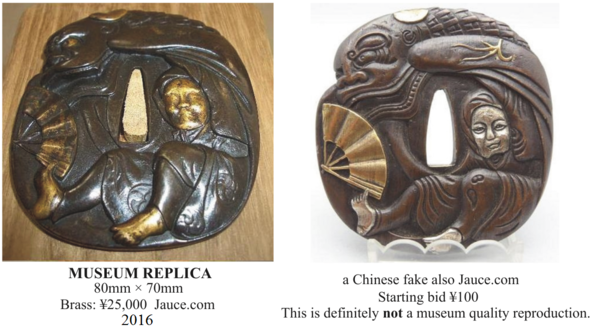

These 'new' ones look the part but fakes have been coming for some time - some better some - - well YUCK!
Plenty of museum replicas some have been around for more than ten years! [looks like the price has gone down since 2016] Still way over-priced!
I would say watch out for the bare toes - the tabi covered feet might be OK?
https://www.jauce.com/auction/n1040153013 [Released on April 25, 2020]
https://www.jauce.com/auction/x1040316574  [Released on October 6, 2021]
https://www.jauce.com/auction/u1040316915  [Released on October 9, 2021]
https://www.jauce.com/auction/m1040159784  [Released on April 25, 2020]
https://www.jauce.com/auction/c805965121  [Listed on April 28, 2012]

I figure most people will recognized the overly colored ones, and stay away, but I thought I'd share the iron one I posted because the iron patina looks pretty convincing and is sure to fool a lot of people.

Price for that 'replica' is still going through the roof - over 20,500 yen and won't stop for a while yet!
https://www.jauce.com/auction/v1084809565
When scrolling along not far away from it, I found these two -
https://www.jauce.com/auction/m289427759
https://www.jauce.com/auction/m1001338054
with a guard between them - now can anyone see why one is 50,000 yen  and the other is 8,000 yen? [that is just the starting price] - when both are cast!
It might help if the images are turned up the same way.
This is a case of "don't advertise a fake next to another fake"
Oh and don't get me started on this one - AGAIN!  https://www.jauce.com/auction/l1071343193
